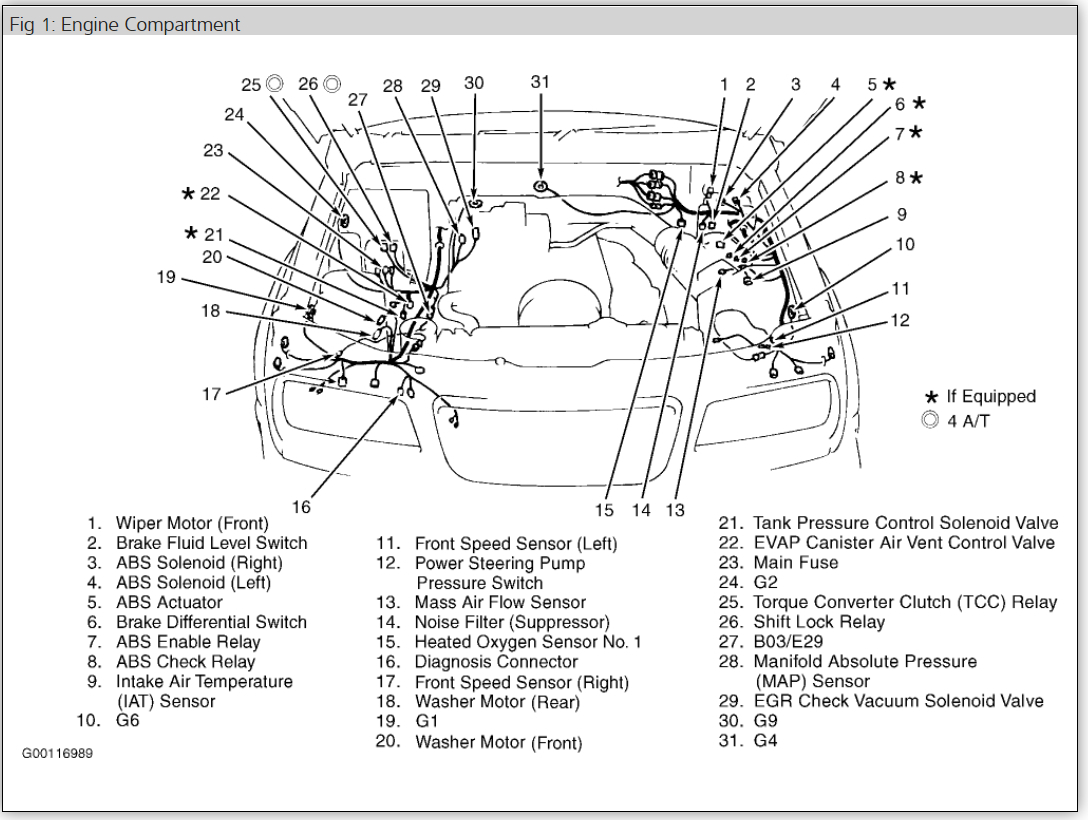

Engine is running when shift to reverse and drive not functioning. what seems to be the problem? Thanks.
Jan 7, 2018 at 3:27 PM
  • 55,423 POSTS
It sounds like you have a torque converter that is locked up not allowing the engine to freewheel. Or the torque converter control relay is shorted out or broken. Not allowing the converter to disengage. I would pull out the relay and try and start the car to see what happens.
