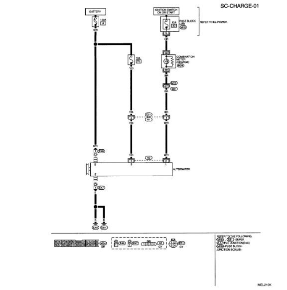

Changed tension pulley and belt. It starts up without lights runs, then driving all lights come on an cuts off and battery dead. Please help me figure this out.
Dec 1, 2018 at 10:16 AM
Good afternoon,
Do you have a volt meter to check the voltage at the battery with the engine running?
The charge rate needs to be 14 to 14.5 volts. The battery voltage with the key off should be 12.6 volts.
Is the battery light on?
Dec 1, 2018 at 10:29 AM
PENNY JOHNSON
  • 7 POSTS
Battery light and brake light is on. I have no tester.
Dec 1, 2018 at 10:37 AM
Okay, that tells me you have a charging system failure.
You can get a cheap voltmeter at a parts store to do the checks.
Also, check the fuses. it may have a failed fuse. If it does, the alternator may be the cause of the failure.
Dec 1, 2018 at 10:43 AM
PENNY JOHNSON
  • 7 POSTS
So just go ahead and change the alternator?
Dec 1, 2018 at 10:49 AM
I would confirm it first to be sure it is not anything else.
It is most likely the issue but I do not guess. I like to diagnose once and repair once. guessing is expensive if it is the wrong part.

Tell him to verify power to the back of the alternator from the battery.
Have him check all the fuses with a test light for power on both sides.

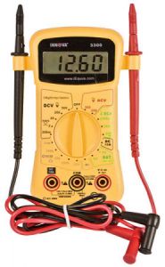

Tracing current drain is very PITA. You are at the right direction though. Here is what I would if I were you on a day that you are off from work. Get yourself a DVOM )digital volt/ohm meter).
https://images.2carpros.com/forum/automotive_pictures/55316_3300_1.jpg
It is about $15 from you local parts store or even Walmart... 1. Set it to check voltage at DCV V20 (checking DC voltage at around 20 volts). 2. Remove both battery terminals. Check battery voltage without any current draw. Write in a piece of paper. Now you have your base voltage. For example: Battery - no load - 12.65 volts 3. Attach both battery terminals. Check and write down voltage. Battery with terminals attached - 12.48 volts. Subtract this number from your base: 12.65 - 12.48 = 0.17 volts. Now you know, you have 0.17 volts of parasitic current draw. 4. Now, under the hood, you should have (if I remember right) 3 different fuse/relay boxes. Pull a fuse/relay one at a time. Write down what fuse or relay you pull, and check the voltage. Do this until you have tested every circuitry under the hood. If there is no change in the voltage, continue to the fuse box under the dash, left side. 5. You will find one fuse or relay that will give your battery voltage higher than 12.48 volts. Usually a fuse controls one or more circuits. At least now you can concentrate your energy on that particular circuit. Good luck....
