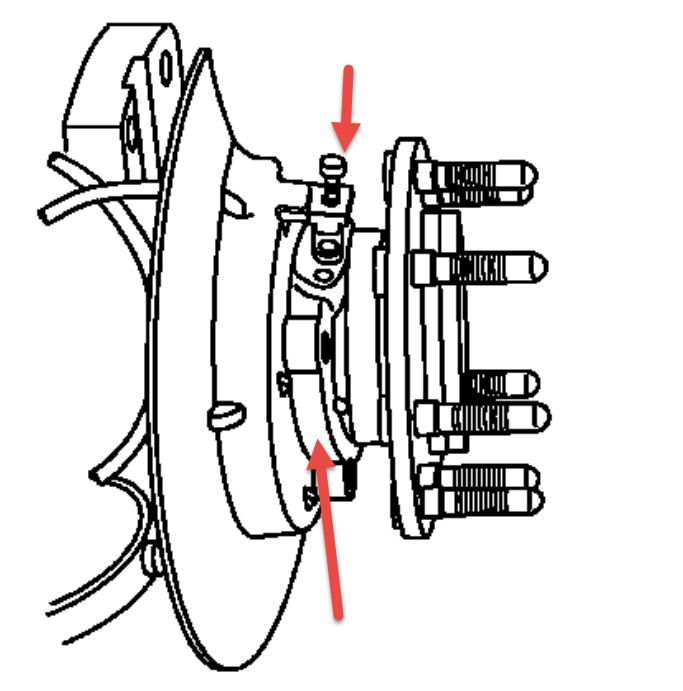

Twice in 6 weeks, I had to panic stop, both times the rear wheels locked up.I do not have a check brake or engine light, a local ase repair shop today looked at, managed to get the front brakes to lock up, but could not determine a cause or course of action. They found no codes or trouble lights. The brakes seem to me to be not as strong as 2011 when purchased.I have had to replace ALL of the steel brake lines due to rust, late last year. All brake linings and rotors are like new. When you try to push the brake pedal to the floor, it will not. You do not seem to gain anything if you pump the brakes. At this point my best guess would be to replace the master cylinder and power booster. Any ideas or possible solutions? Any feedback will be greatly appreciated. Thanks Bill.
Monday, February 22nd, 2021 AT 11:52 AM (Merged)
HMAC300
  • 48,601 POSTS
Check rear brakes for grease/oil on discs if it has it fix the leaks probably the axle seals. Then try a brake bleed with a scanner as he can open all the valves on the abs unit. Also look at speed sensors to see if they have rust on them at the ends as they are magnetic if they do clean it off. They may not be sending a signal to abs unit. Make sure that sensor wheel is ok as well when you spin the wheel. In pic one arrow points to sensor ring on wheel and other to speed sensor bolt. Be careful with sensor as wires are very thin and can break easily.
