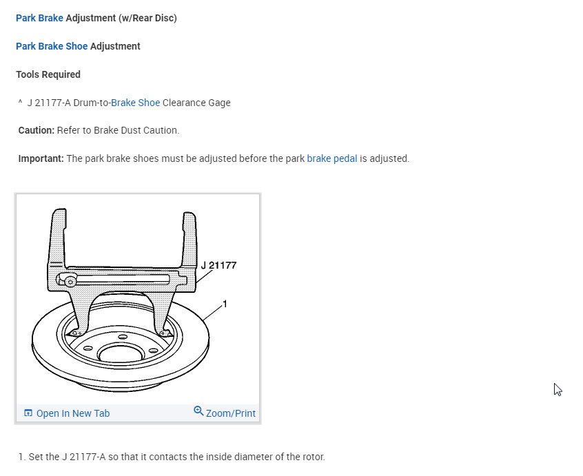

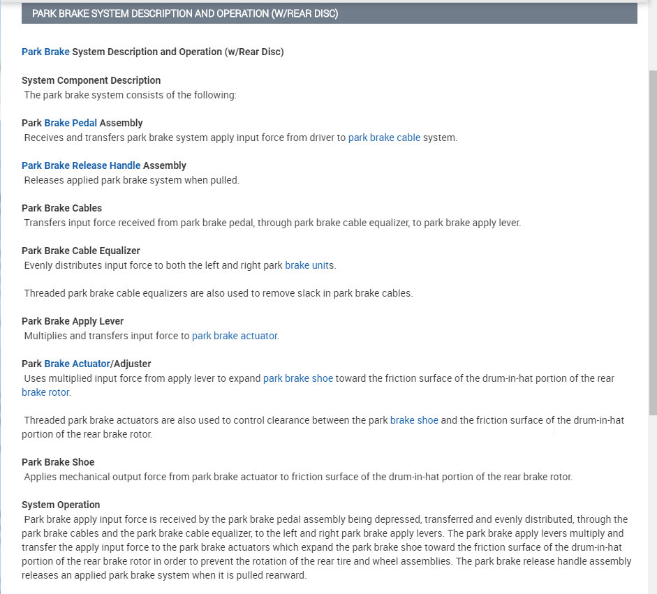

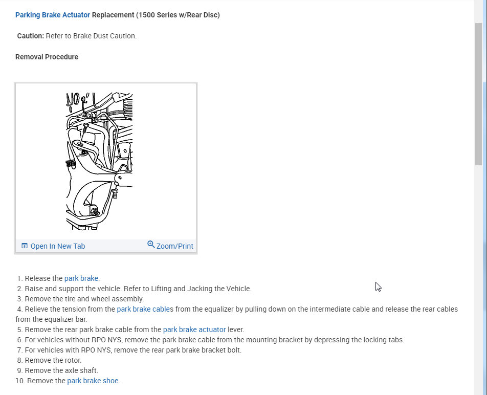

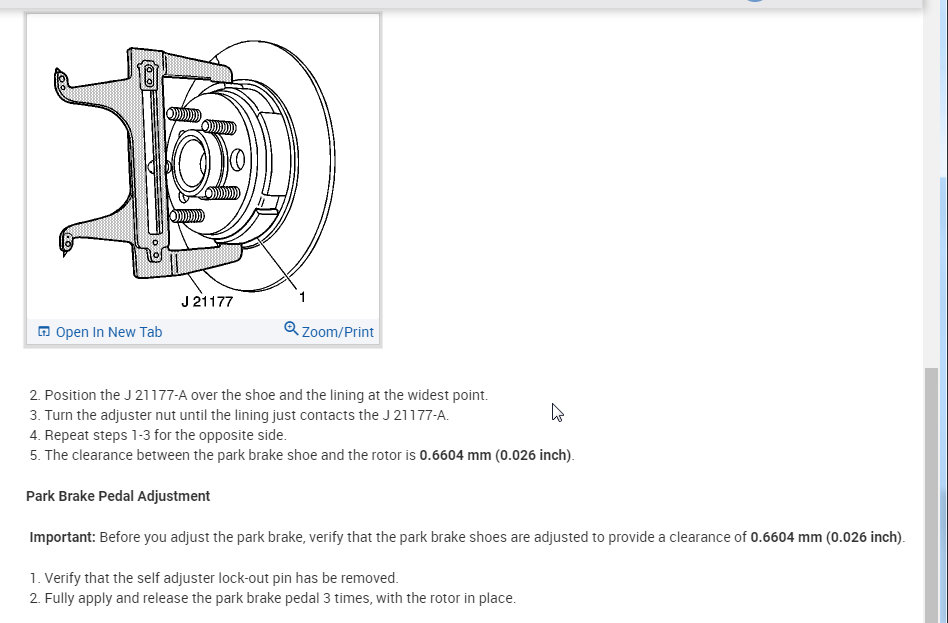

I am going to assume you have rear disc brakes just because if you have rear drum then the parking brake is part of the rear shoes. However, if you have rear disc brakes then the parking brakes are inside the rotor. A lot of times these get hung up and will start dragging and making noise once they are worn out. I would suggest pulling the rotor off and looking at the parking brakes to see if that is the issue.

Okay. That makes checking this easier to check. Lift the rear of the vehicle and put the transmission in Neutral (block the wheels so it doesn't roll) and spin the rear tires. With no parking brake and in neutral, they should spin pretty easily with very little drag from the brakes. If they do then you have a different issue. If not, then we need to remove the drum and take a look.

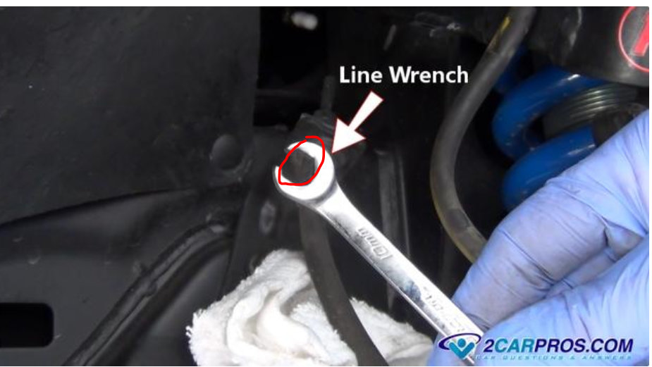

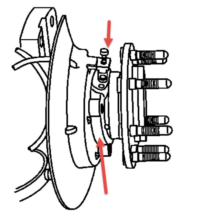

Has any work been done to the front brakes recently? What I need you to try is this. Safely lift the front of the vehicle so you can turn the tires by hand. I realize you may not be able to at first.
Once it is off, have a helper press the brake pedal so the front wheels lock up. Then, open the bleeder valve on the brake caliper to see if the wheel turns. If it does, close the bleeder and replace the rubber brake hose. If it doesn't release with the bleeder open, either the caliper piston is frozen or the caliper slides are frozen.
Do this and let me know the results. Once you tell me, I will provide you with what needs done next.
I attached a picture below if where to find and what the bleeder looks like. Be careful when loosening it because if it breaks, you will need to replace the entire caliper.
Let me know what you find.
