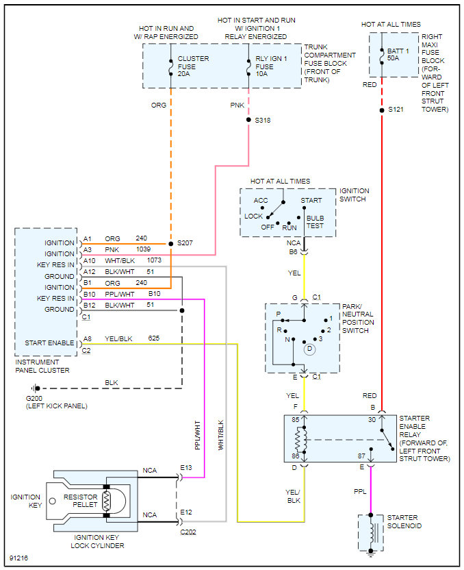

Anti Theft problem, engine will not start
1997 CADILLAC DEVILLE
1,628,750 MILES • 4.6L • V8
BUZZERD
Engine will not start.
Jan 14, 2021 at 10:27 AM
More than likely this is due to the resistor in the key has failed and it not deactivating the system.
When you insert a key in the ignition, it needs to have the proper sized resistor on it so that it changes the voltage that is passed through the key to the proper level so that cluster recognizes it as the correct key. Then it allows the start of the vehicle.
Take a look at the is wiring diagram below which will show how this works.
Let us know what you have done so far and we can walk through this if the key is not the issue. Thanks
