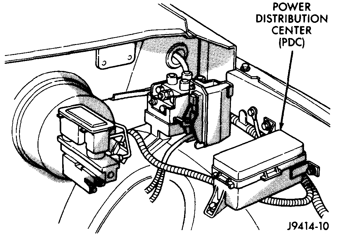

Did you check fuel pressure when it won't start? Does it lose spark when it won't start? Have you tried switching the ASD relay with a different one when it won't start? It is located in the under hood power distribution box. See pic below.

I'm not sure about the spark but the fuel pressure stays the same around 50. I have changed ASD relay. As long as I fight with it to start it at first and then let it sit for 20 minutes it turns on and good after that I made the joke to my buddy earlier. She just doesn't like to be woke up so after I wake her up I got to let sit and get ready before we take off, lol.

LOL Honestly, check for spark when this happens. It could be something simple. Here is a link that you may find helpful:
Let me know what you find. Either spark or fuel is being lost when it won't start. We just need to determine which. If you don't want to check for spark, see if it will start if you use starting fluid. If it does, then the problem is fuel-related. If it doesn't, then it is likely ignition-related.
