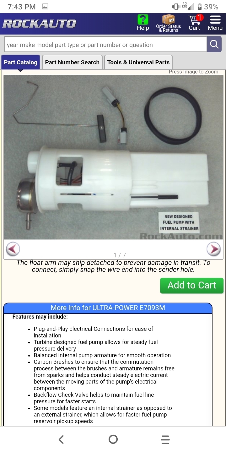

I'm pretty sure the fuel pump I switched my old 1 with had a new strainer on it. This is the one I got:

Many people buy the less-expensive pump and motor that has to be transplanted into that housing. When you buy the complete assembly, you usually do get a new strainer, but there are some that either come separate and have to be snapped on, and some that don't include a new strainer, (cheapskates). I don't see the strainer on the bottom, (right side in your photo), but it could be inside the housing.

What's the strainer look like and I can tell you if it had it or not.

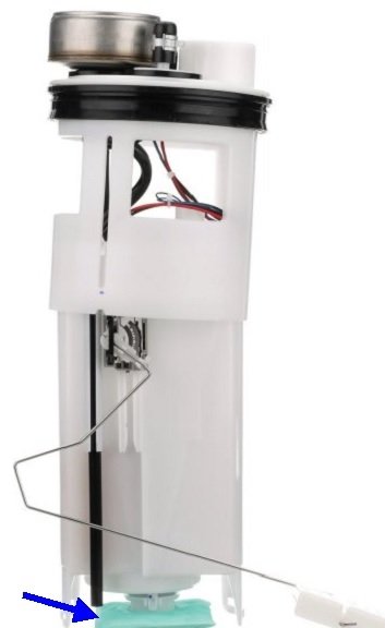

Here's the best photo I have that shows the strainer. I don't see that as being available separately for a '96 model. This was a $12.00 part for my '88 and '89 Grand Caravans. There is also no replacement available separately for my '94 and '95 Grand Caravans. I haven't had that problem with the two newer models, but it would take a new housing assembly to get a new strainer.
The problem I mentioned a minute ago had to do with failures of aftermarket fuel pumps. They'd last up to a week, then lock up. They always got replaced under warranty, then out of frustration, we'd buy one from the dealer and have no more problems. The cause wasn't really the quality of the pumps. What they found was Chrysler pumps were built to very tight tolerances to make them quiet, and microscopic debris in the gas tank was getting into the impellers causing them to bind. By the time you finally installed the dealer's pump, all that debris had been collected. There was a service bulletin issued that told us to have the tank steam-cleaned at a radiator repair shop any time the pump needed to be replaced. That seems to no longer be a problem, probably due to better additives in gas today.

That's good to know. but yes, my new fuel pump did have the strainer on it.
