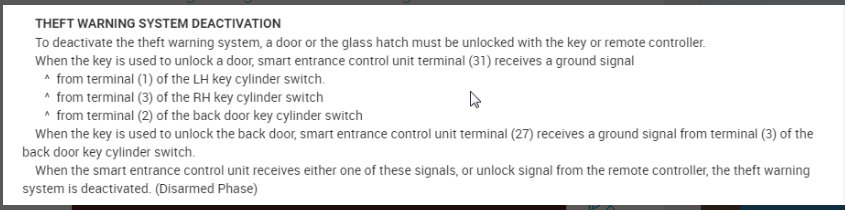

Door lock switch got wet. The doors locked and I tried to open drivers door. Alarm went off. How do I get it running now? I don t have key-less entry and my ignition key will not lock the driver side door. It will only unlock it. The trunk/hatch latch and handle are broken.
May 19, 2020 at 3:24 PM

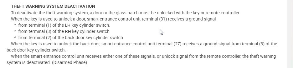

I attached the process on how to disarm the alarm system. The fact that unlocking the door with the key set it off tells me the smart entrance module did not see the unlock with the key which could be due to the lock being damaged.
I would suggest, disconnecting the battery for an hour and reconnect it and see if the system is still active. If it is, try unlocking the passenger side door with the key and see if that disarms the system.
If none of this works, we may need to check for codes and see if it is telling us anything. This older vehicle may not set any codes but we need to check.

Okay. I understand better now what happened. Was this viper system just a remote start system or was it an alarm as well? Your vehicle should have been equipped with an alarm system that can be deactivated by using the key to unlock either of the front doors or the hatch. Due to the hatch being broken that lock cylinder is out but the manual says unlocking either front door will ground the smart entrance system and it will disarm the system.
I understand that the keys were probably in the vehicle when it locked on its own which is why you had to go through the back. However, now that you have it opened, I assume unlocking the doors with the key will disarm it. You will need to hook both fuses back up and then try both doors and see if the alarm is deactivated.
If not then I suspect the door lock is shorted not allowing it to disarm. However, let's start with this and go from there. Thanks

Sounds like you have a driver door lock issue that does not ground the control module to deactivate the alarm but clearly the tailgate works as it should.
As for it not starting or the relays clicking, that sounds like a possible battery issue. Have you tested the battery recently? If not, just take the battery out and take it to a parts store and they will test it for free.
I would suggest just unlocking the vehicle from the rear so the alarm doesn't go off until we figure out why the driver door doesn't deactivate the alarm.
