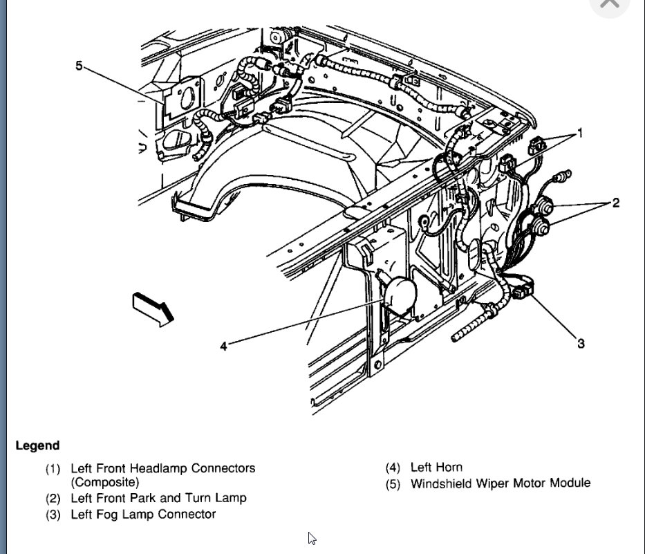

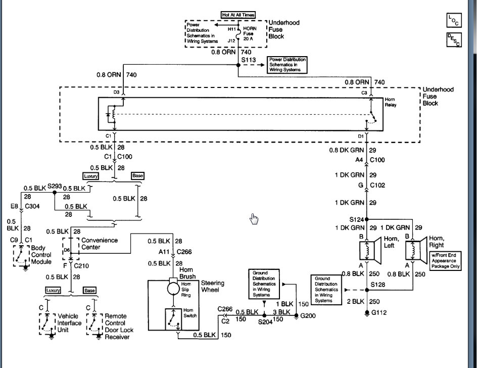

Where is the horn located at for my alarm system? Mine doesn’t make any sound when alarm goes off just lights flash.
Friday, July 24th, 2020 AT 11:37 AM (Merged)
Does the horn work when you press the horn switch on the steering wheel? You have a horn on the left and right. It appears the one on the left side (driver's) is for alarm. I would just check to see if you have power going to the horn when the alarm is on. If you do then the diagram in the horn isn't working and just needs to be replaced.
