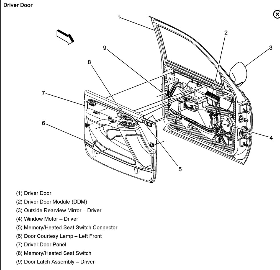

My truck will start and shut off when i release the key . The door locks wont work all of a sudden on either side , dome light not working.radio displays time but wont work. Seems like the theft system is not releasing for some reason I was thinking it has a bad door lock module can someone point me in the right direction Thanks Bob.G
Jul 24, 2020 at 11:34 AM (Merged)
SERVICE WRITER
  • 9,123 POSTS
Yes you are on the right track their is a driver door lock module that goes out all the time here is the location and the instructions on how to program it

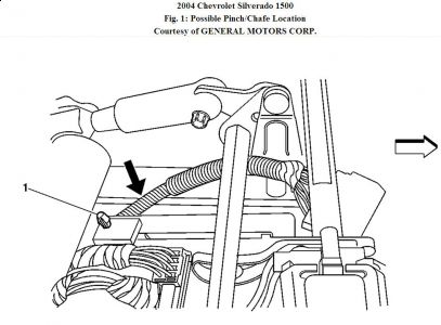

Well, I'm not sure if the no start and the other issues are related. If they are, I would be leaning to wires (not ignition) shorting out or a body control module issue. Let's treat them separate at this point and go after the most important one. Regarding the no start: Have you checked for any codes in the pcm yet? Check fuel pressure..(I assume a 5.3 liter). Critical that it is right in spec. There have been issues with e-85 fuel. Spray some carb cleaner in to the throttle body and see if you can run it off the carb cleaner for a few moments. Check for presence of spark. Check under the driver's seat for chafed wiring:
https://images.2carpros.com/forum/automotive_pictures/30961_xsil_1.jpg

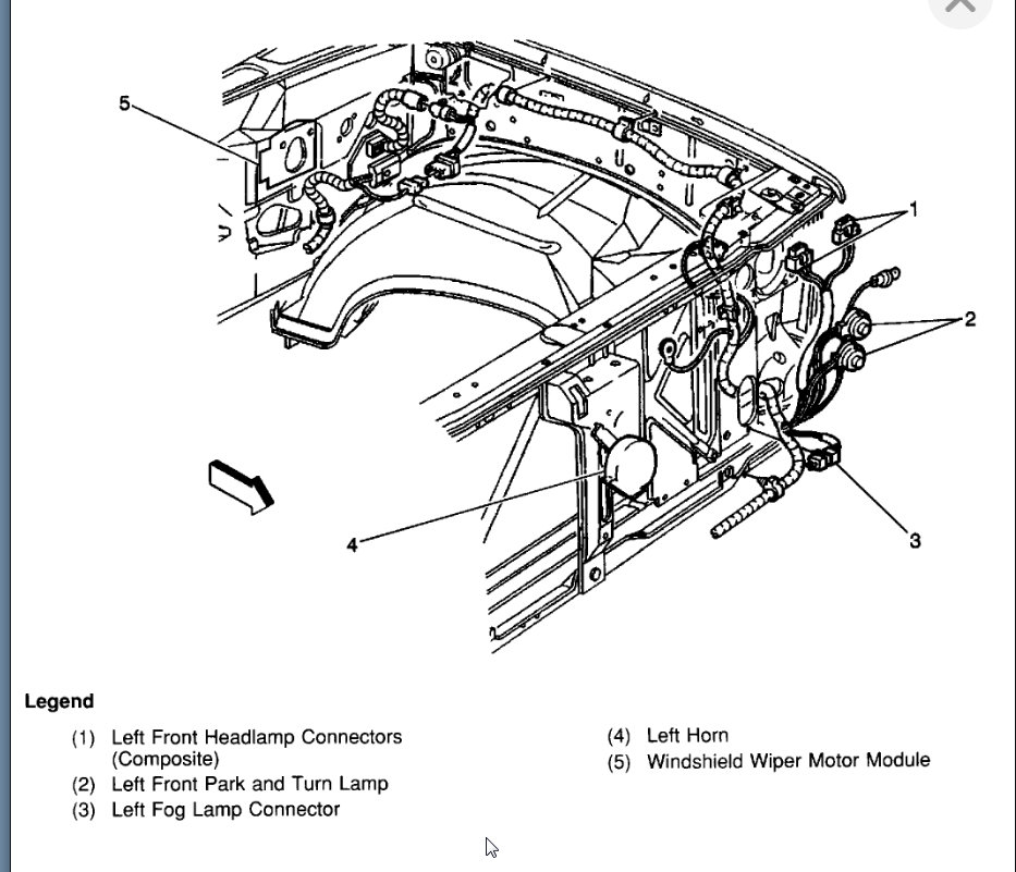

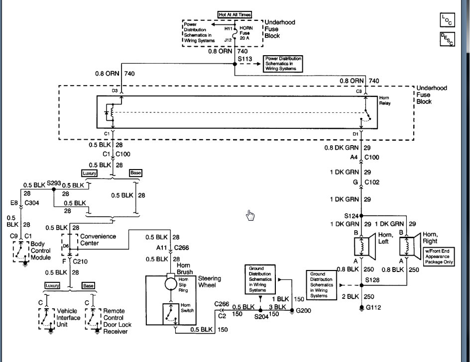

Where is the horn located at for my alarm system? Mine doesn’t make any sound when alarm goes off just lights flash.
Jul 24, 2020 at 11:37 AM (Merged)
Does the horn work when you press the horn switch on the steering wheel? You have a horn on the left and right. It appears the one on the left side (driver's) is for alarm. I would just check to see if you have power going to the horn when the alarm is on. If you do then the diagram in the horn isn't working and just needs to be replaced.
