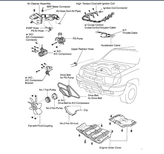

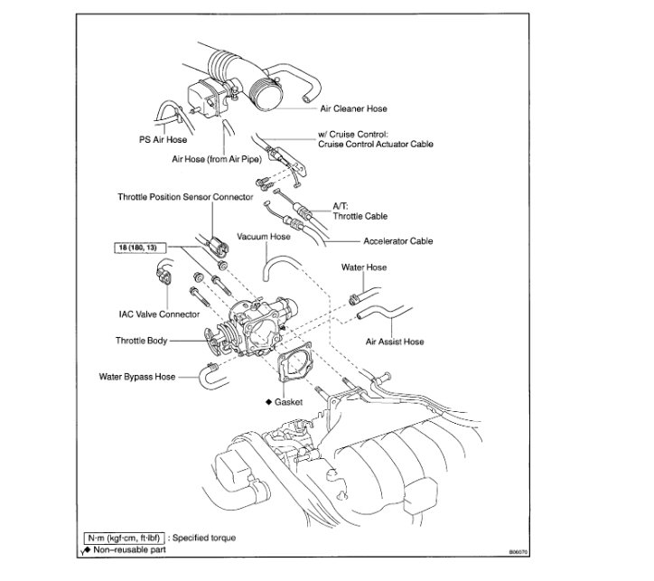

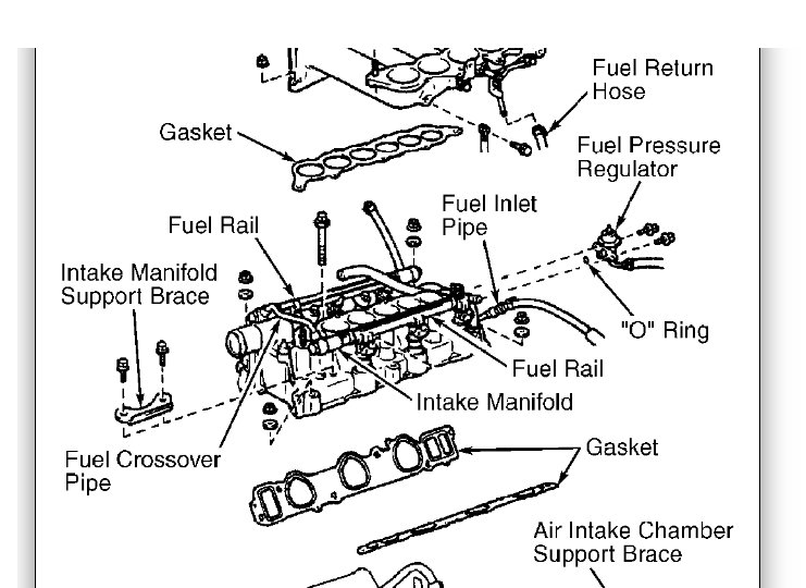

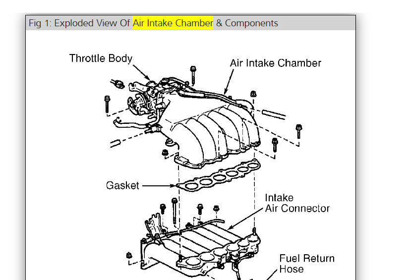

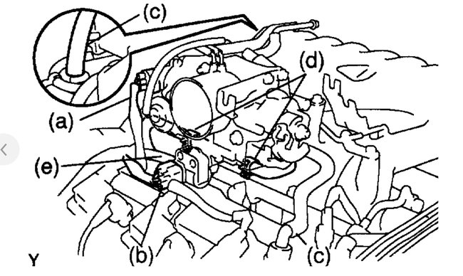

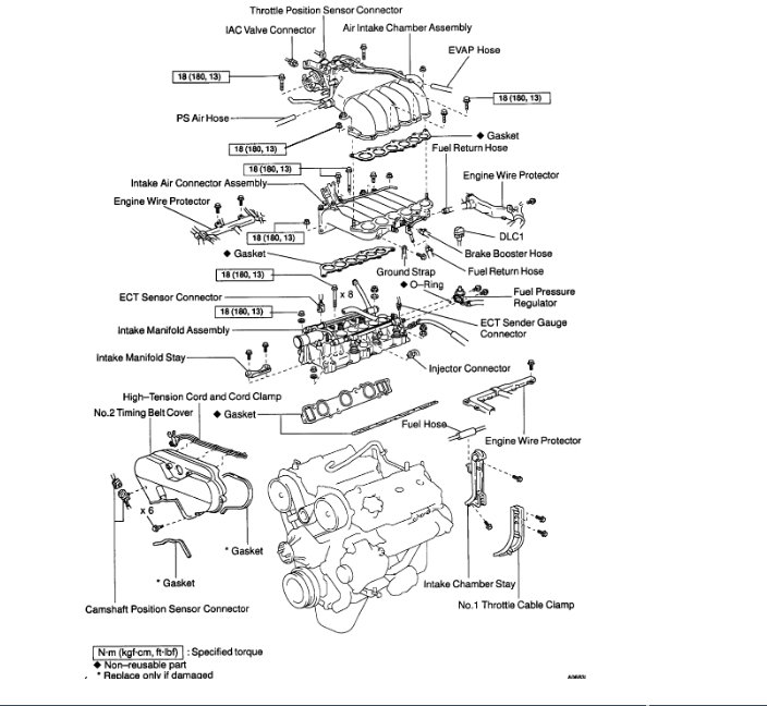

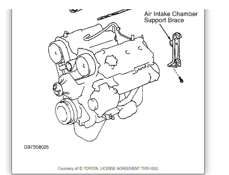

They all look good to me. Pretty strong actually. Cylinder 4 so/so but still very good readings as a whole. Okay, now that we know it's nothing internal causing these random misfires, normally I would go the ignition system, i.e. spark plugs, plug wires, ignition coil(s), but the problem with that here, is that you are having misfires on all of your cylinders at random times with no rhyme or reason to it. That would lead me to an air intake or vacuum leak. Next lets check to make sure no unmetered air is getting introduced into the engine, i.e. let's check the intake manifold gasket. Okay, so a vacuum leak and unmetered air is described as any air entering the air intake system up to the engine's combustion chambers that enters past the Mass Air Flow sensor(MAF). Since you are experiencing multiple random misfires this is the likely culprit. It would also produce rough idle and low speed driveability concerns and would smooth out at higher speeds because of the volume of air being ingested by the engine. Down below is a link explaining how to test for a vacuum leak. Please pay close attention to the intake manifold gasket area.
I have also included an exploded diagram of the intake manifold and associated parts in the diagrams down below to help you. Please get back to us with what you find out, and we can go from there.

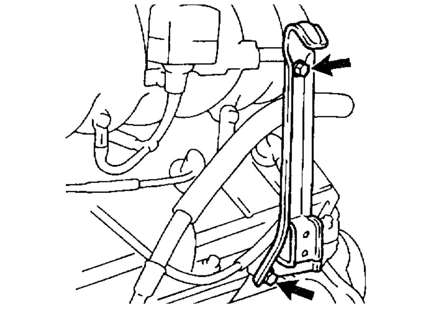

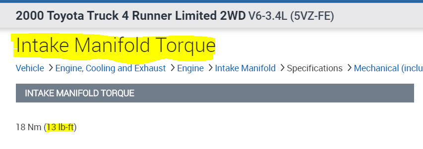

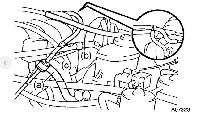

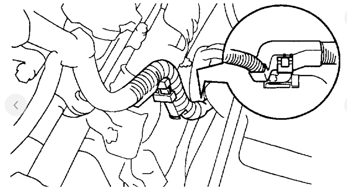

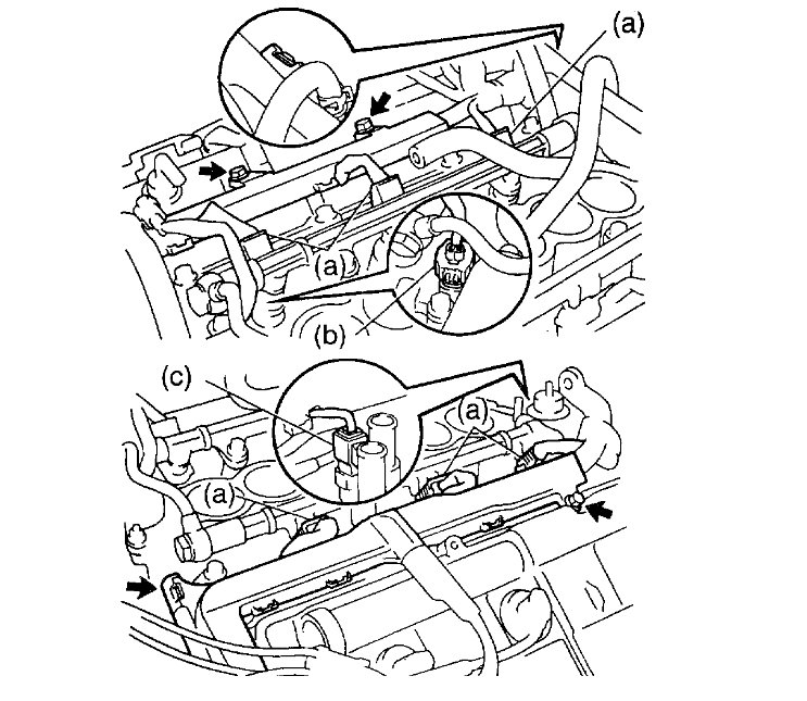

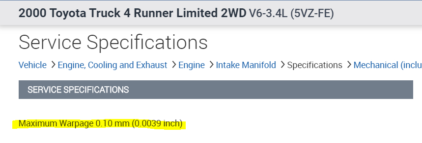

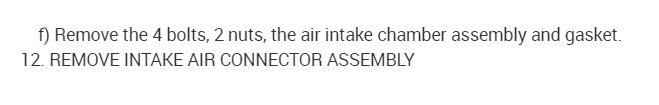

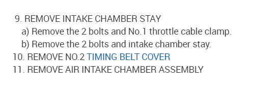

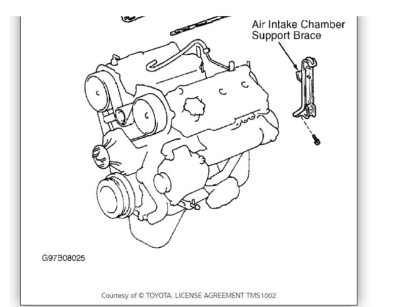

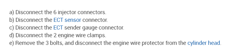

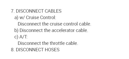

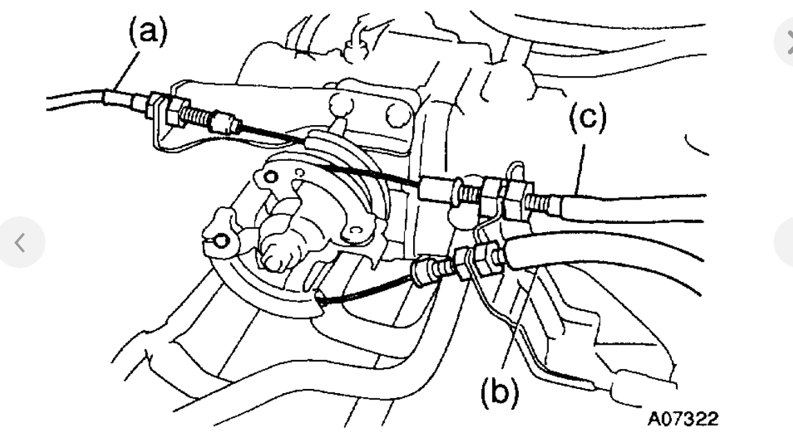

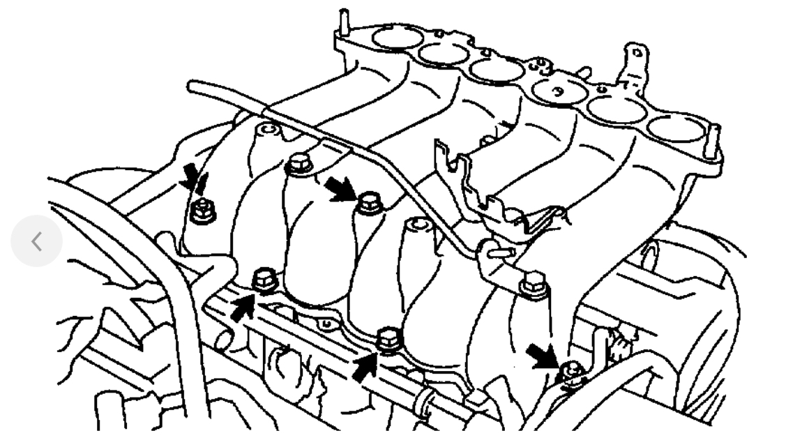

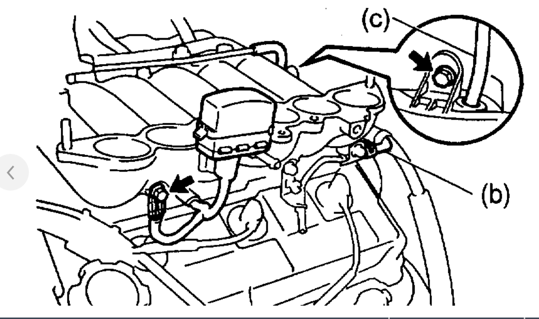

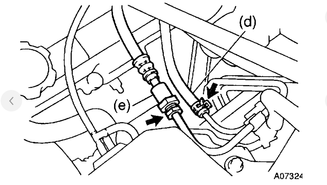

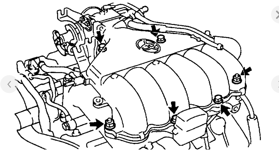

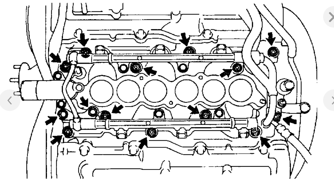

Okay, so in the diagrams down below I have included the step by step instructions for the removal of the intake manifold on your vehicle. This is an excerpt from the instructions on how to removal the cylinder head(s) on your vehicle. Toyota decided to combine the two together as you would need to remove the intake manifold to remove the cylinder head(s). The installation is going to be the reverse of the removal. I have included general diagrams for the first few diagrams. The torque specs are going to be for the intake manifold bolts. Basically on these bolts start tightening in the middle of the manifold and work out to the outside alternating sides as you go. Think about it as flattening out a table cloth, you put your hands in the middle and take the wrinkles out by smoothing it with your hands out the edges. Same concept. Don't overthink things. Be systematic and deliberate hear. A helpful piece of advice, have a cleared off table nearby with ziptop sandwich baggies a sharpie marker nearby. Whenever a components comes off set it neatly on the table top and place all of the fasteners(bolts/screws) in a sandwich baggie, zipped up so none get lost, and mark what they go to with a sharpie and place them next to that component. You will save an enormous amount of time and will make reassembly much, much, much, much easier. For the intake manifold gasket itself I would recommend buying Fel Pro Gaskets, and get a small tube of black RTV sealant(Permatex) and put a small amount on each corner of the intake manifold gasket to "tack" it down and hold it in place if there are no dowels to hold it in place on the engine. As far as torquing down the bolts, follow the torque specs, but remember do not over tighten. Less is more here. just enough to snug it down. Please go through the guide and let us know how it turns out, or if you have any other questions or concerns, please, don't hesitate to ask.
