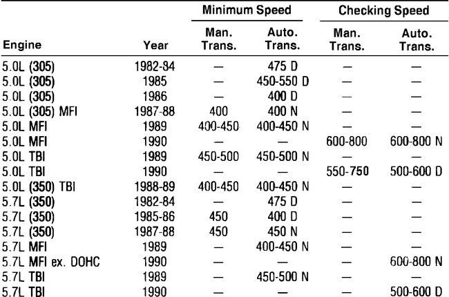

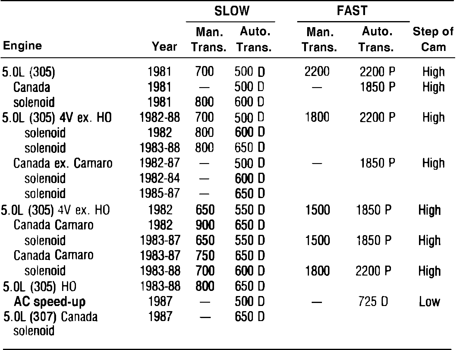

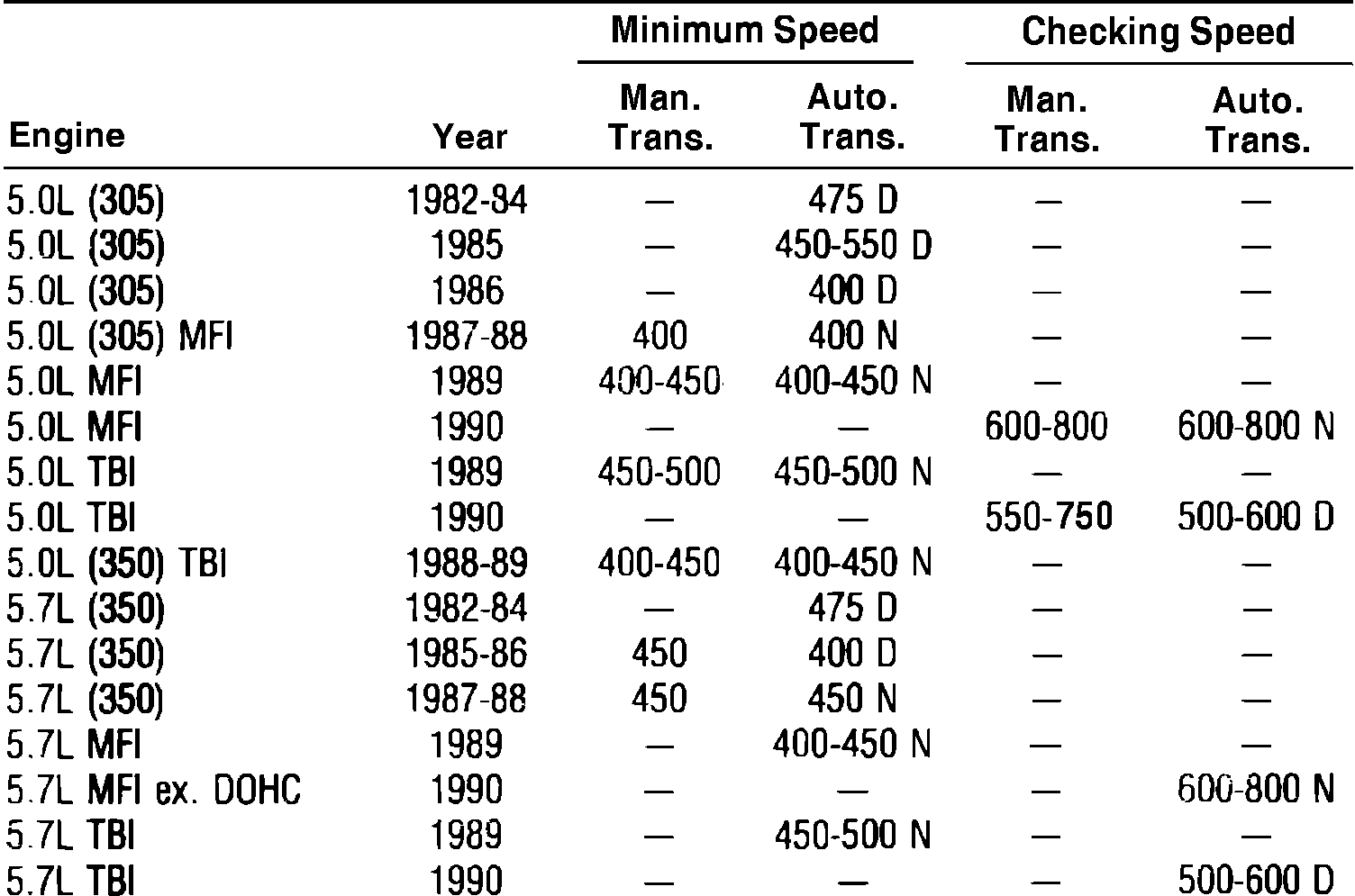

I was waiting and watching for this. LOL Ready for bed here. Anyway, is the engine idle speed when it's in gear and stopped low? I attached two pictures. One indicates idle speed if the engine is fuel injected and 2 shows if it has a carburetor. Take a look at them and see if it falls within the specs. Also, make sure the alternator belt is tight.
Next, I need to know what type of alternator was replaced because they have different types of voltage regulators. See Picture 3.

I'm not sure what its idling at, it has a 350 sbc in it and the rpm gauge isn't working properly! And the belt is tight it has absolutely no give. The battery stay's at 13v+ until I'm in drive and completely at a stand still, then drops all the way to red line, I can hear and feel the motor gradually slow down. But while in park and with foot off the brakes there is absolutely no problem. It idles fine.

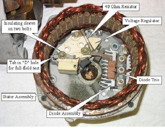

The second common problem that only pertains to GM generators is a defective diode trio. Current flow through the dash warning light gets this system started, then once it's producing current, a tiny sample of that is tapped off and goes through the diode trio. That develops a little current that keeps the electromagnetic field energized until you stop the engine. The voltage it develops has a second function. That is to turn the warning light off. The clue here when one of those three diodes fails, is it only turns the light off two-thirds. The often-overlooked symptom is the warning light is still lit up very dimly. Quite often you can only see it glowing at night.
The issue here is that is the current that runs the generator, and it is cut by one third. Under that full-load output current test, which you need a professional load tester for, your 140-amp generator will only be able to produce close to 90 amps. That standardized test is run at 2,000 rpm. At idle, that output current will be even less, and if it can't keep up with demand, system voltage is going to slowly drop as the battery takes over to make up the difference.
Another part of the tests can actually confuse this problem. That is measuring charging voltage. You can do that with an inexpensive digital voltmeter. With the engine running, you must find battery voltage to be between 13.75 and 14.75 volts. When you have a defective diode trio, the internal voltage regulator sees that dip in voltage when current is supposed to be coming through the failed diode. It responds by bumping up charging voltage a little. That can offer a clue on some cars. You might find battery voltage to be closer to 15.0 - 15.2 volts. That's not enough to boil the water out of the battery, but we want to correct that.

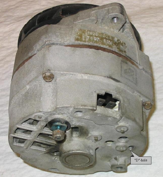

Are you familiar with the "D"-hole in the rear housing? There's a tab in that hole to ground. You poke in a metal screwdriver, pick, or even a cotter pin, to touch that tab, then move sideways to also touch the housing. That bypasses the voltage regulator and lets the generator run wide open. Remember, all generators are very inefficient at low speeds, so don't raise engine speed to prevent burning open the fuse link wire.
If Joe is right, doing this will bring charging voltage back up You'll also hear the engine load down a little, and the generator may "sing" a little to let you know it's really working.
If the charging voltage doesn't change when grounding the tab, the regulator is already running the generator as hard as it can, then the low voltage is going to be due to failed diodes or a slipping belt.
