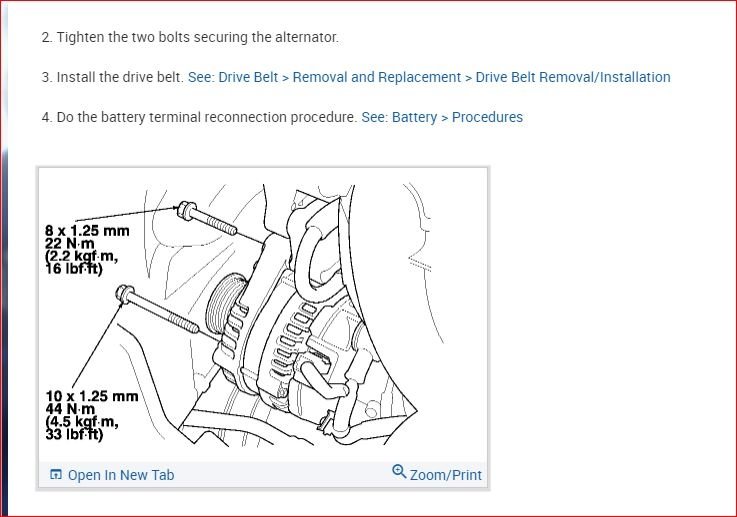

can you please send me the instructions to replace alternator?

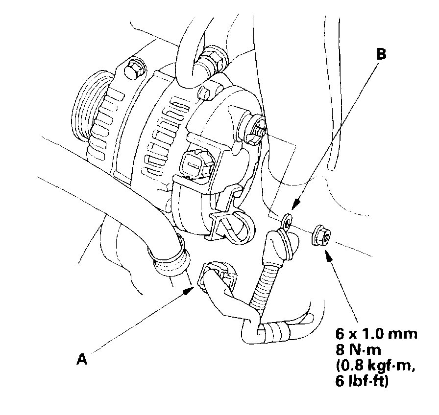

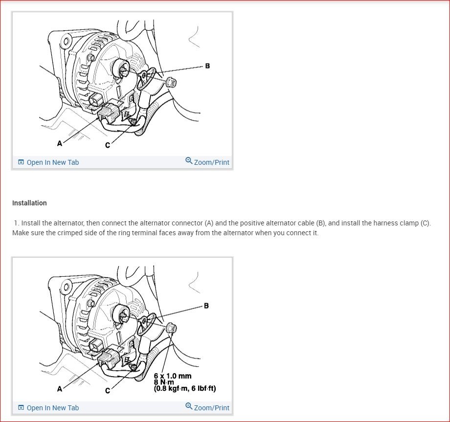

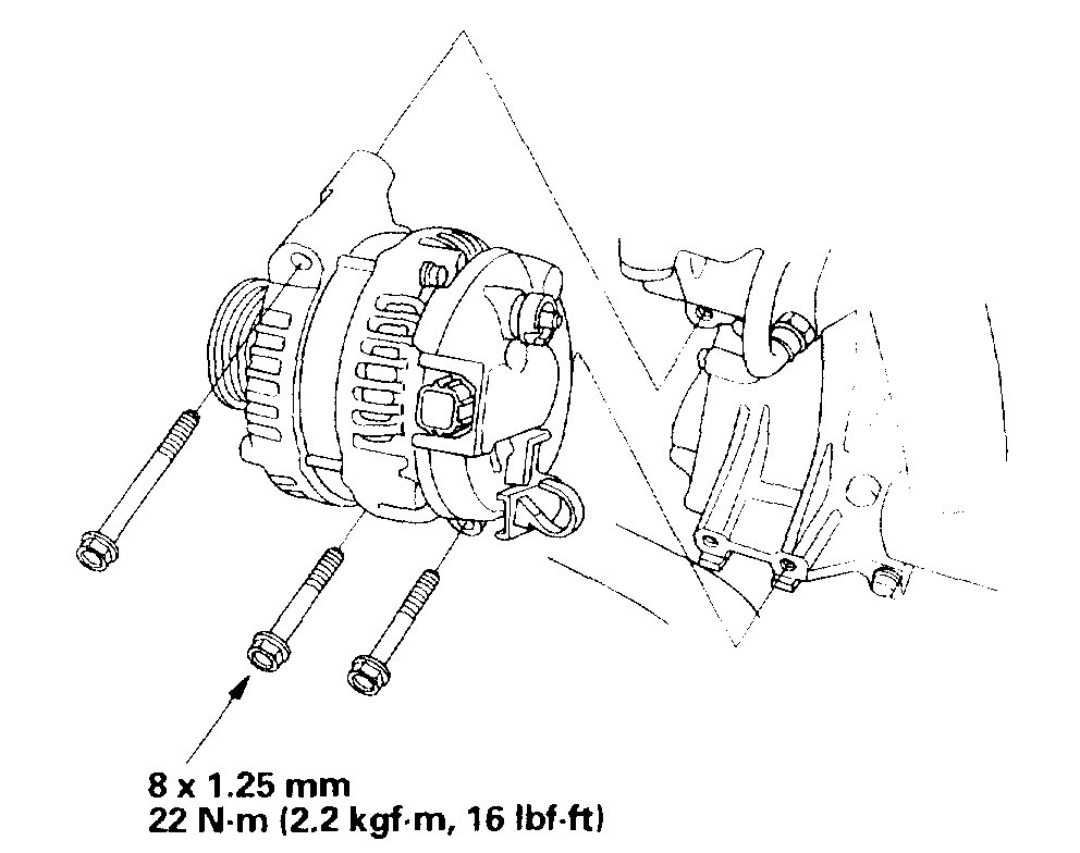

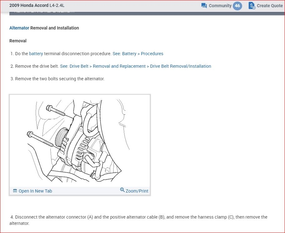

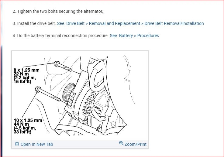

Here are the directions for replacing the alternator. The attached pictures correlate with the directions. It is a straight forward job. However, make sure the battery is disconnected prior to beginning.

REMOVAL AND INSTALLATION
Alternator Replacement
1. Make sure you have the anti-theft codes for the radio, and the navigation system, then write down the frequencies for the radio's preset buttons.
2. Disconnect the negative cable from the battery first, then disconnect the positive cable.
3. Remove the drive belt.
4. Remove the auto-tensioner.
picture 1
5. Disconnect the alternator connector (A) and BLK wire (B) from the alternator.
picture 2
6. Remove the three bolts securing the alternator.
7. Install the alternator and drive belt in the reverse order of removal.
8. Connect the positive cable and negative cable to the battery.
