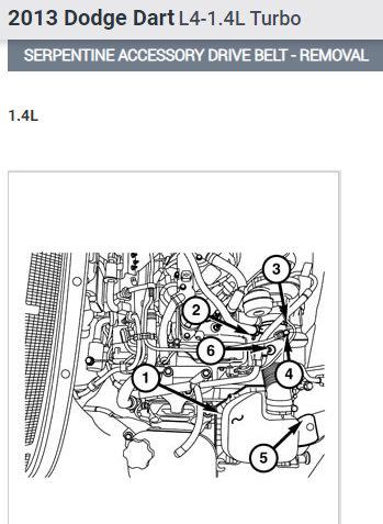

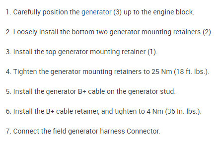

Any chance of finding a video for alternator replacement? Thank you
May 30, 2021 at 12:33 AM
DANNY L
  • 5,648 POSTS
Hello, I'm Danny.

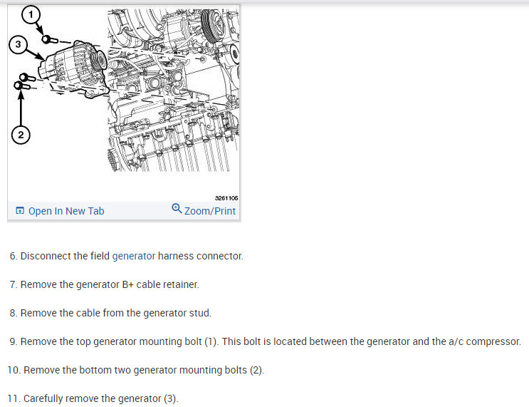

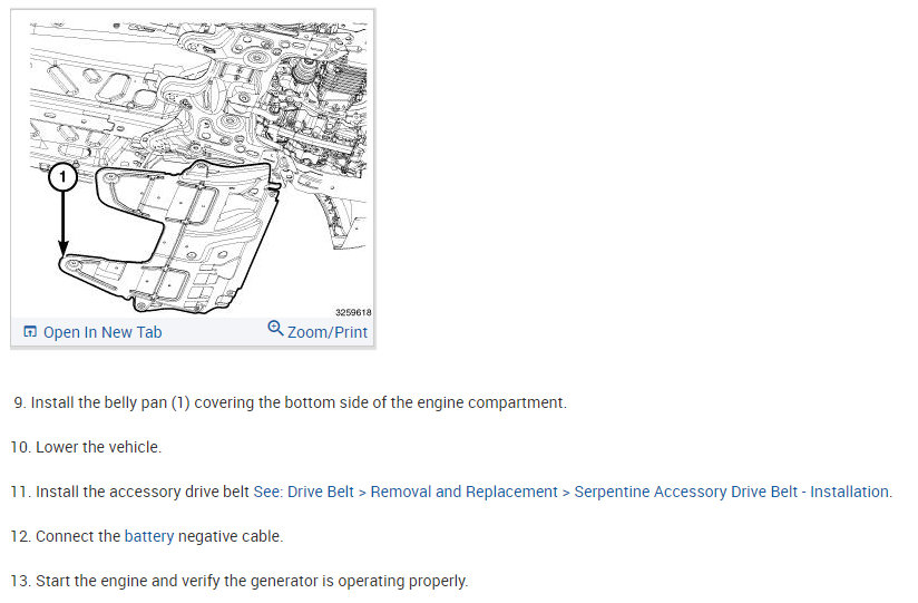

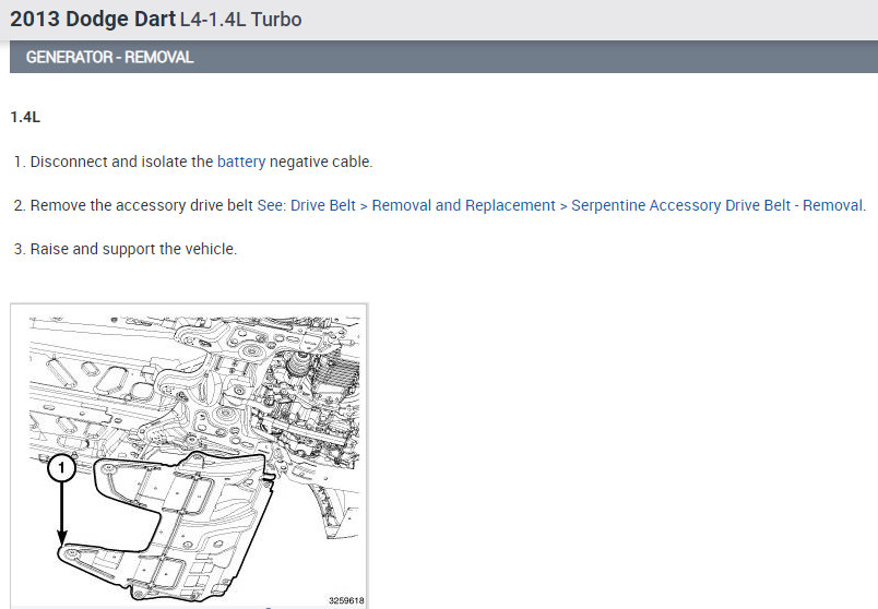

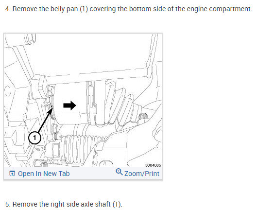

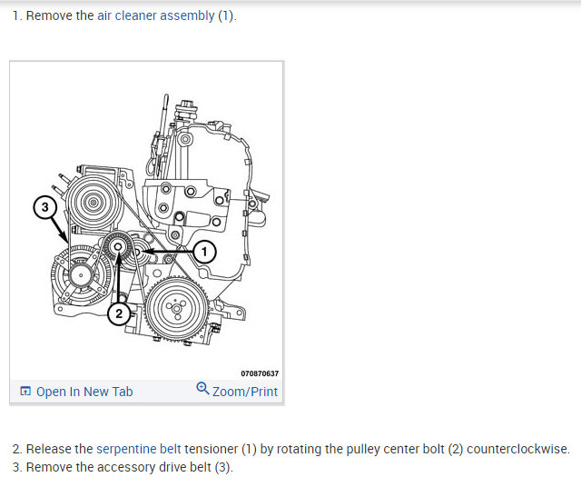

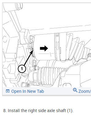

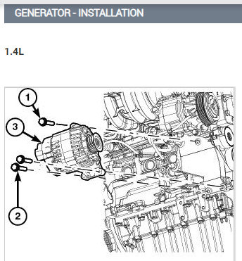

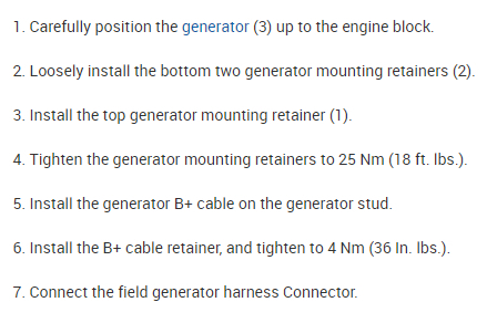

Here is the information you requested. You will first need to remove the serpentine belt to be able to remove the alternator. Here are tutorials showing how to remove and replace the serpentine belt and alternator:
https://www.2carpros.com/articles/how-to-replace-an-alternator
I've attached picture steps below on how to remove and replace both the serpentine belt and alternator on your car. You might be able to find a video on YouTube. Hope this helps and thanks for using 2CarPros.
