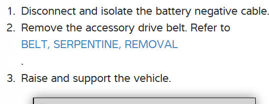

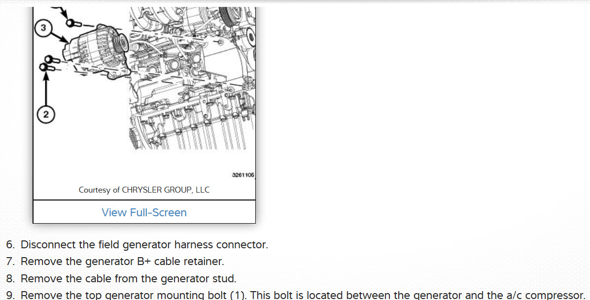

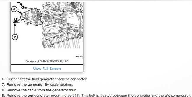

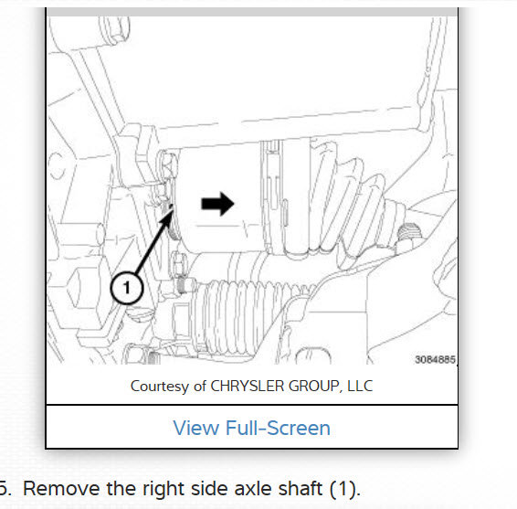

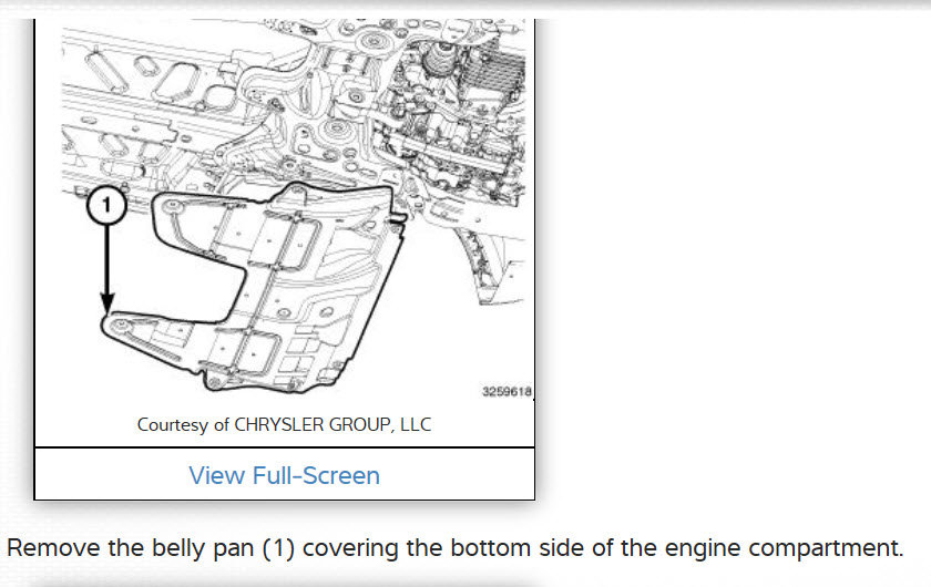

How do I take out my alternator out my car it is the limited edition 1.4L turbo at home?
Apr 23, 2017 at 2:11 PM
HMAC300
  • 48,601 POSTS
see pictures for removal. right axle shaft has to be removed as well or you can try to get around it, but probably will not be able to. Check out the diagrams (Below). Please let us know if you need anything else to get the problem fixed.
