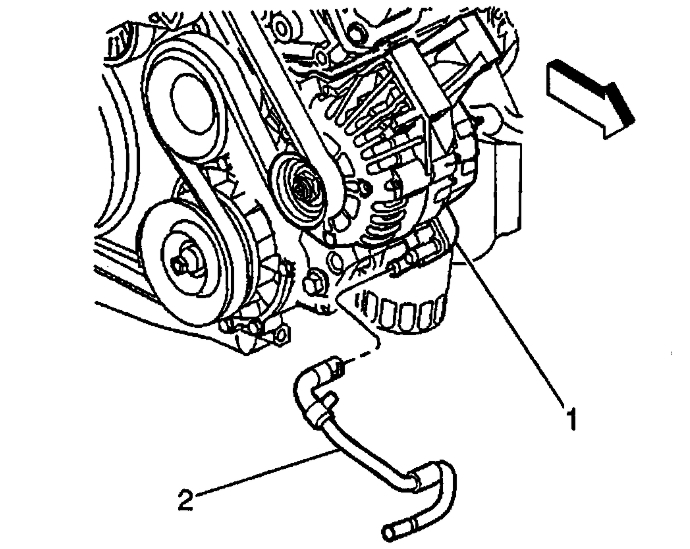

i had everything connected to what i thought was right. It ran great at first but now it keeps overheating and i can only assume, if not for air stuck in the lines, i connected the cooling hoses out and in wrong. Yes, cooling hoses to the alternator. In. And out. I've search everywhere and nothing provides a clear diagram of the wear connection and what the what to... please help

Good evening,
I attached a picture for you of the one hose for the cooling.
I doubt it has any issue with the no heat. sounds like you have a air block in the system.
