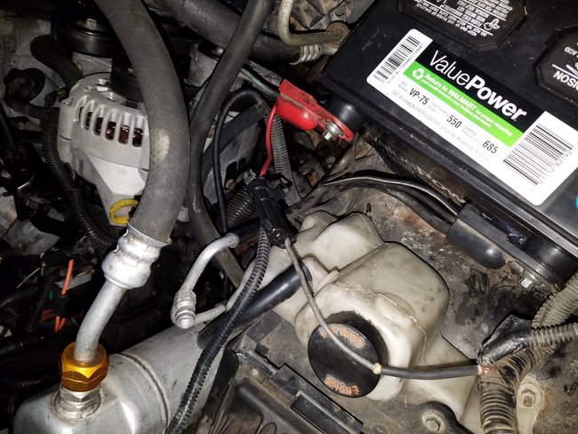

My vehicle has been through two alternators and two batteries. My alternator just will not kick on. I just did a motor swap (same engine 4.3l) everything runs good just alternator. My battery light does not come on either. Over heard that could be the problem in the past but I do not know. I need some help.

Thanks, I have done all the basics bought a volt meter it does not do nothing but drop in volts until the battery is at around 10 volts. Then truck idles really low until I cut it off and then it just clicks as the battery is dead. I have took my ground off once before and cleaned it I think my connections are good just alternators not kicking on.

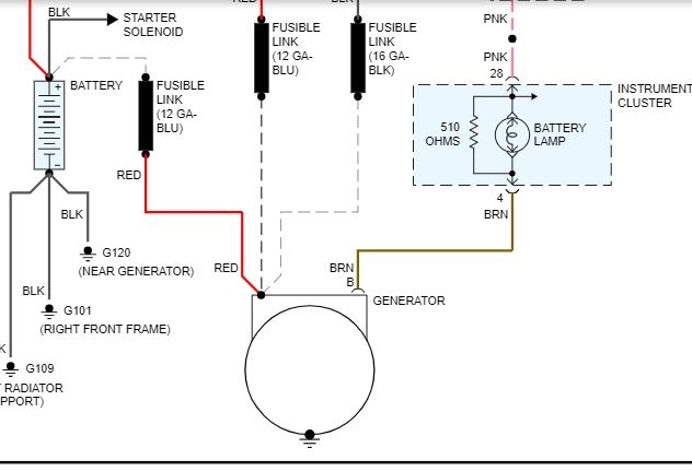

Welcome back. If the alternator is good and not producing current, then it either is not getting power supplied to it or the is an open between it and the battery. Since the light is not turning on inside, I suspect the open may be between the alternator and battery. Have you checked for a faulty fusible link?

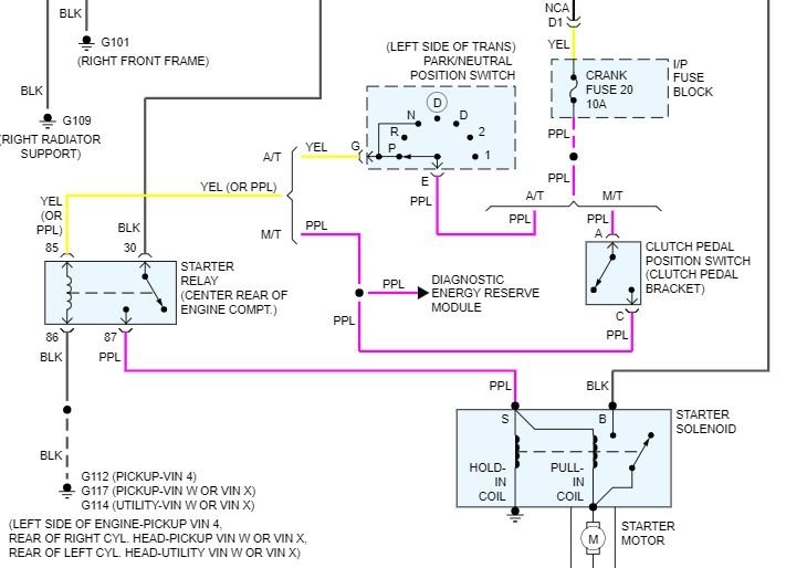

Take a look at the schematic listed below. It shows all of the for the starting and charging system. The first one I would check is the 12ga-blue one between the alternator and battery. Check it for continuity. If it is good, confirm that the power from the starter (also a fusible link) is good. I had to break the schematic into two pictures.

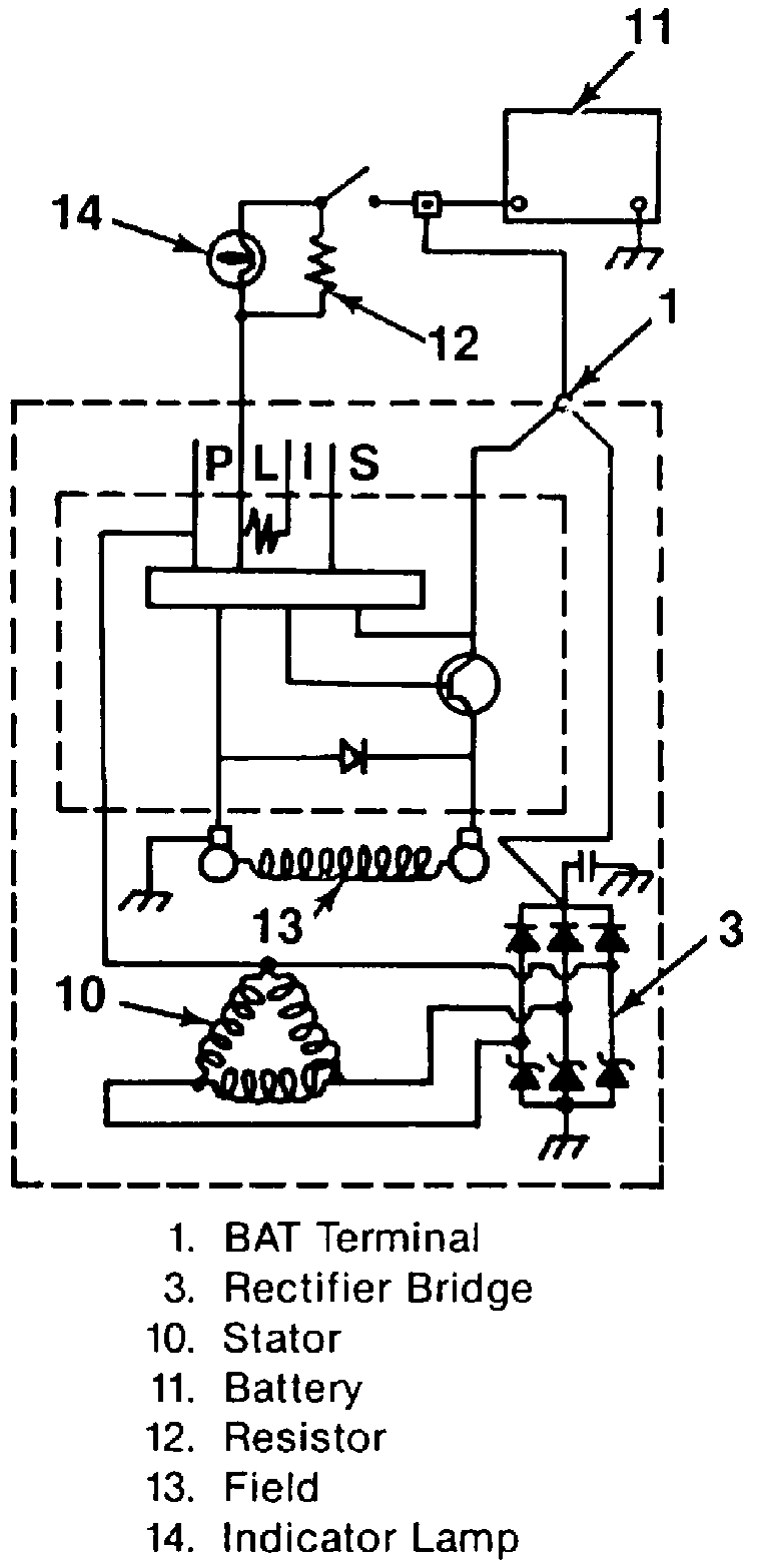

What I need you to do is this. If indicator lamp is not on, disconnect wiring harness at alternator. Ground "L terminal using a fused 5 amp jumper wire. If lamp lights, replace alternator. If lamp does not light, check for a open between the grounding lead and the ignition switch.

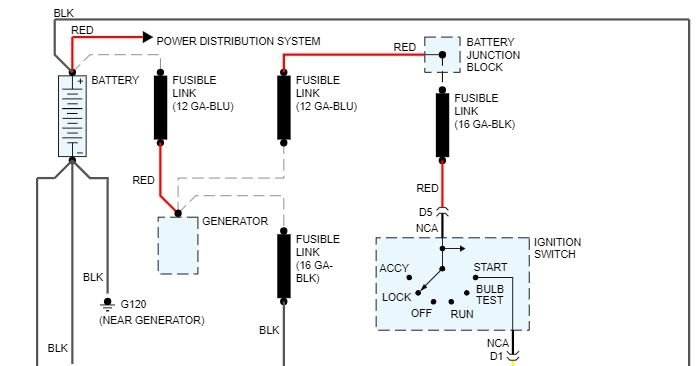

The wiring harness going to the alternator. As far as the system, here is a schematic of the entire system. Something isn't making good contact. For example, you may show continuity with a meter, but when a load is placed on something like a ground, it may still fail.

I dontthink I have that brown wire is that a bolt on one or the actual snap in plug wire because I think mine is red I'll look tomorrow after work and get back with you
