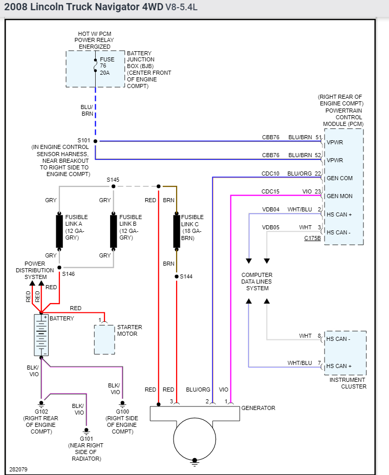

I replaced my battery and alternator, still not charging!
Mar 12, 2022 at 8:04 AM
SQM
  • 6,383 POSTS
The issue could be bad fusible link for the alternator. This vehicle has few fusible links for the charging system. They are located under the hood on the right side of the engine compartment.
I have attached the wiring schematics below.
