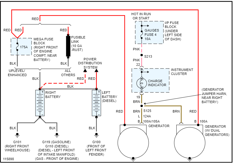

It sounds like the alternator itself is bad. What I would recommend is to remove the alternator and have it bench tested at a local parts store.
If you have battery voltage to it, it should be working. You are checking the power to the red wire where it attaches to the alternator, correct?
Also, as a reference for you, I attached the wiring schematic below specific to your vehicle.

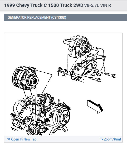

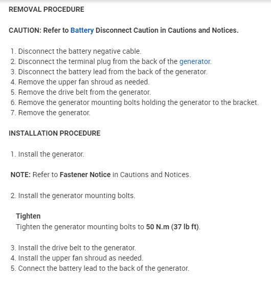

https://www.2carpros.com/articles/how-to-replace-an-alternator

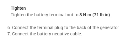

I attached the directions below for the removal and replacement specific to your vehicle.

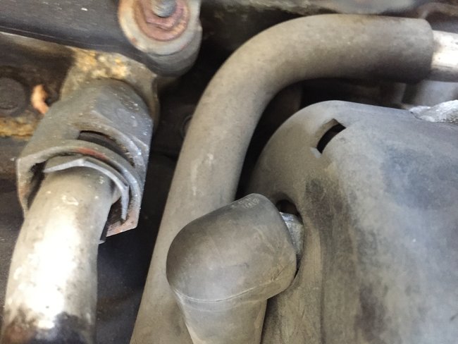

Yes, the power wire with the protective boot at the back top of the alternator was checked. Picture provided showing the wire. This had the same voltage as the battery itself. I will remove it and take it to get it bench tested. I read that on certain vehicles if the battery is below a certain voltage, the regulator inside the alternator won’t trigger the alternator to produce any charge, is this correct?

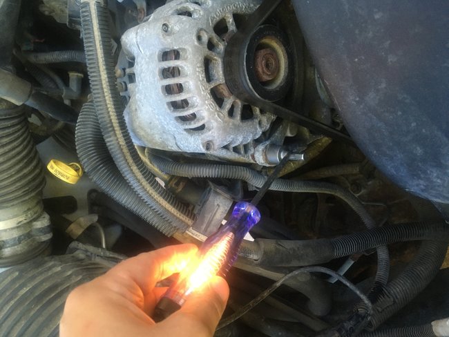

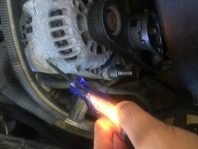

My wife put a light tester on battery positive post and touched bare metal on alternator in two places to show that the body ground is good to further rule out no ground issue to alternator.

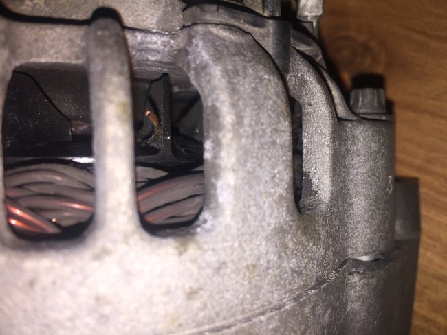

Joe, we had the alternator removed and sent in for testing at a electrical shop to find out it is defective and needs repair work as they found a broken ring soldered terminal in the stator? He said brushes are worn down to. You called it with a bad alternator from start, thank you. See image showing broken wire.
