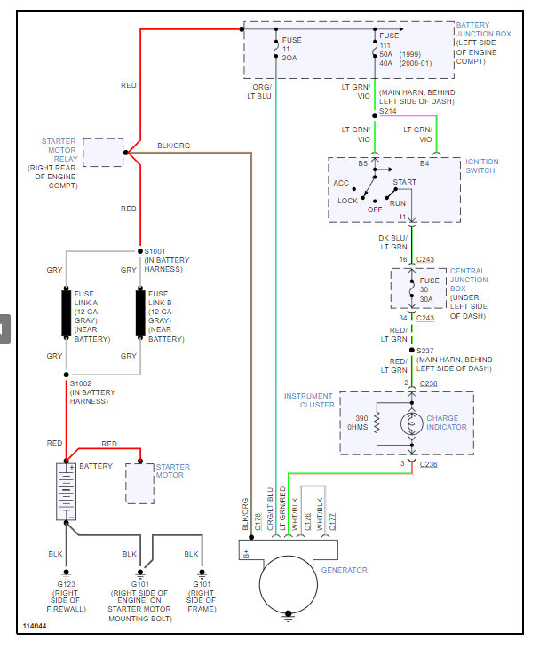

I got in my truck and the car charger for my phone was beeping, indicating the voltage was low. At that time it was 11.4 volts. I drove about five miles and the battery gauge dropped to zero. Wipers were barely moving. I started noticing resistance while driving. All of a sudden all of the gauges dropped to zero and the truck shut off. I looked under the under and the hot wire and rubber boot burned completely off the alternator. Truck is completely out. The nut on alternator is still tight. I checked voltage to battery and it is showing 10 volts. I need some serious help here.

it sounds like the wiring is bad but to be sure here is a guide to help check it with the alternator wiring diagrams below.

The nut was still on the stud but was so bad that it twisted off the stud when I tried to loosen it. Is there a piece I can buy that I can use as a stud or do I have to get one from a junk yard?

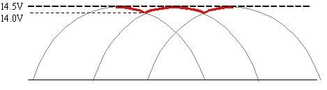

With that alternator showing 15.10, does that not seem high to you? I suspect that there was a bad connection, but could that alternator be a culprit?

The perfect range for charging voltage is 13.75 to 14.75 volts. 15.10 is high but not excessive. What you need to do is measure the voltage at the battery once the system is repaired. The voltage regulator can only do so much by itself. It needs the battery to help it, but that is not in the circuit when the output wire is burned open. It is not unheard of for a generator to develop 18 volts or more when there is no load on it. It depends on how that system works.

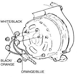

i need to know where a wire goes on my alternator so i need a pic of it

In replacing the alternator, we have to splice the wires for the electrical hook-up on the side. There is 1 small white wire and 2 thicker black wires. The black wires look to be the same size and we were unsure of how they connect.

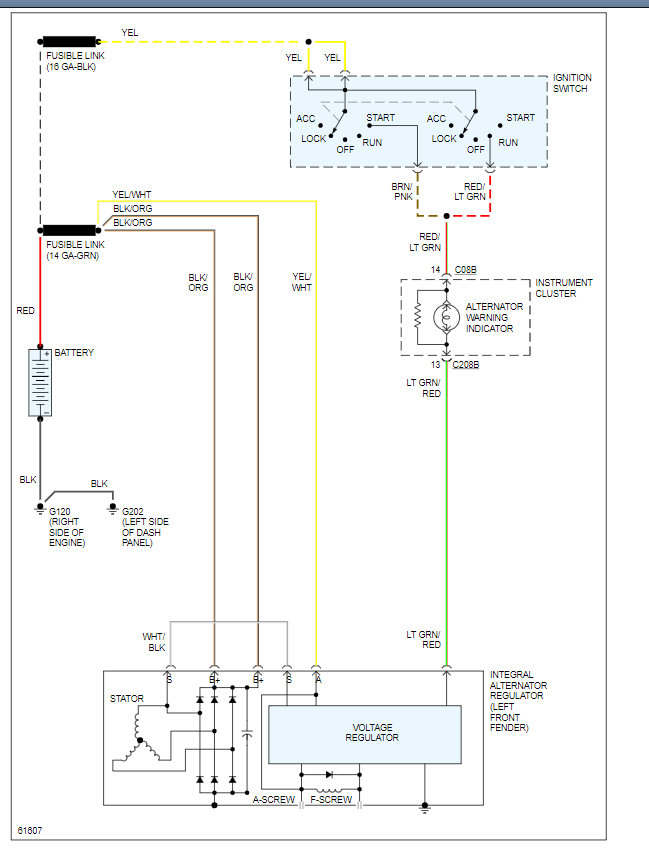

The alternator in the truck was giving me problems (gauge needle was bouncing back and forth, headlights were dimming/flashing, checking with voltmeter showed an inconsistent flow of power would spike to 14 then down to 11 then back to 14. I took the alternator to Auto Zone and they tested it and said it was bad. I purchased and installed a new alternator but when I checked it with a voltmeter it did not appear to be charging. I took the alternator back and had it tested and it passed. I was told to replace one of the plugs (3 wire plug that goes to the stator) I replaced the plug but still no output. I have since noticed that there is a wire broken off near the fender well, I traced that wire back to it's source and it goes to the 3 wire plug I replaced. I don't believe this wire is the reason for the lack of output on the alternator because it looks like it's been broken off for some time. Any ideas on what this problem could be? Thank you in advance for any help you may be able to provide.

According to the picture the wire jumps over to the regulator but on the truck it runs back up the wiring harness at least a couple feet before it's broken off. I don't understand why it would run back up that far just to come back to the alternator. Do you think this wire would keep the alternator from outputting power? I also checked that wire with the engine running and it was carrying about 1.05 volts. Thanks for the quick response.
