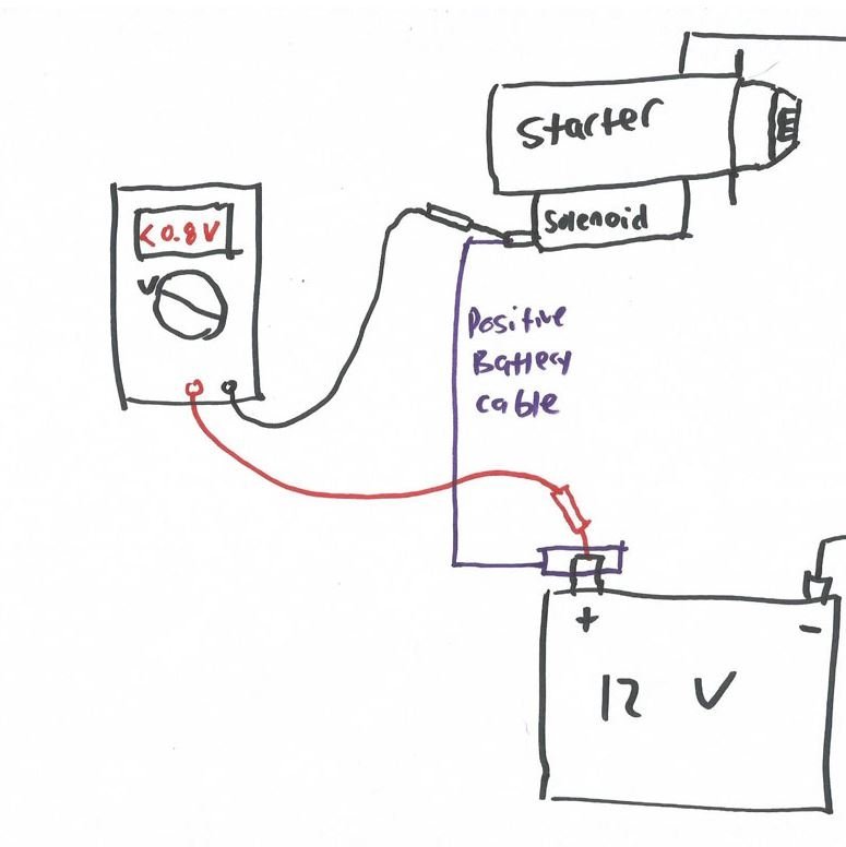

Alternator is only putting out 12.5 v under load at idle, if I install a high output alternator will that take care of my problem, battery keeps draining in about a week after having it charged or replaced and has new alternator,or what else could my problem be? put new cables for ground and alternator.

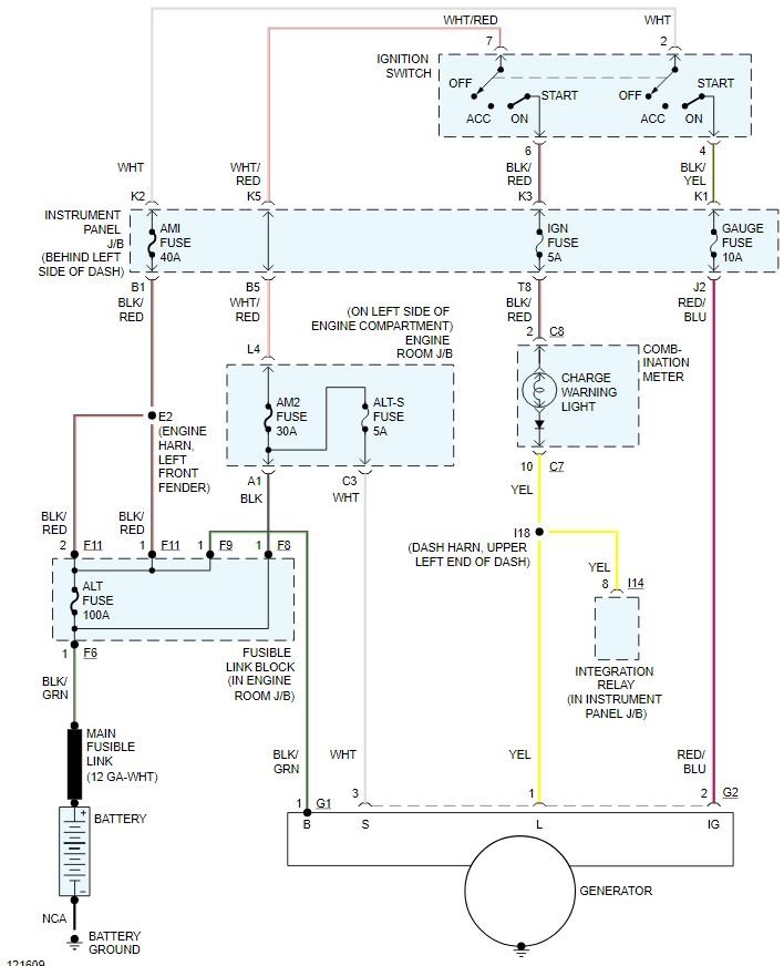

Next take a test light and unplug the alternator, turn the key on but don't start the engine. Use the test light and check all three of the pins in the harness connection for battery voltage. With the key on they should all show battery voltage because they are being fed power through the fuses and the ignition switch. If any do not show voltage that circuit is the problem. If they all test good then it is likely your alternator is the problem. It wouldn't be the first time a new part was bad out of the box and it has been getting more frequent.

Really dim isn't a good sign, what pin and wire color was it? The white wire is the sense control, it tells the alternator the battery voltage and controls the charge rate from that voltage. It feeds off the fusible link assembly directly from the battery. The red wire with blue stripe is the power feed to the regulator from the ignition switch, it comes out of a fuse, through the ignition switch and to the alternator. Both should be full brightness unless they have a problem. The yellow wire feeds the indicator light and does two things. If the alternator is working it will go out as the voltage from the alternator equals the voltage being fed to the bulb from the instrument cluster. It becomes a ground for that lamp if the alternator stops working. The bulb test is the lights on the dash like an oil, temperature, alternator, check engine and related ones that come on when you turn on the key then go out.

So it's the yellow wire that's dim and no lights on dash stay on only time battery light came on is after jumping it when I stop at a light everything would get dim and battery light would come on and that's at night with head lights on and A/C and radio.

From the numbers you have a bad connection. The alternator is charging as shown by the 13.93 and 14.00 volts in your second set. But when you apply a load as in the 12.44 idle under load, the voltage drops off. That is a classic sign of a poor connection, AKA voltage drop. For example say I take that meter and connect it to a single small strand of wire, with a 12 volt battery at one end, I will read 12 volts through that wire because the meter doesn't apply any load to the circuit. Now if I were to connect a 12 volt bulb in there and then measure it, I may see only 10 volts or so on that wire because that single strand cannot carry enough current to keep the voltage up. Same thing happens on a vehicle, a bad connection or corroded wire acts like a resistor and reduces the voltage but only once the load exceeds the ability of the connection to carry the voltage.
To test where the issue is, Take your meter set on volts. Now connect it between the positive battery terminal and the battery stud on the alternator with the engine running and the headlights on. Next take the meter and connect it between the negative battery terminal and the case of the alternator or a good bare spot on the engine. In both cases with very good wires and connections you in theory should see no voltage on the meter as all of the current should be in the heavy cables. In the real world you will see a tiny voltage like .10 or less because the cables do have some resistance. However if you see a voltage over one half a volt or higher, that cable or connection is bad. From the numbers you have posted I think you will see closer to a volt on one or the other which means a very bad connection. That drop would get higher the more of a load on the circuit as well. So say you are running the car and have the A/C on and the headlights with the interior blower on high, the voltage drop could easily be 3-4 volts which would drain the battery and cause your problem.

No set it to volts. You are testing similar to this image except to the alternator instead of the starter. Say you have a fully charged battery at 12.6 volts. You start the engine and it now shows 13.6 volts, that is charging. With the meter connected as in the picture between the battery positive and alternator output posts and the cable connected with a load like the lights on, you should see a very low voltage, no higher than about .2 or so at the most if the cable and connections are good. If you them do the same on the negative side you should see a very low voltage. In a perfect world it would read zero, however nothing is perfect when it comes to cars. I think you will see a higher number on the positive side though as with the amp draw there should have also been a low like .05 that you had on the negative side if all of the current was going through the cable as it should.
If you want to see the idea just search for voltage drop testing, there are a lot of videos out there on it, from basic to explaining it down to electron flow.
