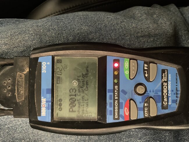

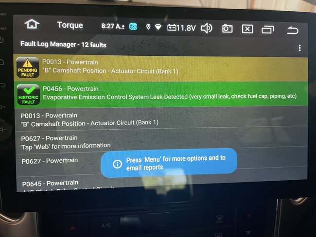

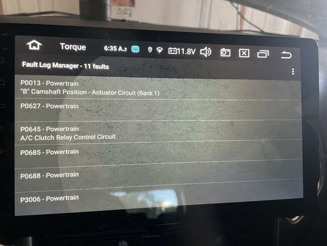

Battery voltage is at 11.54 engine running cold start. Purge unplugged. Just started the car. We’ll see how long it runs. Is it possible I bought a bad VVT solenoid from Napa?
Okay, it’s still running but I’m going to shut it off as it’s extremely low on fuel and I want to be able to get it on the trailer if needed.
Jun 2, 2023 at 2:32 AM
LEPRIKAAN
  • 29 POSTS

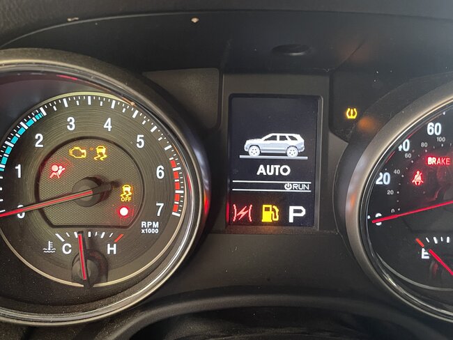

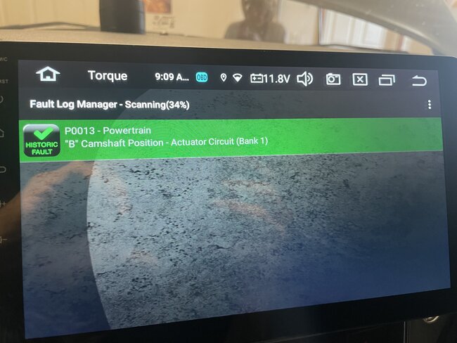

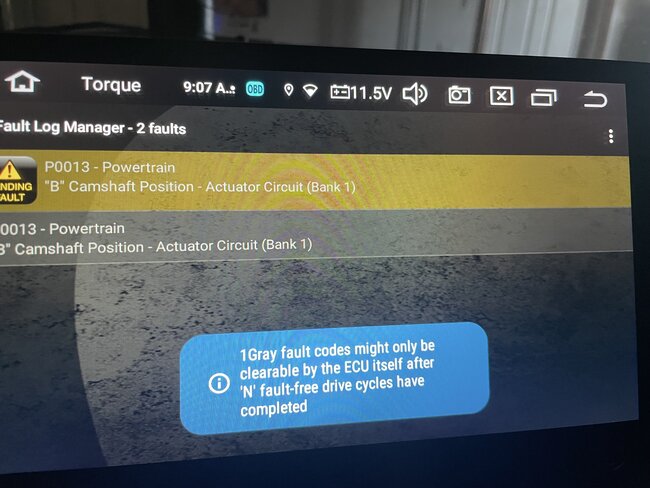

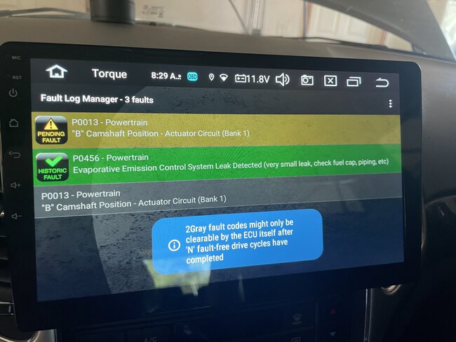

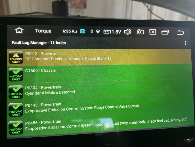

Update: I’ve replaced the battery and alternator with all new, also replaced the VVT Solenoid as well as the jumper harness. The car stays running now but P0013 is persistent and battery light is flashing/on. I’m leaning towards a fried pcm but I can’t be positive. I did find a fusible link in the alternator wire and did a voltage test on both sides of the link, it’s registering voltage through the link. No alternator fuse in the fuse box. I think it’s a pcm issue because the CEL and persistent P0013 code as well as the battery light. The battery light indicates a fault in the charging system and the p0013 code says there’s a short or an open somewhere, I can’t find a short, bad ground or burnt/broken wire. There is continuity to the vvt on the ground and positive. I’m hoping there’s power making it to the vvt but don’t want to mess things up worse trying to check for voltage as I’d have to take the intake off again and probe for voltage on a brand new jumper harness.
I’m at a total loss here now, so my option now is to take it to the stealership for further diagnostics.
Any suggestions or ideas are very welcome and I appreciate all of it.

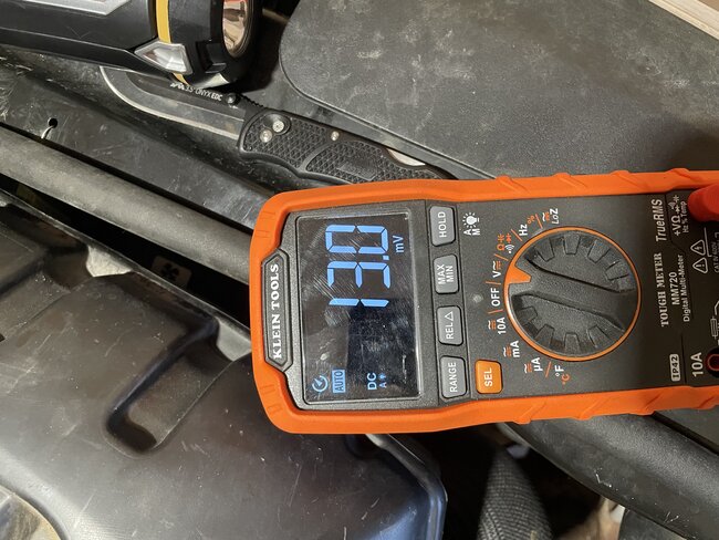

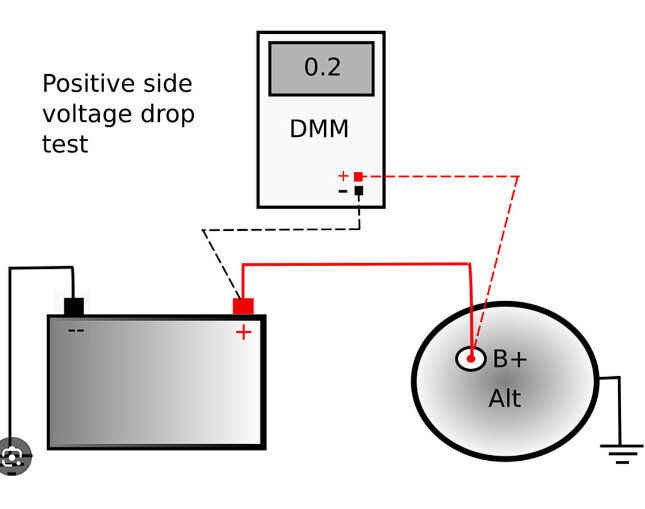

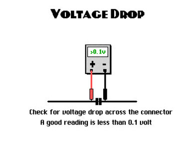

Hi there. I just want to make sure I am reading your update correctly. When you say you tested the voltage for the link, did you use the meter as pictured below? If so, a voltage reading would indicate an open circuit. The fuse link is likely burned out.
Jun 28, 2023 at 11:30 PM
LEPRIKAAN
  • 29 POSTS

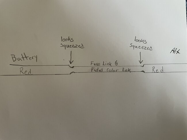

I did the voltage test with the car off and put the black/ground to ground and positive/red probe into the wire just before the link, it showed battery voltage of 11.5 or so, then probed again just after the link and it showed the same voltage.
I didn’t put the ground to the positive for the test, I’m using a loaner multimeter and didn’t want to end up frying it.
I meant to get a picture of the link but forgot. But this image is basically what it looked like.

Okay, thanks for the clarification. In this case the fuse link tests okay. What is the battery voltage with the engine running now?

With the engine running it first showed 12.9 V, but letting it sit and idle, it dropped charge to 10 and continued to drop.

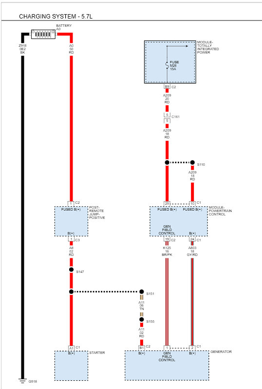

Alright, the alternator is not charging. I found this excerpt in a service manual: Voltage is monitored at the B+ terminal stud to insure it is connected. If the B+ cable is loose, the PCM will shut down the generator field. Because of this new feature, pin-2 of the field connector is internally connected to the B+ terminal.
So, I would double check that all of the connections from the battery post to the alternator are clean and tight. Then I would carefully back probe the GY/RD wire at the alternator for voltage with the key on engine off and with engine running as long as it is safe to do. Red lead to connector, black lead to ground. You should have battery voltage.
If that is ok, I would check for a signal on the BR/PK wire at the alternator. A test light connected to battery positive and back probed to the alternator connector should flicker with the engine running. This shows that the PCM is trying to command the alternator.

I took it in to the dealership on 4-28-2023, waited the UAW stike out and finally got the PCM in on 11-28-2023. They had it installed and it’s now in my driveway again. Though the TPMS light is on and shows the fr flat line and rr continuously fluctuating. The light flashes and then stays lit. Thinking it’s just the sensors but will diagnose in the daylight.

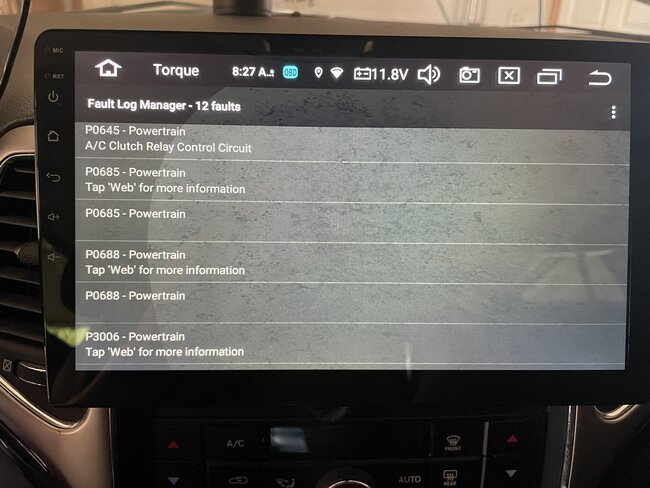

Thanks for the update and we're glad to know it is taken care of. I read back through parts of the thread. The voltage regulator is integral to the PCM. It is a voltage-regulating circuit located within the Powertrain Control Module PCM. Based on what has happened and you not getting a charge, the PCM is certainly the likely cause.

Battery, alternator, jumper harness, and VVT solenoid. After bashing my head against walls and getting nowhere with removing a P0013 code that seemed to be permanent, I had come to the conclusion that when the alternator fried, it also took a good bite out of the PCM, because it was showing codes that belong to Caterpillar and Prius code C1600, as well as the stuck P0013 code along with ac relay codes and a few others. Under the intake manifold is the VVT and jumper harness, the harness and top of the block has a thick foam padding that mice love to nest in. Mine was nested in and the mice had chewed some of the plastic insulation off the jumper harness and it was showing copper, not chewed through, just stripped a little bit but enough to potentially cause problems. All in all, I spent about 20-30 labor hours as well as about $2,200.00 to fully fix it.
