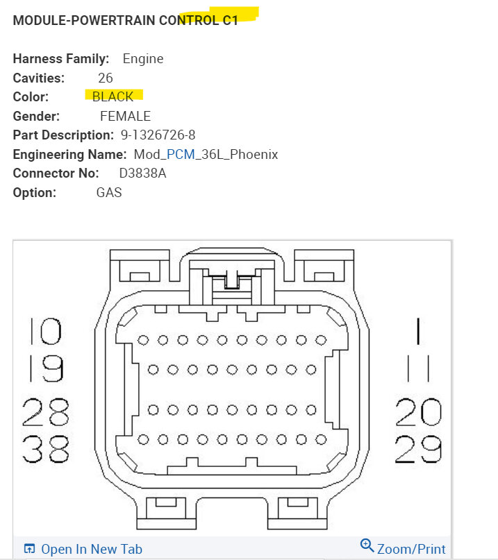

The vehicle listed above is a Cherokee Laredo. I parked the car for about 2 hours and when I came back, I started it and was idling for about 5 minutes while I was preparing to leave. I noticed a whirring noise and some smoke; I popped the hood and saw a red hot ember within the alternator so I got back in and reached for the start/stop button. As soon as I touched the button the battery light came on, i pressed the button and everything went black. I towed the car back home and proceeded to diagnose.
I replaced the alternator with a used one and put in a new AGM battery, started the car and was presented with a CEL. I put my Innova code reader on and got P0013: Exhaust Camshaft Position Actuator Circuit / Open Bank 1. I’ve been racking my brain to figure this out. I’ve pulled the intake manifold off and found bad/bare wires at the VVT solenoid, I repaired/mended the wires where it showed copper and ran continuities on both wires from before and after my mended spots, I then put the manifold back together. Started the car and got the same code. I pulled the manifold back off and pulled the VVT solenoid out. I ran a continuity test on the solenoid about 5 times and it was flat line, so I changed the multimeter to duty cycle and tested the solenoid, it was flat. I tested yet again on continuity, and it registered, every test after has registered with continuity. I put the solenoid to 12v to check for actuation, it actuates but I’m not sure if it’s fully opening. I left the whole thing where it is and ordered a new solenoid and jumper harness. I’m waiting on the new harness to arrive before I do anything further.

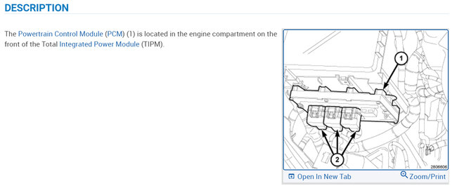

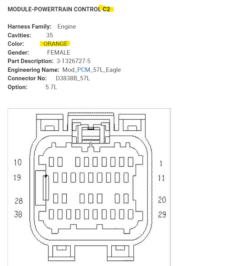

My question is how do I identify all the wires coming out of the PCM? It has 4 big plastic connectors coming out and lots of wires in each.
I have sourced a flow chart diagram of the engine electrical, but this doesn’t help me to single out the wires at the PCM side. My worry is that it’s a burn/broken wire further down in the jacket where I can’t see or reach, but if I can pinpoint the wires at the PCM side, I can in theory jump past the bad wire with a fresh wire, therefore saving thousands in repairs and having my vehicle running again.

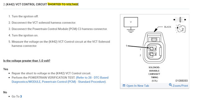

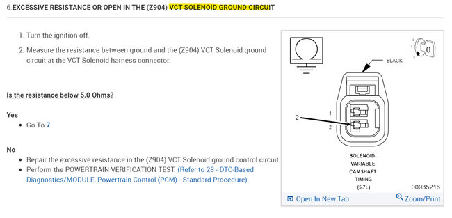

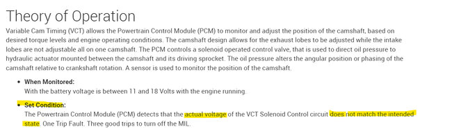

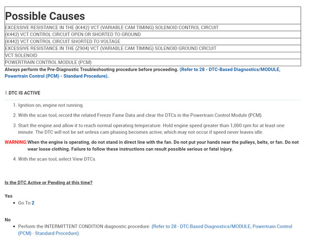

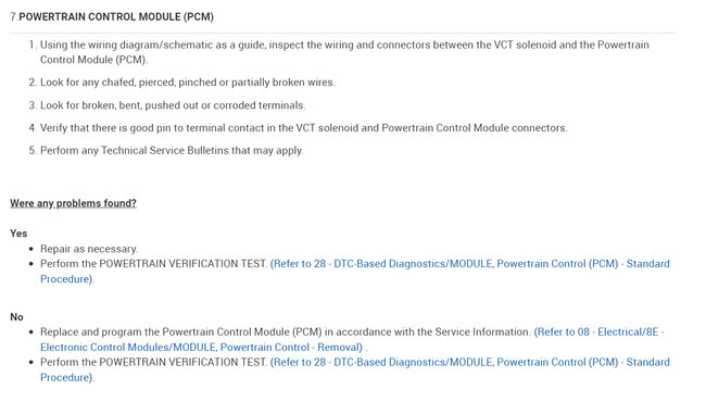

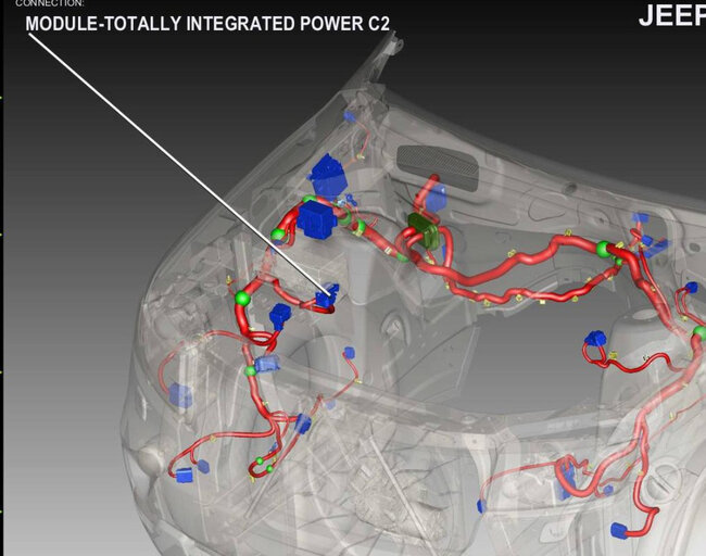

Hello, yes, we can pull up a wiring diagram for the ECM for you. Just going through the information, you provided. If the alternator was that hot inside, chances are that the diode set may have fried as well, but you won't have any AC voltage ripple now with a new alternator. Also, your assumption of further wire damage is most likely correct. Let me pull up the ECM diagrams for you.

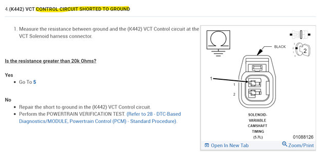

Diagrams 1 to 8 are the flow chart for checking the rest of the circuit for shorts to Ground, shorts to power, and resistance in the circuit to the ECM, which I'm also getting the diagrams for, as well as the ECM connector C3 which is where the control wire for the solenoid runs to. It looks like this is a power side switched circuit, which I'm not sure why they would control it that way, but they did. Some of the flow chart tests you already did. But at least you'll have them, Hopefully the ECM driver for the solenoid didn't burn out.

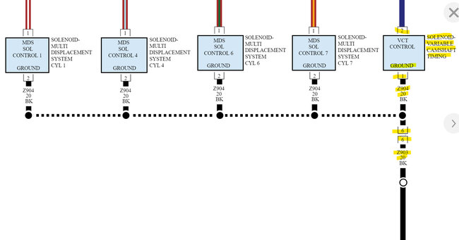

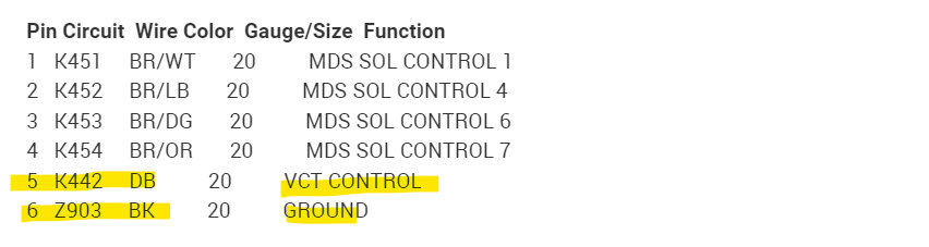

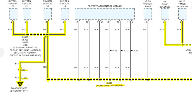

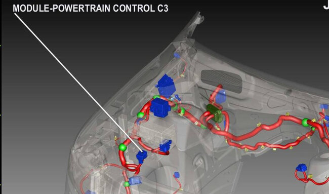

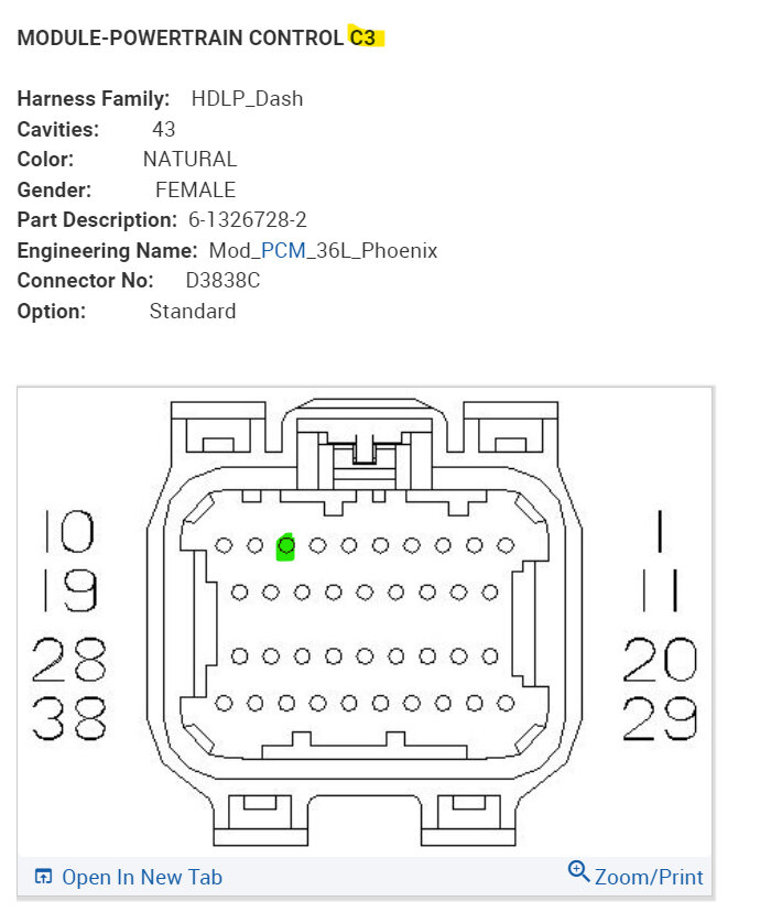

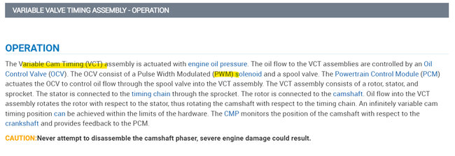

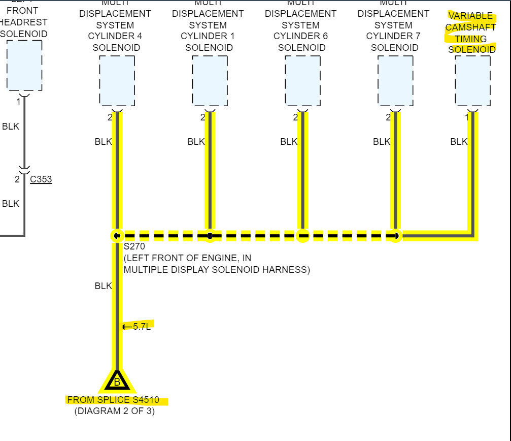

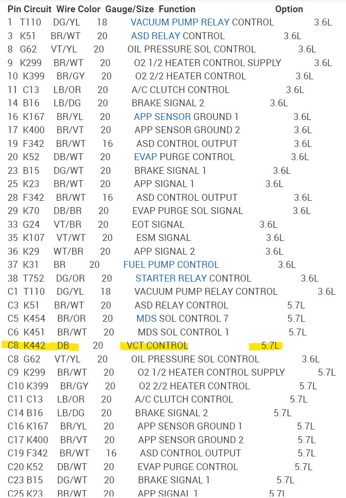

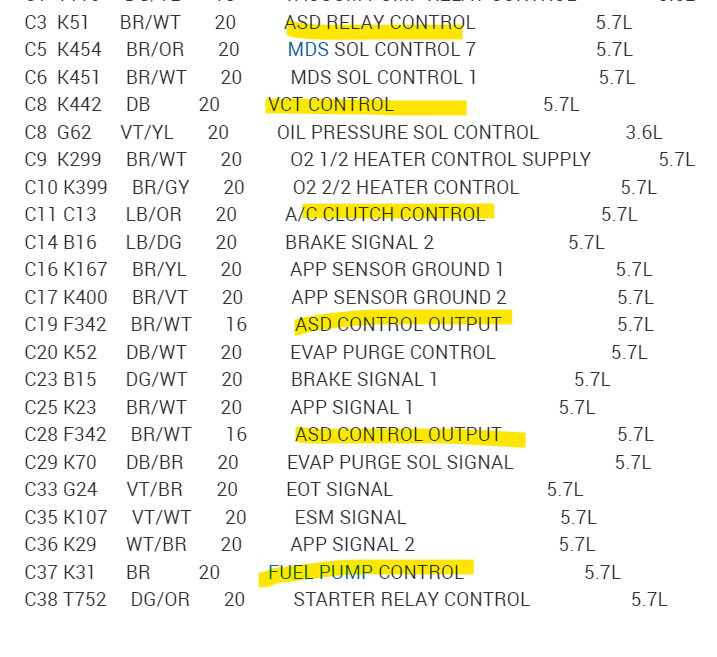

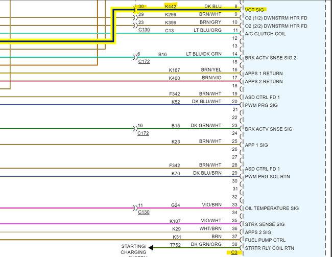

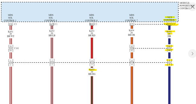

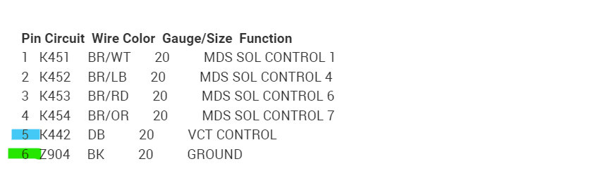

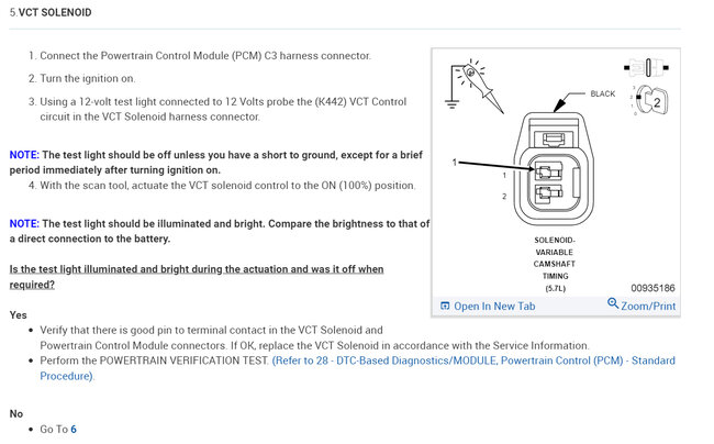

Okay, ECM connector C3 pin 8 (dark blue wire) is the Solenoid control wire. I've added the other ECM connectors so you can find C3 easier, C1 is black, C2 is orange, C3 natural, C4 is green. Hopefully this service info is all correct.

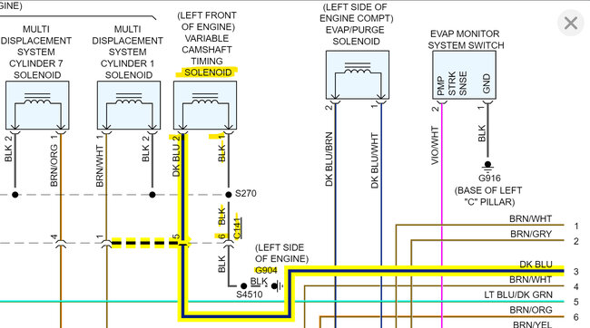

But you can see in diagram 3, the solenoid has a constant Ground and is power side switched by the ECM. Hopefully they put a resistor inside the ECM to protect it from shorts to Ground but knowing Jeep they probably didn't. The 4th diagram shows the C3 connector pin 8 VCT SIG, there is that K442 connector and I also saw a C141 connector on diagram 3. I will see if I can locate that. But as for circuit testing, with the key Off, you can follow the flow chart and unplug C3 and check with your meter on Ohms setting for any continuity to Ground with the Solenoid unplugged. That will eliminate the ECM and solenoid for now and concentrate on the wiring alone to begin with. There is a key on test on Flow chart number 2. With this being a 2-wire circuit, it shouldn't be too difficult to trace down any other problem areas, I will post that C141 if its listed in service info for you.

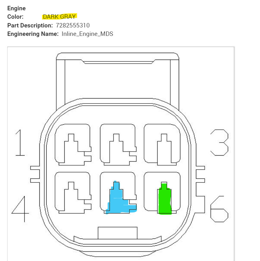

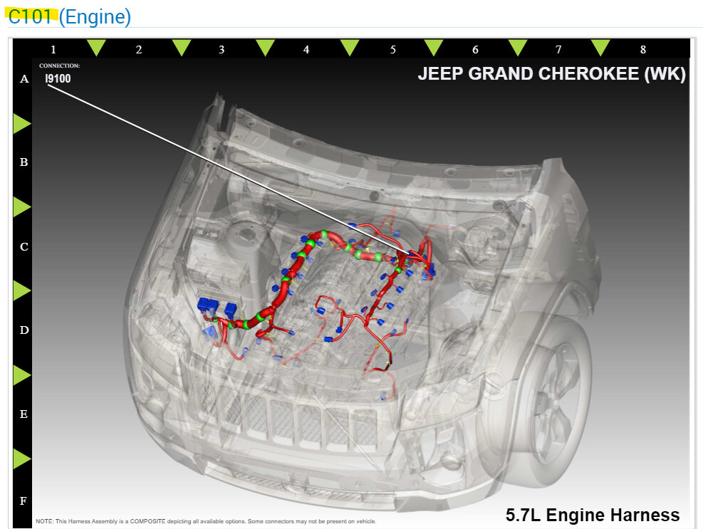

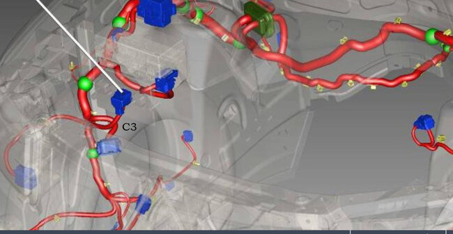

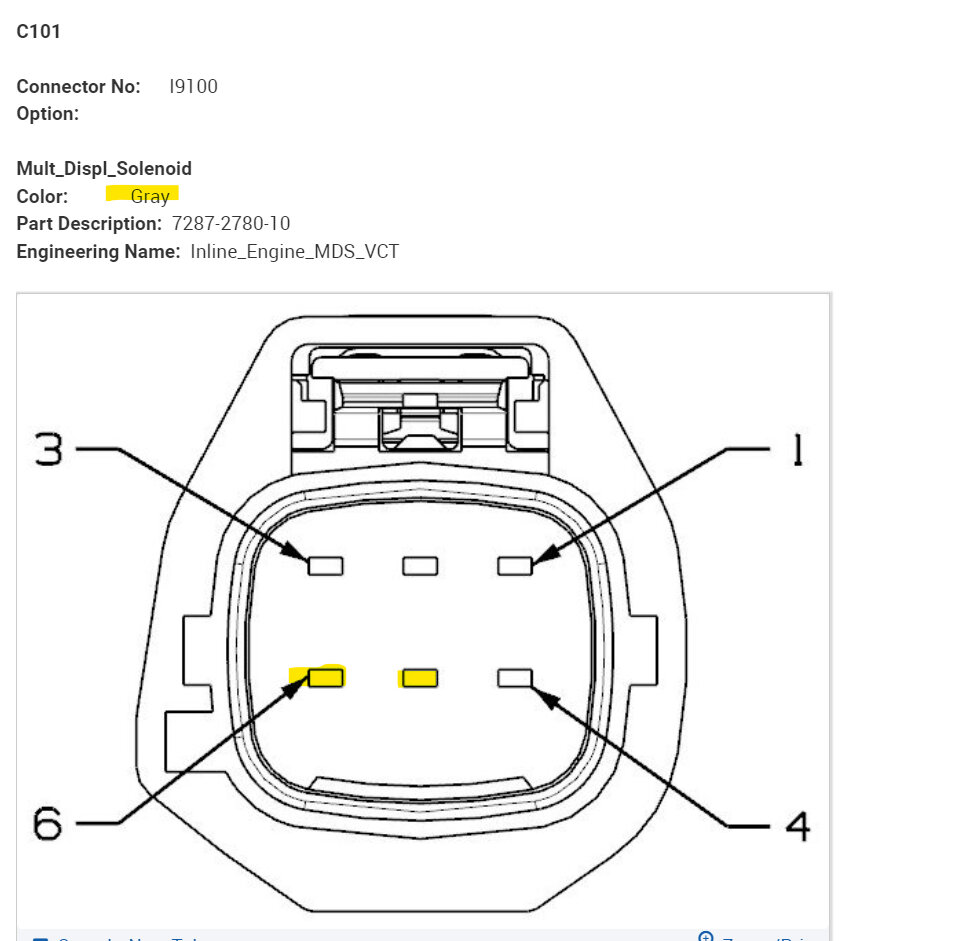

I've added OEM diagrams 10 and 11 for you because I don't see a C141 connector listed.
Okay, they don't have this connector listed by C141, I know this is confusing, but they have it listed by circuit number,
Diagram 12 shows its location (C101) and diagrams 13,14 are one half of the connector,
and 15,16 are the other half of the connector.
They should be grey and dark grey in color, 6 pins, it's an inline connector that both the wires for the Solenoid run through. Still a dark blue wire (pin 5), and the Ground is black (pin 6).

I'm still unsure how to identify the PCM connectors. So, if I unplug them and look on the inside, they'll have color's or??
The outside of the housing is all black on all four. If the above is correct, when unplugged, the inside of C1 will have a black gromet and C2 will have an orange gromet etc...?

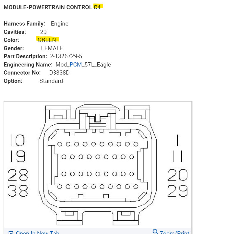

Each PCM connector itself should be a different color, but it might be referring to an inside grommet. I'm just going by the service information I have available. C3 should be the 3rd from the left I believe anyway, but you can verify C3 by checking some of the wiring colors if you're unsure. For example, pin C1 is a dark green wire with a yellow stripe.
The cam sensor issue you're thinking of is a cam/crank variation relearn procedure. That would need to be done if you replaced components, and the ECM needed to relearn the new positions of camshafts, crankshaft sensors, valve train parts, for example.
You're just going to be unplugging the one connector to verify there are no shorts to Ground or power that you can't see, instead of pulling the entire harness apart, you can do end to end testing and save a ton of time and headache. Since its really only going to be that one wire that controls the solenoid, you'll just be testing from the solenoid plug to the ECM plug. The Flow Chart should be very accurate. Sometimes they tend to have you doing tests that you may have covered already, because the flow charts are designed by engineers, not technicians. Some techs will do loaded voltage drop testing, but since you've already found some wire missing insulation, you know it's a possibility at this point for there to be more of that. You can see from the picture of C101, just about where the entire harness area you'll be needing to check is. From the back of the engine on the driver side to the ECM, I will also see if I can find this Ground location G904 if you have not already found it.
And that color for C3 being "natural", I'm sure is some tan type of color. And on the pinout sheet for C3 take note of where it says 5.7 Liter vs 3.6 Liter on the right side. If you want to post pictures of the rubber hoses you're referring to, that's fine.
May 29, 2023 at 3:35 AM
AL514
  • 5,668 POSTS

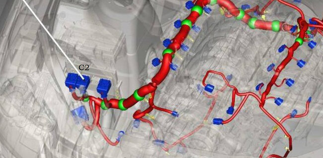

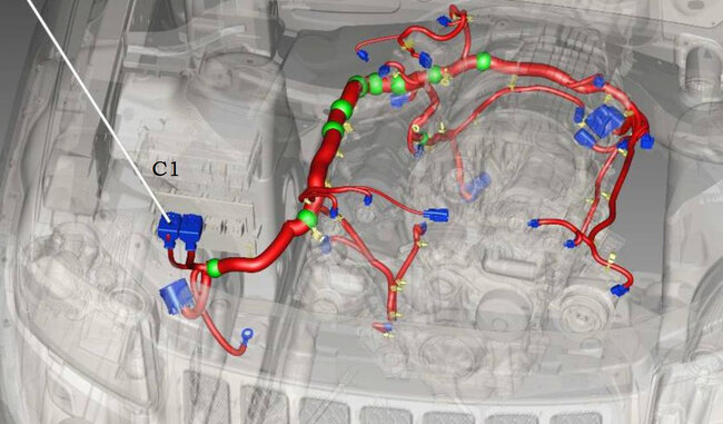

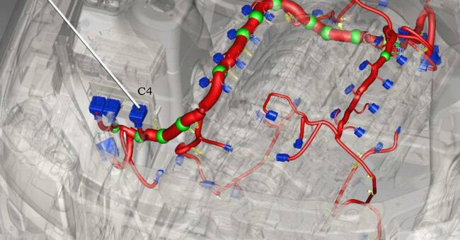

I want to make sure you these correct, do you have 4 ECM connectors or just 3? Some diagrams and pictures are showing the 5.7liter missing what looks like the 3rd connector over, but that might just be the service info.
This is what I'm seeing. Hopefully they're the same for you.

Yes, my PCM definitely has 4 plugins they appear to be symmetrical to each other and the body/housing is all black on all 4. I will unplug one to check for color and compare. Then I’ll check for continuity up to the plug after verifying colors/pins.
May 29, 2023 at 5:02 AM
AL514
  • 5,668 POSTS
Okay, the 3rd over should be the one you want. And not sure if i asked, but what scan tool do you have access to? Just wondering if you can pull up live engine data PIDs

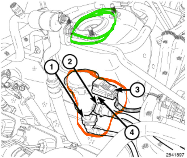

Here is the Ground location for the timing solenoid.

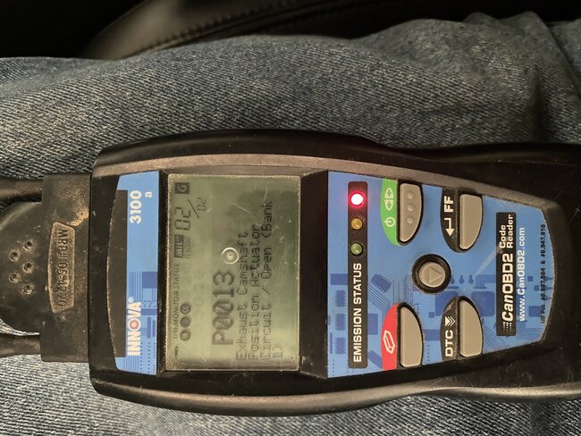

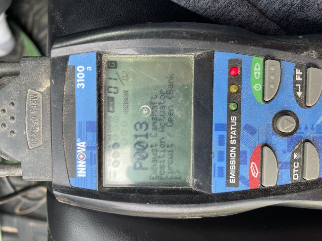

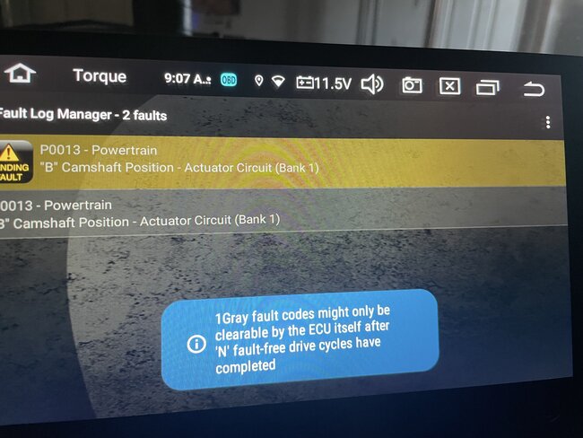

This is the reader and the code. The Jeep itself has a reader built into the stereo but cannot access it while it’s all powered down.
May 29, 2023 at 6:40 AM
AL514
  • 5,668 POSTS
I don't see live data on that scanner. Let's see what you come up with during the harness testing.

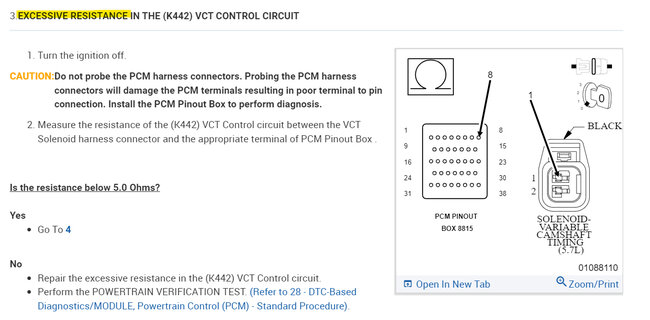

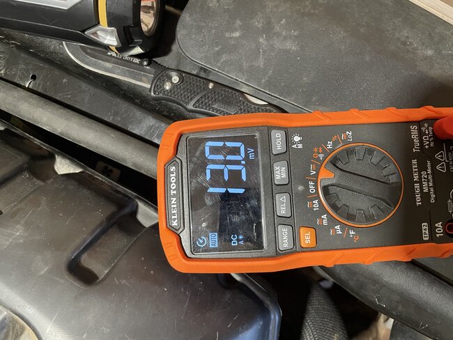

Update: I ran the continuity test on both the blue and black from the solenoid end to the PCM plugin and to the shock bolt/ground as well as between the two at each end. Both wires have continuity but not between each other, although on the PCM plugin I couldn’t get continuity, I don’t know if my needle is long enough to make contact or if that pin is borked, so I needle probed the dark blue wire just below the plugin and got continuity. The new jumper harness will be delivered within the next hour. I will then replace the jumper and the solenoid, buckle the intake manifold back down, plug everything back in, connect the positive then the negative on the battery, check oil level and add if needed, then push the button to run mode and clear the code, then push the button to off and start the car, hold rpm above 1k for 1 minute and pray it doesn’t come back.
May 30, 2023 at 3:21 AM
AL514
  • 5,668 POSTS
You couldn't get a reading from the pin side of the PCM connector? Can you see the pin inside the connector? I would be concerned that the C3 connector pin did back itself out somewhat, that could happen if that wire got hot. Possibly from those wires shorting out. So, if you can, verify that front pin, pin fitment issues can cause you to chase issues for a long time. With those connectors being hooked up for so many years of usage. And they get hot and cool down and that's how pins don't make contact anymore. And really you have no way to monitor the ECM data to see if the cam timing is changing. What you could do is to monitor that wire with your multimeter after you get everything back together. It's most likely going to be a pulse width modulated circuit, so you will see an average voltage with the multimeter and not a full 12volts all the time. If it's 50% duty cycle, 50 on 50 off, you would average 6ish volts because a meter can only average that voltage. If you were to scope that wire, you would see a 0v to 12volt square wave signal. That would vary depending on how much the ECM is changing the cam timing. But I would really check that ECM connector. With the testing you did on the solenoid, it sounds like it over heated and that's why you got those odd readings.
Solenoids are controlled by PWM to prevent them from overheating. I'd feel bad if that code came back after all the work you have done already. It's really great. Those ECM connectors do come apart if that pin has backed out. They take some time, and you have to be careful with them. Or you could try the pierce again on the dark blue wire and then right to the ECM pin to check continuity. That way at least you'll know that connector has a pin fitment issue.

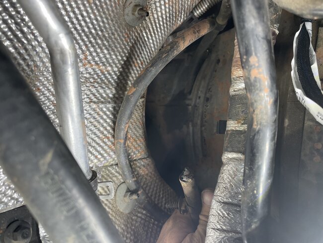

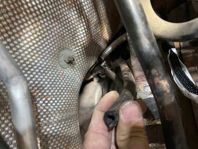

Okay, I have everything back together minus the battery cables. I took another look at the PCM plugin side and realized I should’ve been trying the 3rd from the left not the right. It’s a little bit late now but I installed the new solenoid and jumper harness. I plugged everything back in as far as I can tell, doing a double check as I type now.
Before I go any further, I’m wondering what you think my next steps should be.

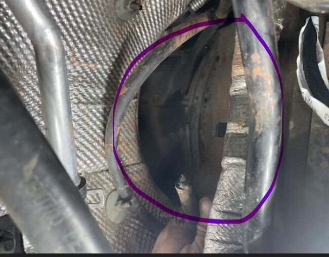

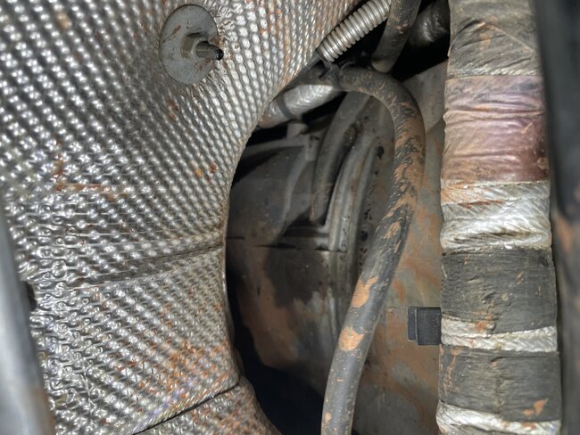

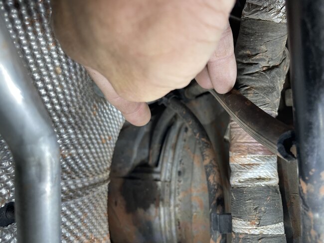

Also, here are the pictures of the rubber lines coming from the transmission that are messed up.
May 30, 2023 at 5:48 AM
AL514
  • 5,668 POSTS
I'm not sure what those lines are. I thought maybe at first it was some overflow type line, but it does look like there is a plug in that one end. I'll take a look on all data for any transmission diagrams. I'd say you can start it, let it get up to operating temperature and see if you notice anything abnormal happening. Ill post what I find on the transmission.
Also on your wire checking, there was the black wire grounded for the Solenoid.
I don't see those being any kind of transmission cooling lines, being rubber like that.

Yes, I checked the ground wire for continuity by probing the wire at the solenoid end and touching the strut/shock mount bolt. I will clear the code and start it now.

Is this the transmission bell housing?
May 30, 2023 at 6:58 AM
LEPRIKAAN
  • 29 POSTS
Yes, it is.

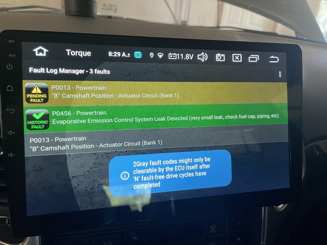

I cleared the code, and the light comes back with the same code. I’m going to let it get warmed up to operating temperature which I would assume is about 200, 210, and see what happens. I’ll post back ASAP.
May 30, 2023 at 7:05 AM
AL514
  • 5,668 POSTS
Still P0013? This isn't a Natural Gas vehicle, is it? You can try your pierce tool and clear the code, have a test light or multimeter hooked up to the dark blue wire right at the PCM and start the vehicle, see if you're getting any voltage out of that wire. But you will have to do this quickly, once the code is set it will probably disable that circuit. Being that it is a circuit code, there is a voltage issue somewhere. We need to know if there's any voltage coming out of the ECM to command that solenoid.

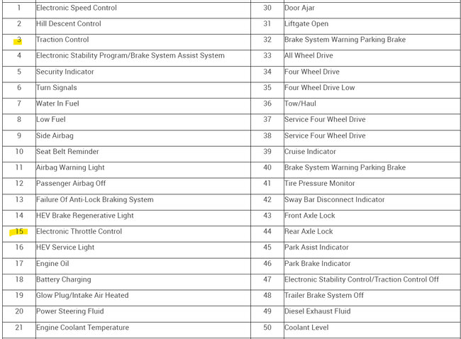

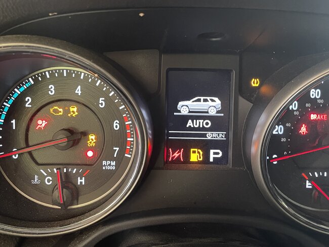

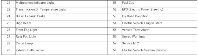

I also see this lightning symbol in the dash, it blinks about 3 times then goes away.
May 30, 2023 at 7:52 AM

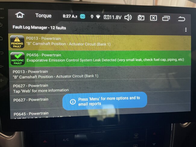

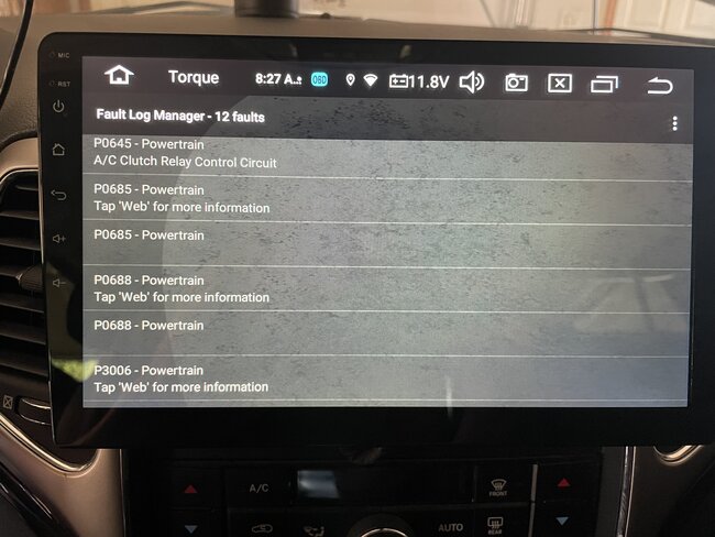

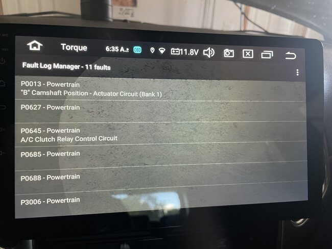

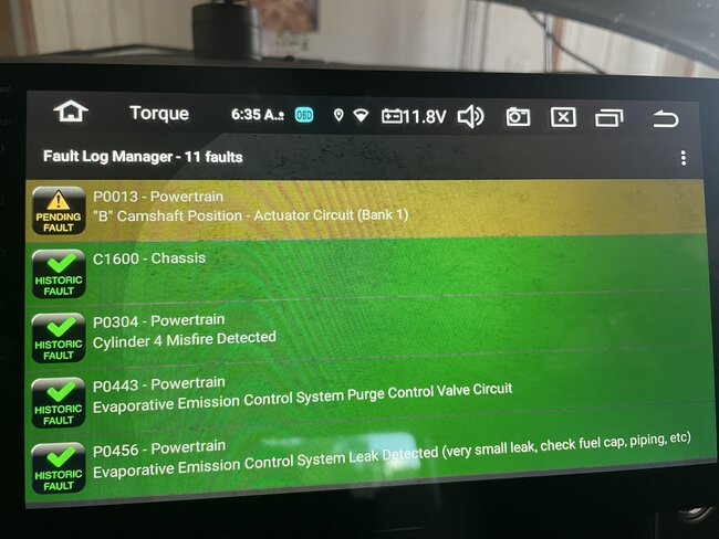

You have 11 codes set now?
May 30, 2023 at 7:57 AM
LEPRIKAAN
  • 29 POSTS
The Innova code reader only shows the 1 code, P0013. The Torque app shows those other codes and the orange is pending, the green I assume are ok because the check mark and the grey it says will be cleared with so many Drive cycles.
May 30, 2023 at 8:04 AM
AL514
  • 5,668 POSTS

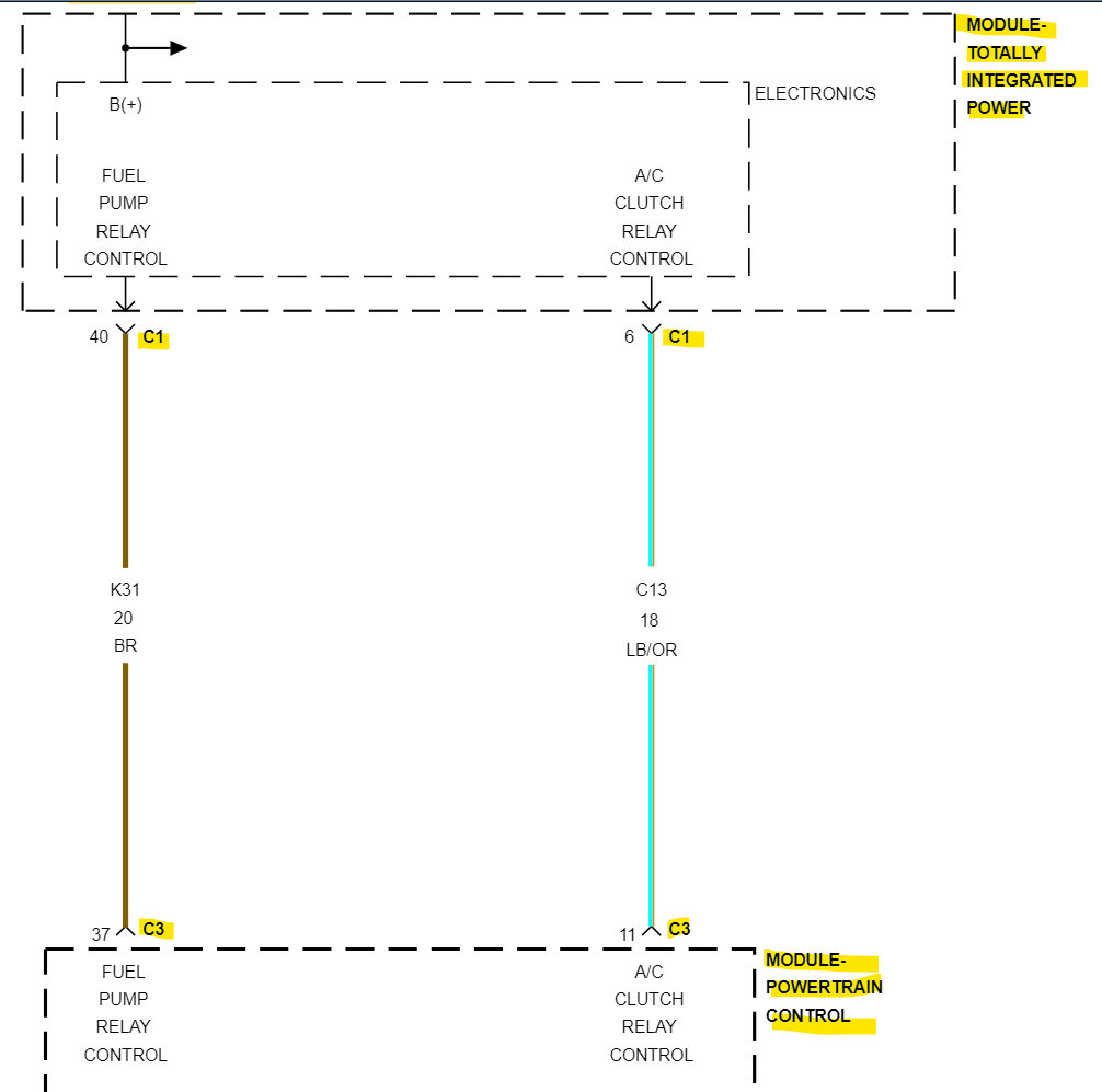

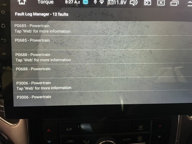

Well, with the stalling now, I think i know what's going on, I looked up 4 of these codes, P0627 Fuel Pump A Control Circuit open
P0645 AC Clutch Relay Control Circuit open
P0685 PCM Power Relay Control Circuit open - This I assume is the ASD Relay
P0688 PCM Power Relay Sense Circuit open
But all these components- Control circuits are in the PCM C3 connector.
But also, PCM C3 goes to C1 of the TIPM (2nd diagram). I'm not sure if you had unplugged any of the TIPM connectors, but this might be a connector issue since these problems were not there as far as we know before the repair

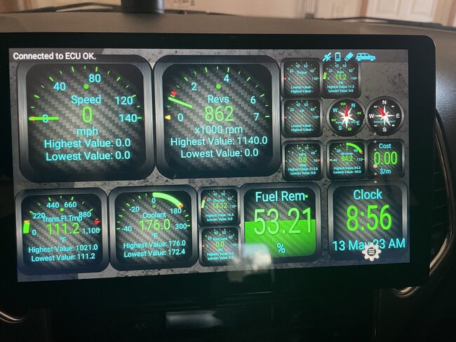

I would stick with the Torque scan tool for now, I think Torque also has live data. Are you using the ELM 327 with the data link connector?
Looks like Electronic Throttle control.

The TIPM is more like a smart junction fuse panel, it has canbus data network circuits and works with the PCM. I dent like a 30volt spike, it's possible that is due to the solenoid transient shut off voltage. But I think the stall out issue has more to do with these codes, try clearing them all, and check that C3 is connected fully. These TIPM connectors look to be on the underside of the module, if you can see in the diagrams 1,2 below. I'm not sure how much those connectors got moved around during testing. After you clear the codes and check the connectors, let's see which codes come back first. It's clear the ASD Relay is powering down, that's powering down the PCM, and it's a domino effect of power loss. Hopefully this is just a connector pin issue. Diagnosing a failed TIPM is going to be very difficult.
There is a recall on the Fuel pump relay inside the TIPM failing causing a stall condition, but that doesn't make much sense since the vehicle ran before the solenoid replacement

I opened the torque app and got these codes in images one through three. I cleared the codes, and the app said some vehicles require immediate start when the clear command sent. So as soon as I saw the clear command, I started the engine and waited for the check engine light. When the check engine light came on I ran a fresh skin and got these codes in image four.
May 30, 2023 at 10:03 AM
AL514
  • 5,668 POSTS
Battery voltage looks too low in these scans, did it stall out or are these scans just key on engine off? These PCM power relay codes 685, 688 are the concerning point, for some reason the ECM or TIPM is shutting down the ASD relay and then the PCM is detecting that power failure (p0688 power relay sense circuit). You might try shutting everything down, unplug your scan tools and unhook the battery negative for a few minutes and see what happens. If your battery has a battery current sensor on the negative post make sure not to over tighten the clamp. Some of the TIPMs fuses might be encased and need a close look at to verify they aren't burnt. Can you reach the cam timing solenoid you replaced? or is that under the intake? This has to be some kind of connection issue.
This vehicle has a wireless ignition node (module), maybe that scan tool is interfering with some communications on the data link connector.

The scans are with engine off and ignition in run. The car is stalling out too soon to complete a scan with it running. On my first running test it ran for about 15 minutes before shut down. I can’t reach the solenoid, it is under the intake. I don’t see any kind of sensor on the cable or post of the battery. What do you mean the fuse might be encased? And what fuses should I be looking for? On another scan just now the 11 codes are up again. I will disconnect the negative cable for a few minutes and try clearing codes again, restart the engine and wait for the CEL, run the scan again and post the results.

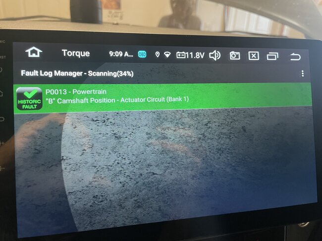

Here is the results after removing the negative battery cable. I ran a scan right after reconnecting the negative cable and it’s the first picture. I cleared the codes and started the car and this is the result in the second picture. The third picture is the live data screen. I never had any kind of issue until the alternator problem. No security issues either.
I was suggested to look at the CMP sensor and it’s harness as well, I have looked at its physical location and it’s in the front of the engine in the right side of the timing case. I unplugged the wire from the CMP to look for damage, I found none so I plugged it back in. Could the CPM or its harness be the culprit or part of it?.
Is it possible to change the CMP sensor without having to have the computers relearn with a diagnostic tool?
May 30, 2023 at 11:36 AM
AL514
  • 5,668 POSTS
So, you're not getting any of the other codes you had on earlier scans? And yes, I was going to mention the cam sensor, but that was kind of useless at the point where it wouldn't run. Another possibility is that those wires shorted out and took out the ECM driver for the cam timing solenoid. I have seen Jeep ECMs take out drivers many times because of circuit design like this., If you do try a cam sensor, you'll have to do a cam/crank relearn procedure. But since this is a circuit code, you can try a new cam sensor and see if that specific code comes back (p0013). Since you don't have a scan tool with special functions right now, there is no way to do a crank relearn. But since the beginning of this, especially with the alternator issue, I was worried about that ECM driver, but you did have voltage there in the after the repair. Does the vehicle run now without stalling?

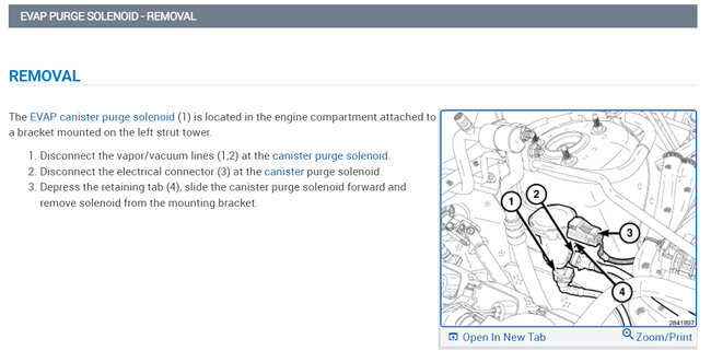

It depends on the condition of the alternator, but what initially happened with the old alternator could have potentially damaged the TIPM, they are known for failure. The code that is setting is camshaft position actuator circuit open code, but we are limited here on options. You don't have a scope or any to monitor position sensors, this vehicle only has 1 cam position sensor. It's a 0 to 5volt three wire sensor, so it's a hall effect sensor that will make 0-5volt square wave signals to the ECM in time with the crank position sensor. Since its still stalling out you can try blocking off the Purge valve and see if that will stop the stalling, You do have the historic Evap code, If there is a vacuum leak through the evap system, and the Purge valve is still being turned on, that might account for the stalling and it worth a try, I'm pulling its location right now, give me a sec.
In the 2nd diagram in Green is the strut tower on the driver side, and the Purge Valve is what the ECM uses to pull vapors into the intake manifold. You can try unplugging it first (electrical connector), and if it still stalls you can take a line off coming to the purge valve and block it off, this is just a shot in the dark. But technically the engine could start purging the tank a few minutes after start up.
Next, we would just have to try a cam sensor,
May 31, 2023 at 2:59 AM

I’ll try the purge and see it it helps keep it running longer than the warm-up. I’m not sure about changing out the cam sensor as I don’t have access to the computer for relearning.
That voltage does seem low so I could put a multi meter to the alternator to test that. I did multi meter the battery and it was at 12.2 V not connected. I didn’t test it again after I started the car.
After connecting the battery, put the ignition in run mode and did a scan on the codes came back with only one fault code in the first picture, I cleared the code and started the car, and the cel came back, so I did another scan with it running, and it came back with only the one code in the second picture.
I’ll post back with results of testing the purge system.

I haven’t seen any warning lights other than the CEL and the lightning bolt when the ignition is in the run position. When it stalls, it just goes flat. No bells or lights, rpm’s just drop to 0 and the engine is off by the time the tach hits bottom.
May 31, 2023 at 6:50 AM
AL514
  • 5,668 POSTS

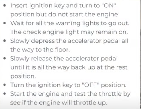

Okay, no worries, hope everything is okay. Glad you mentioned the Electronic Throttle control warning light, I wonder if the vehicle lost its learned idle speed memory with the battery being disconnected. chat with you tomorrow,
I do think it might need an Idle Relearn procedure done with that light coming on. Granted there is still something going on with the cam timing solenoid circuit. But we need to get this thing to idle at least for you. The only way to read any of the TIPM data is with a capable scan tool that can read into more than just the engine computer. There are so many modules on modern vehicles you wouldn't believe it. I had a couple of guys suggest checking the charging system while running, make sure it's up to 13-14volt range. If it's an idle relearn issue, since the throttle plate movement is how the idle is controlled now, no more idle air valves anymore, if you can put your foot on the gas and see if you can keep the throttle plates open enough to keep an idle, we would have an idea of what's going on. So, check that, the charging system voltage, possibly unplug the Purge valve, see what you come up with. If there's a low charging system voltage, the ECM might try to raise the idle for that reason, or cold engine as well.
This a manual Throttle Relearn procedure for a Chrysler, I don't know if this will work in your situation, but anything is worth a try right now.
This is the video from that, he waits until the check engine light starts to blink, and then tries the relearn with the gas pedal, so watch the video first, I will post any further info I come across.
https://www.youtube.com/watch?v=uf5Cg5SyrJ8
