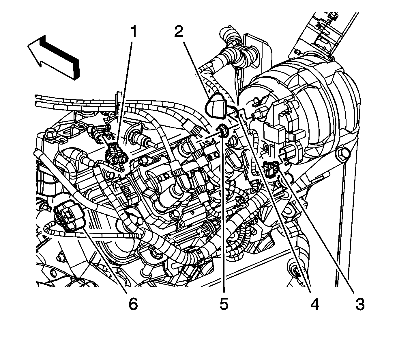

if you remove the positive batter cable and the car shuts off. is that a bad alternator?
Apr 25, 2019 at 11:17 AM
  • 110,248 POSTS
Welcome to 2CarPros.
No, you are opening the circuit and most likely it will stall. I will tell disconnecting the battery with the engine running can damage the alternator. Here is a link that shows how to test an alternator. If requires the use of a volt meter or multi meter.
Here is a link that shows how to use a volt meter/multi meter:
Do this and let me know what you find. Also, if you get a chance, describe the symptoms.

Removal Procedure
picture 1
1. Disconnect the negative battery cable.
2. Remove the drive belt.
3. Reposition the protective boot (2) from the generator output BAT terminal.
4. Remove the generator output BAT terminal nut (5).
5. Remove the engine harness terminal (4) from the generator.
6. Disconnect the generator electrical connector (3).

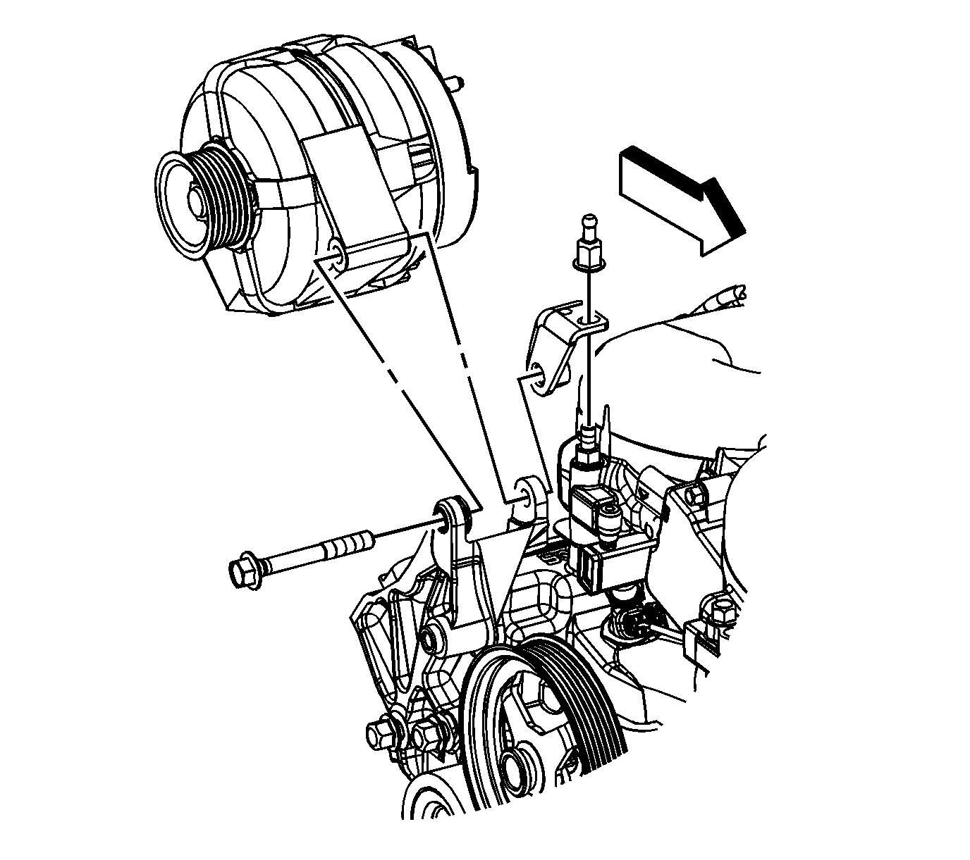

picture 2
7. Remove the generator bolt and stud.

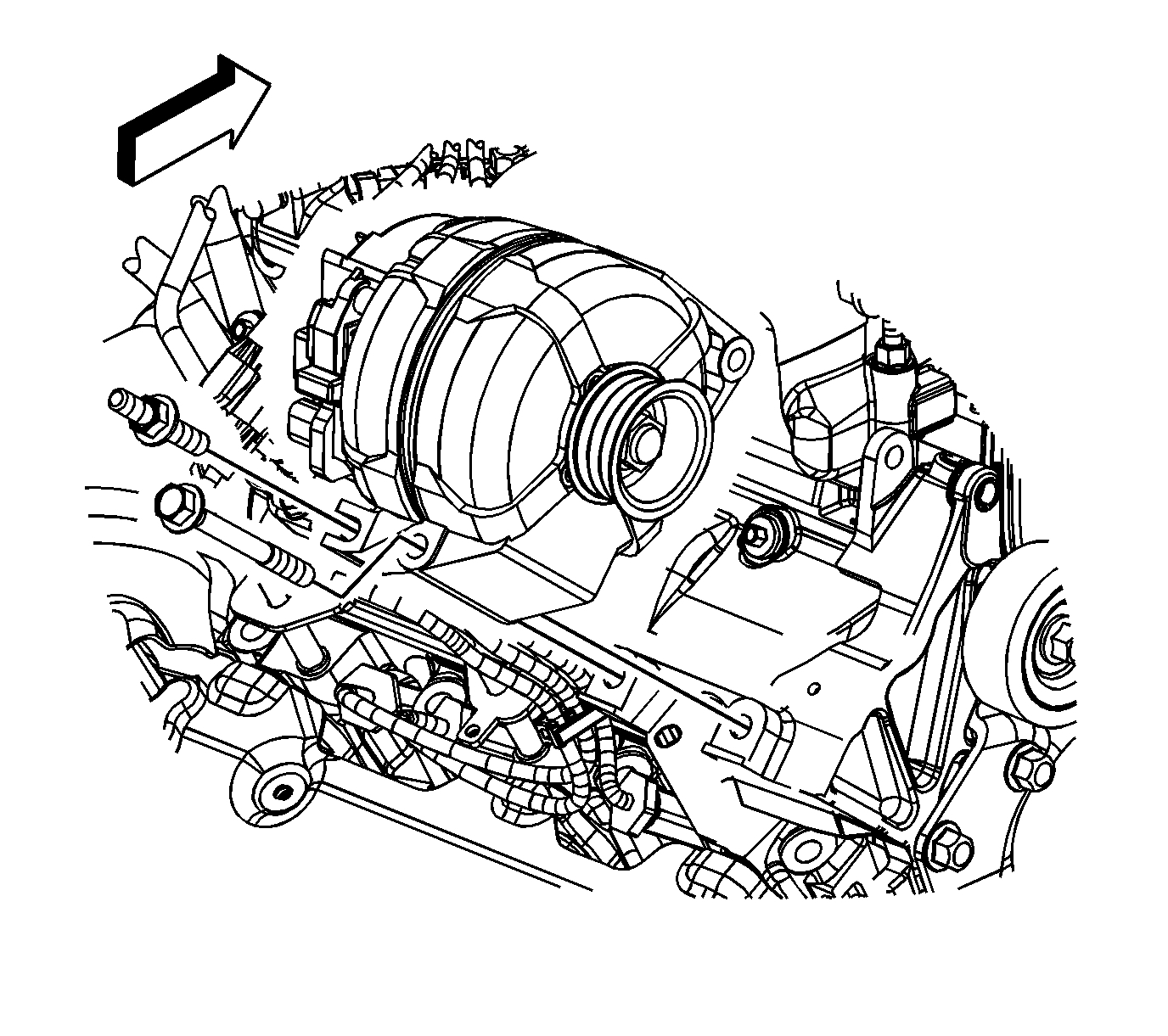

picture 3
8. Remove the generator bolt.
9. Remove the generator.
