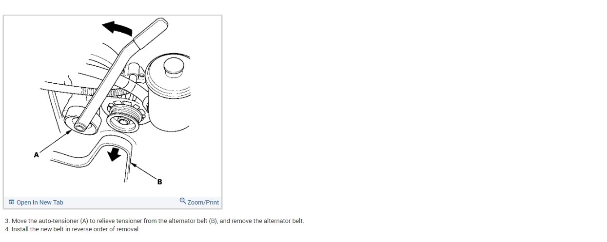

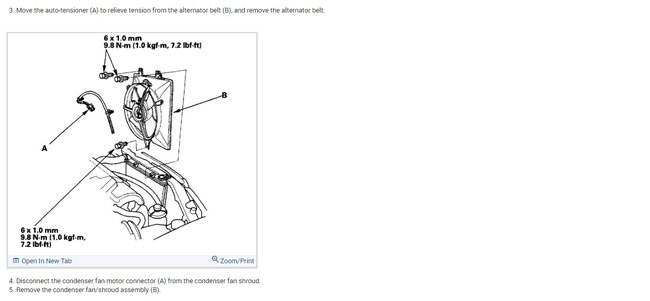

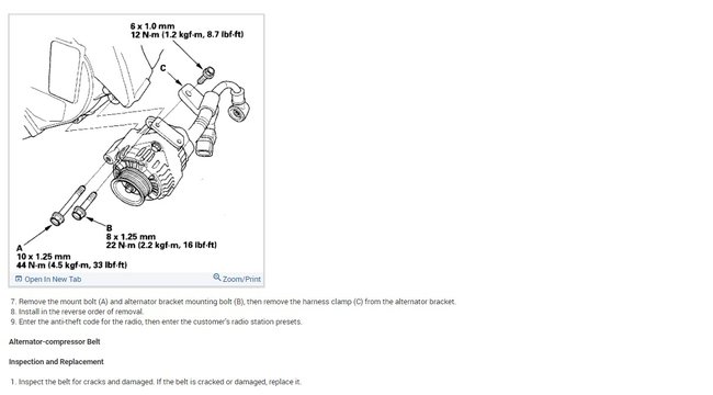

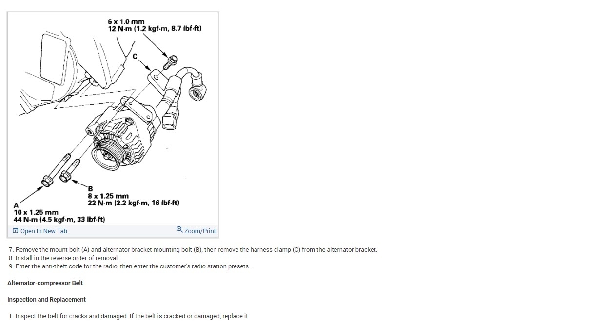

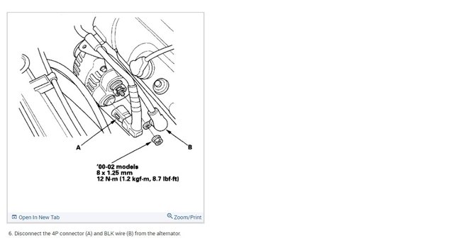

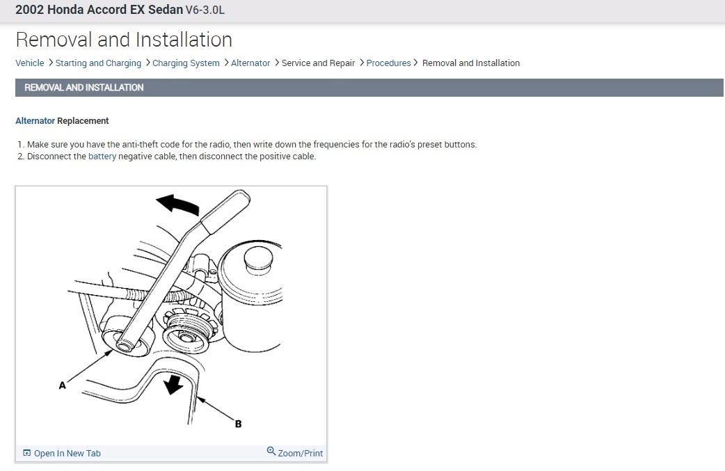

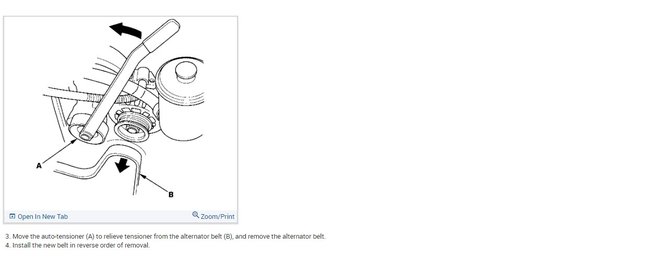

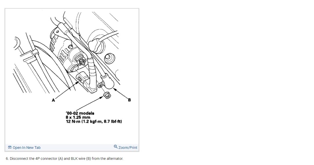

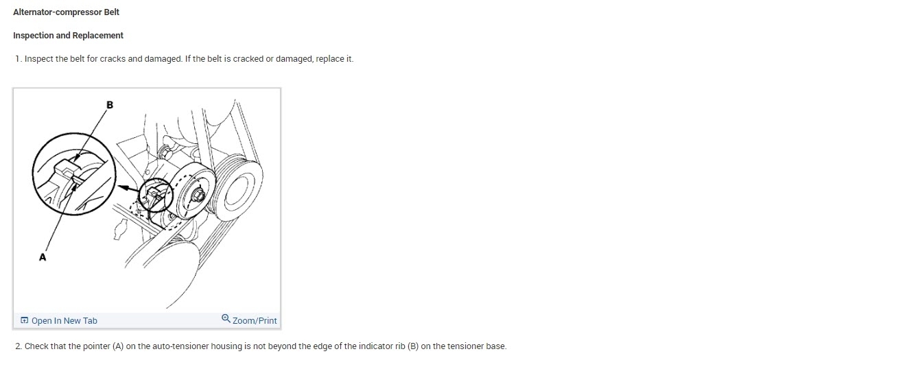

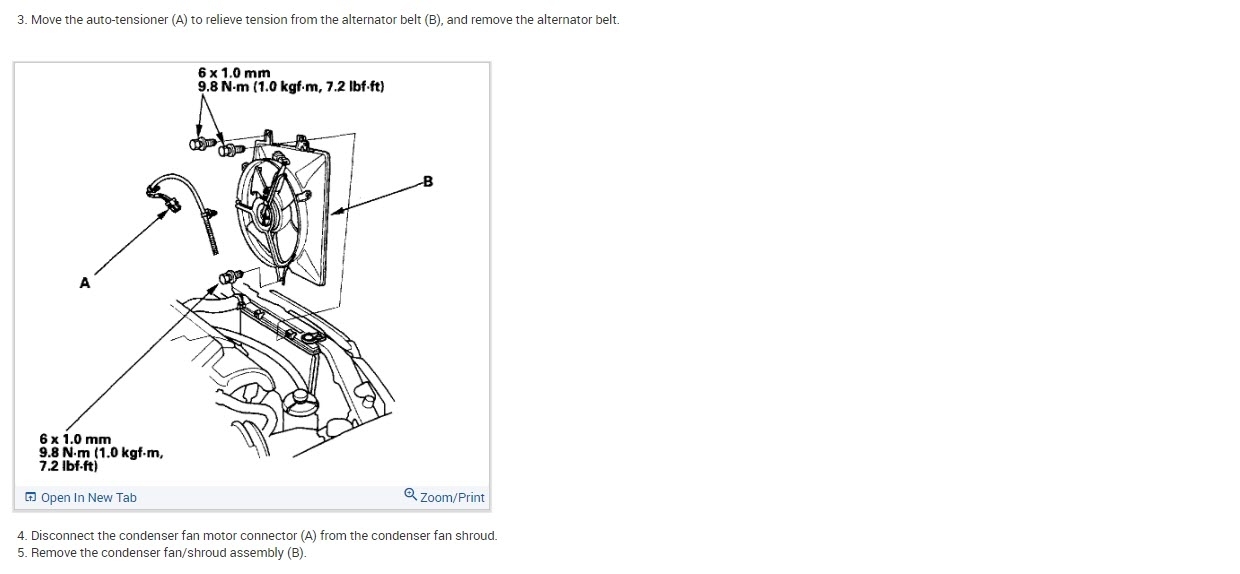

lights blinking spitting and sputtering dim lights etc. beginners instructions on how to replace and put on a alternator.
Oct 28, 2020 at 11:10 PM
BMDOUBLE
  • 1,139 POSTS
I've included some instructions on how to replace the alternator with a guide to help walk you through the steps. Also check the connections at the battery.
https://www.2carpros.com/articles/how-to-replace-an-alternator
