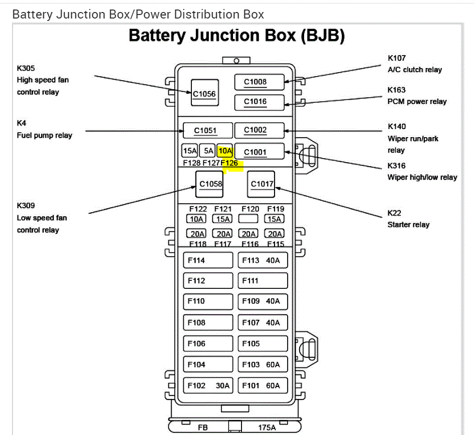

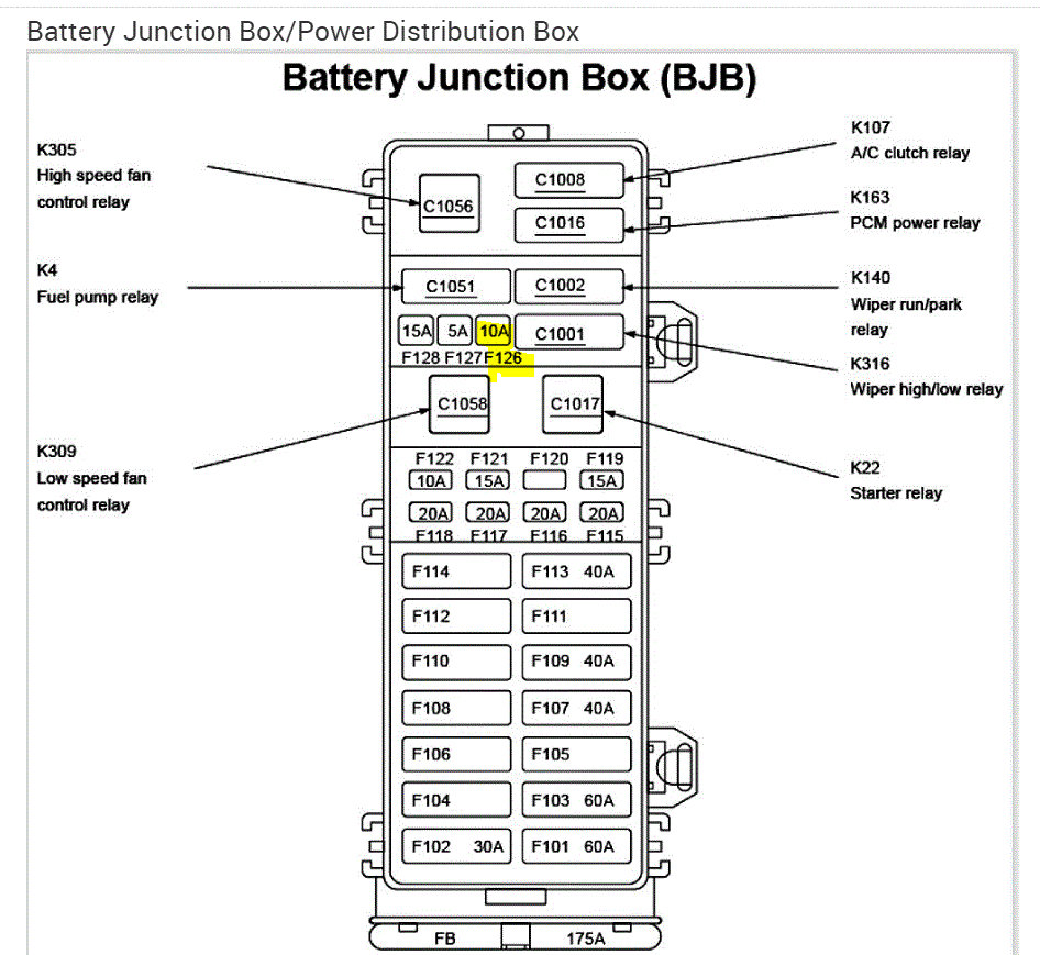

This doesn't sound good. LOL I need you to do me a favor. First, I want you to check a fuse related to the alternator. Now, in addition to checking the condition of the fuse, I need you to confirm power is present to and from the fuse. You could have a good fuse, but a heavy-duty fuse upstream from the one being checked may have failed.

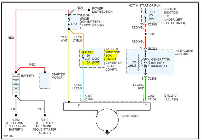

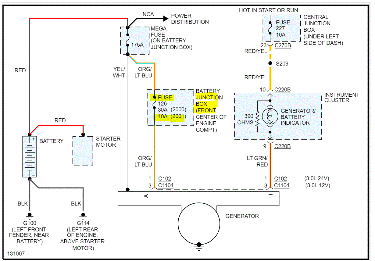

If you look below, I attached the wiring schematic for the charging system. I want you to check fuse 126 in the battery junction block. Again, confirming power to it is as important as the fuse itself.
Let me know. Also, if you have already checked the fuses related to the windows and cluster, check them for power as well.
Let me know what you find. Also, I need to know if the other non-functional items have power or not so I can look through the power distribution schematics.

Hey Joe, I did as you said, and I do have power to the fuse for the alternator but not the windows. I made a diy fuse link and the alternator is charging, however now I'm wondering if that is safe and if so, how can I direct the power to everything else? Also, I believe I have a coolant leak. Can you help me on what part to replace or fix for that issue also? I really need help because I love the car, I just need to get these few things fixed.

Hey Joe, to respond, I did a diy ( do it yourself) fuse link where I ran a positive wire with fuse from the alternator to the battery and a negative wire from the alternator ground to the battery, it's charging now. Is this safe and can I run it to everything else?
