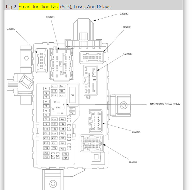

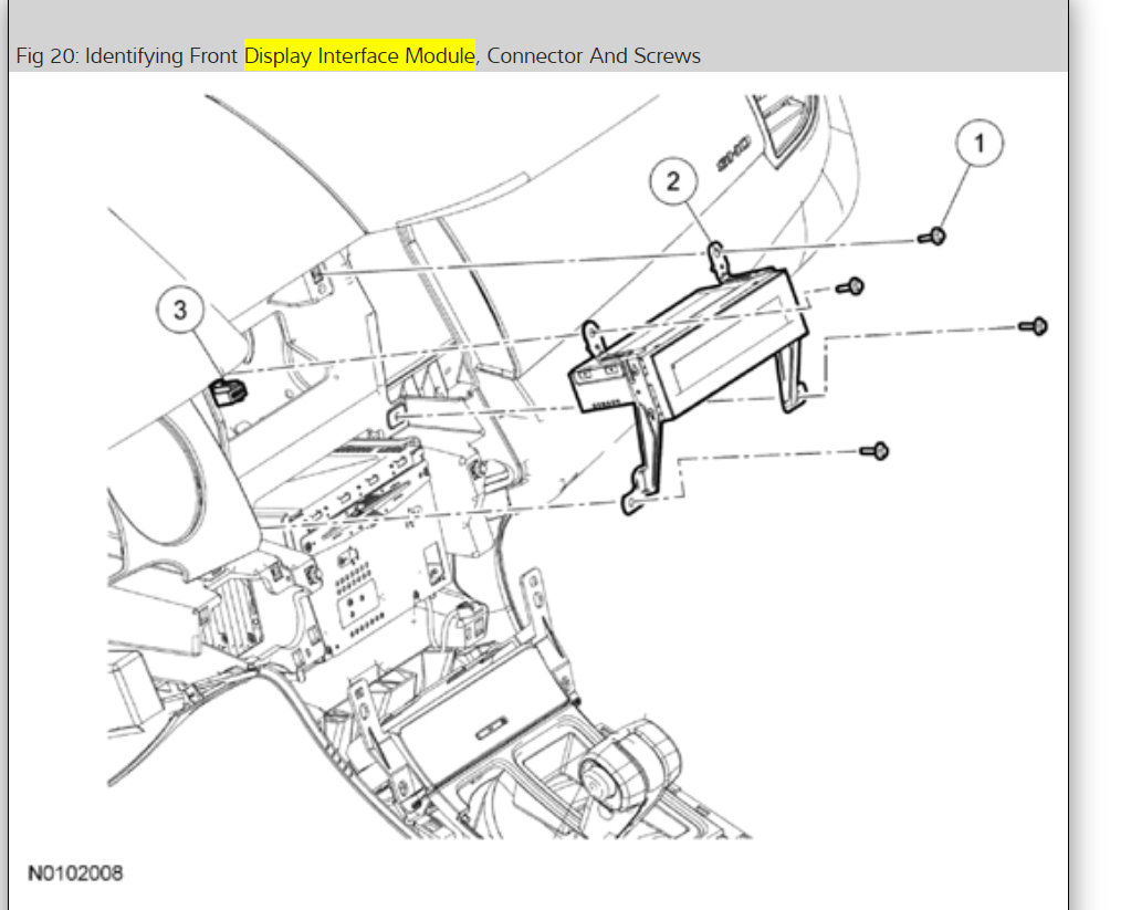

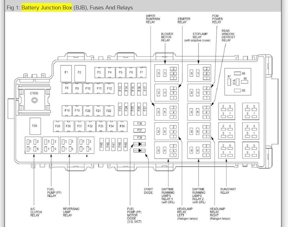

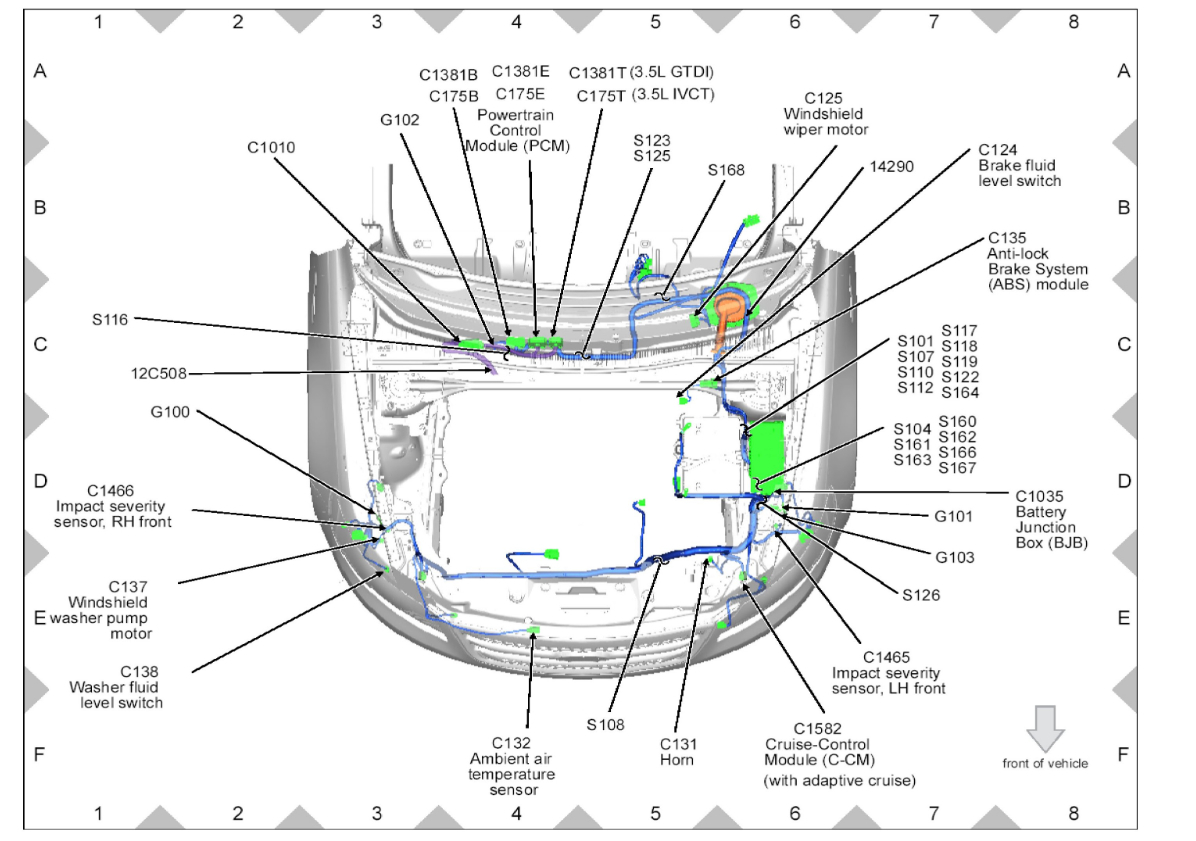

My climate control does not work, the radio does not work. I was told that my interface control module was bad.
Jul 23, 2016 at 2:36 PM
HMAC300
  • 48,601 POSTS

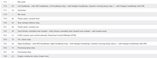

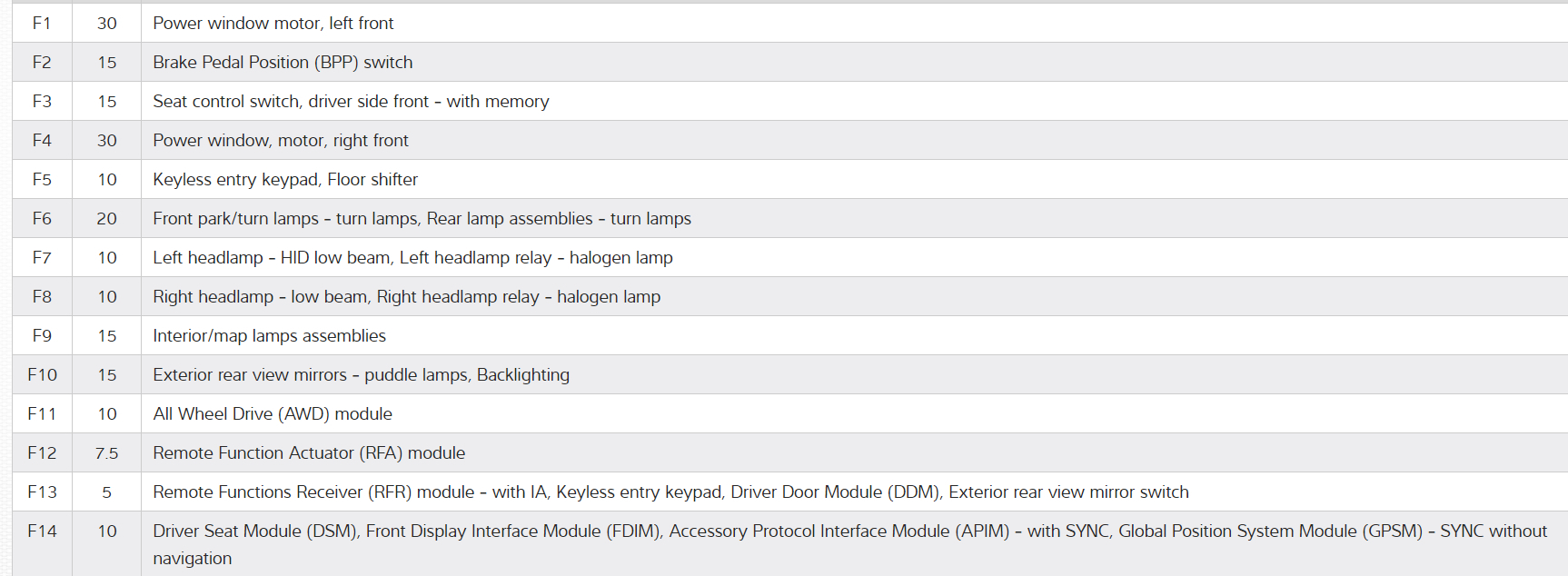

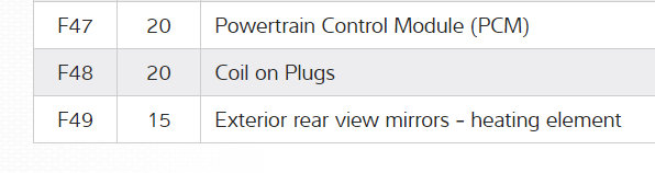

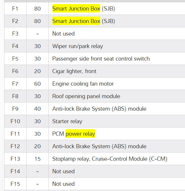

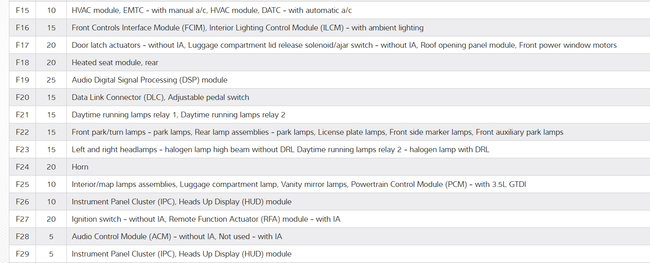

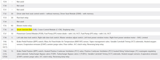

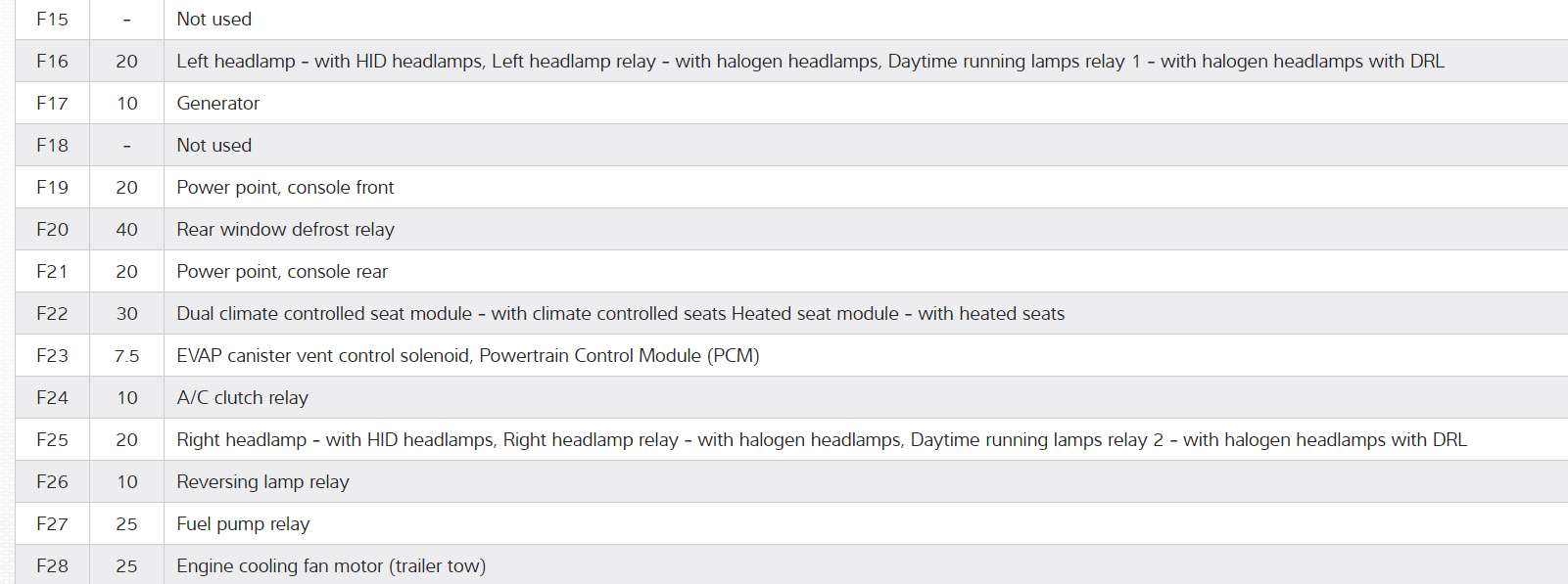

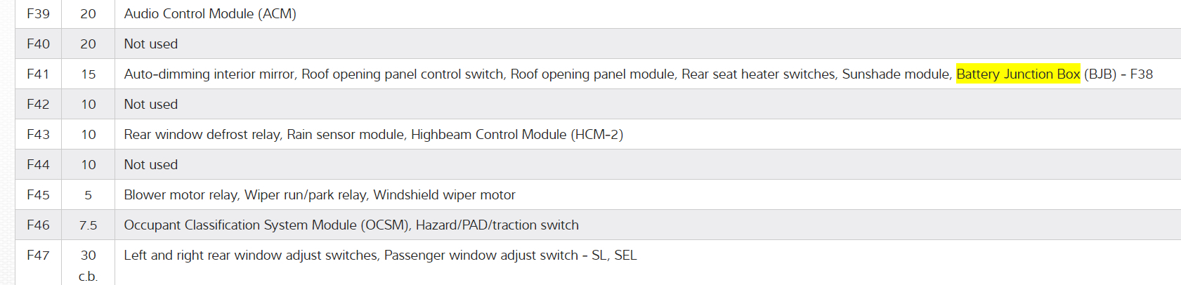

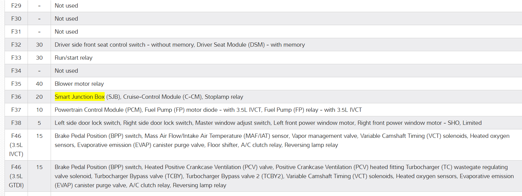

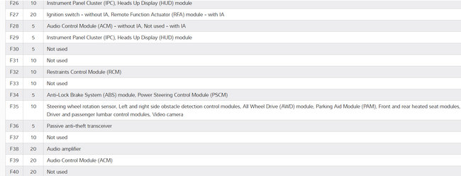

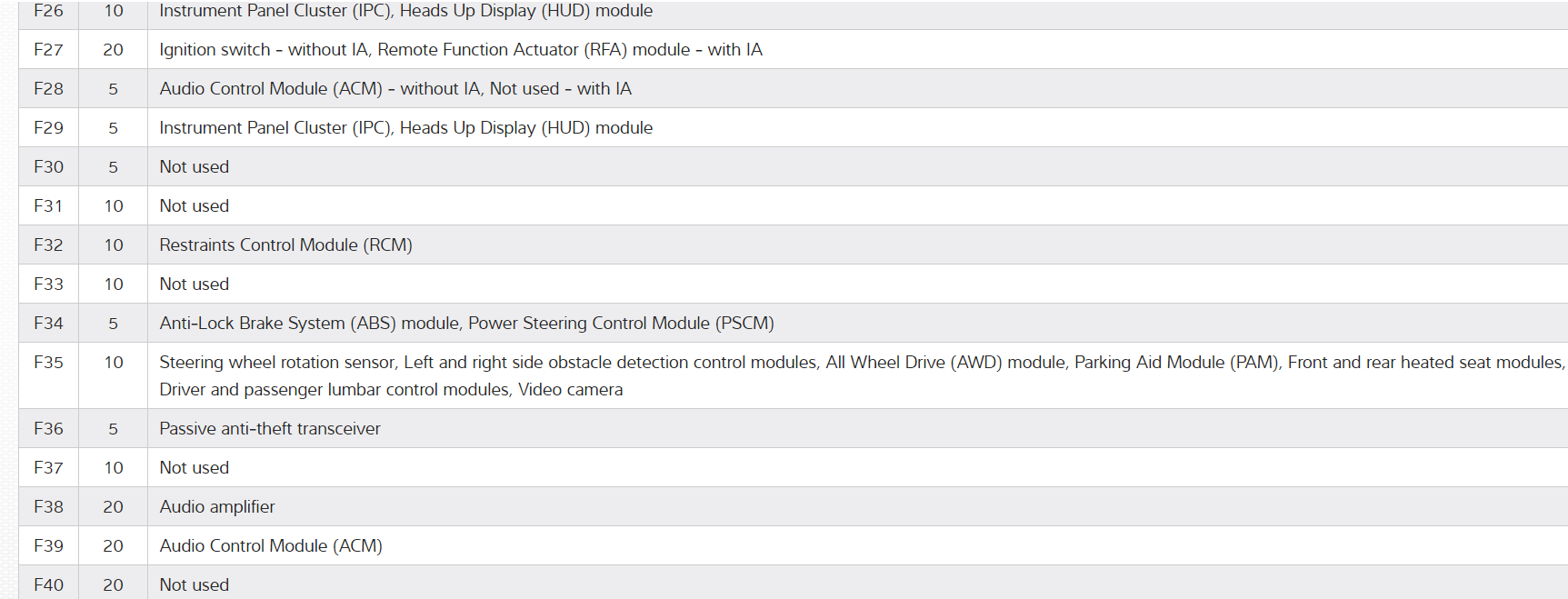

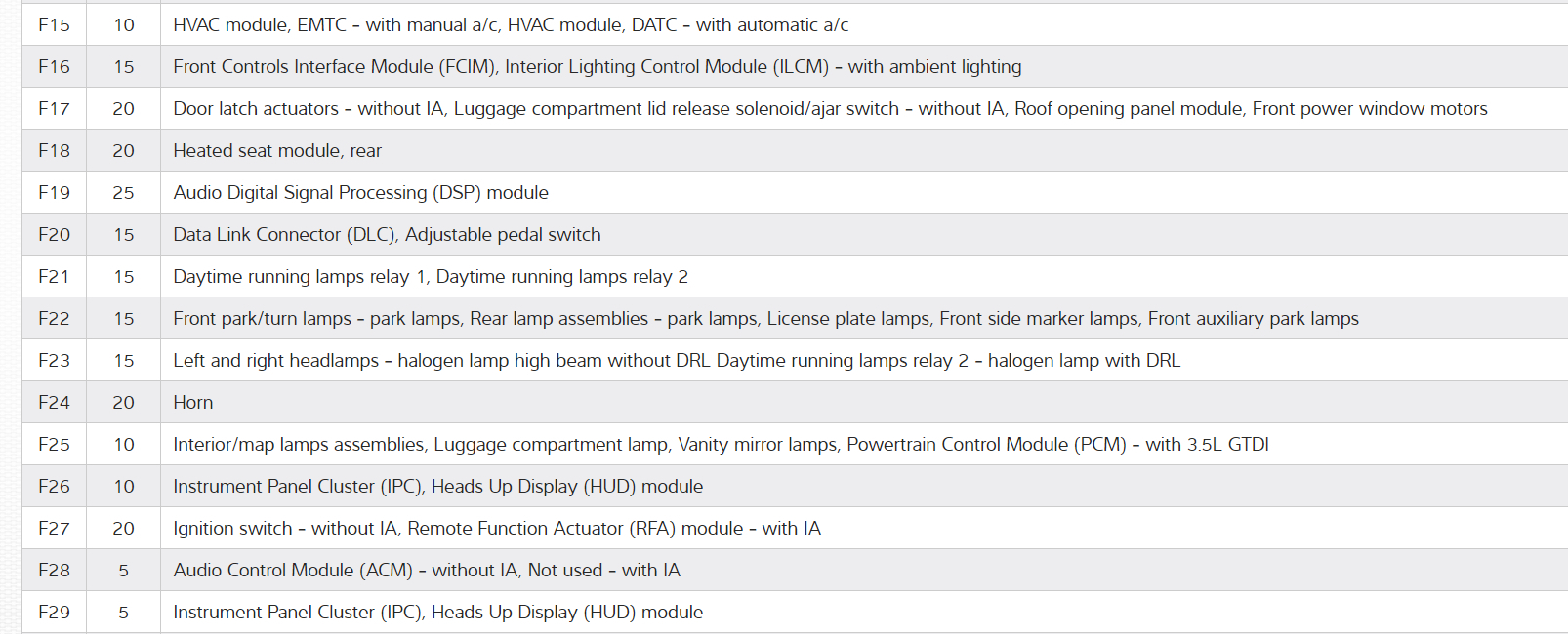

hopefully you have checked fuse #14 inside car left kick panel. if those are good here is the location of the interface module and how to change it out here is a guide that will help with the fuse locations and what the fuses are used for below.
