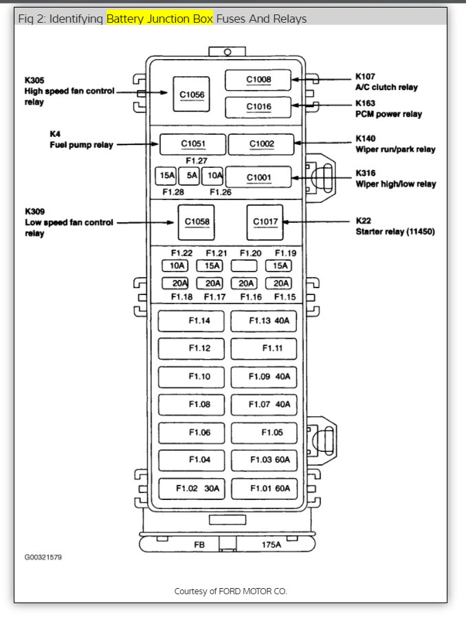

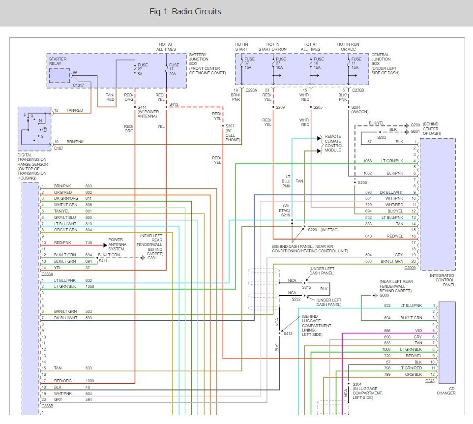

The battery in my Taurus will be dead after sitting for a day or two. I had the battery checked and they said it was bad. I bought a new one and after sitting over Thanksgiving (2 days), it was dead again. I took it to a shop for diagnostic tests and they didn't find anything abnormal until there was a "CALL" on the radio display and it started pulling down the battery. They told me it was some sort of phone service attached to my radio. They couldn't fix it, but removed the fuse for my radio. I haven't had problems since, but no radio. I would like to know where the fuse is?
Dec 8, 2008 at 5:46 PM
DAVE H
  • 13,383 POSTS
Here is a guide to help you test the fuse and the fuse location below with the radio wiring diagrams so you can see which fuses to test.

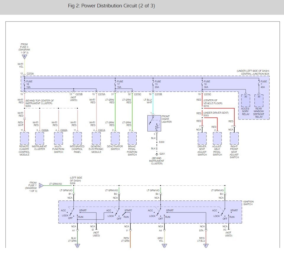

I have the same problem, i had a shortage on my 02' Ford Taurus and I replaced the alternator, that fixed the car and had it running once again, the problem was that both cigarette lighters do not work and my stereo doesn't turn on whatsoever, I have an aftermarket stereo. I checked all of the fuses you mentioned and they all look intact, none of them burned out or blown, any other guesses??

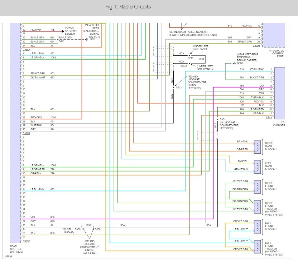

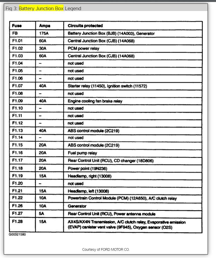

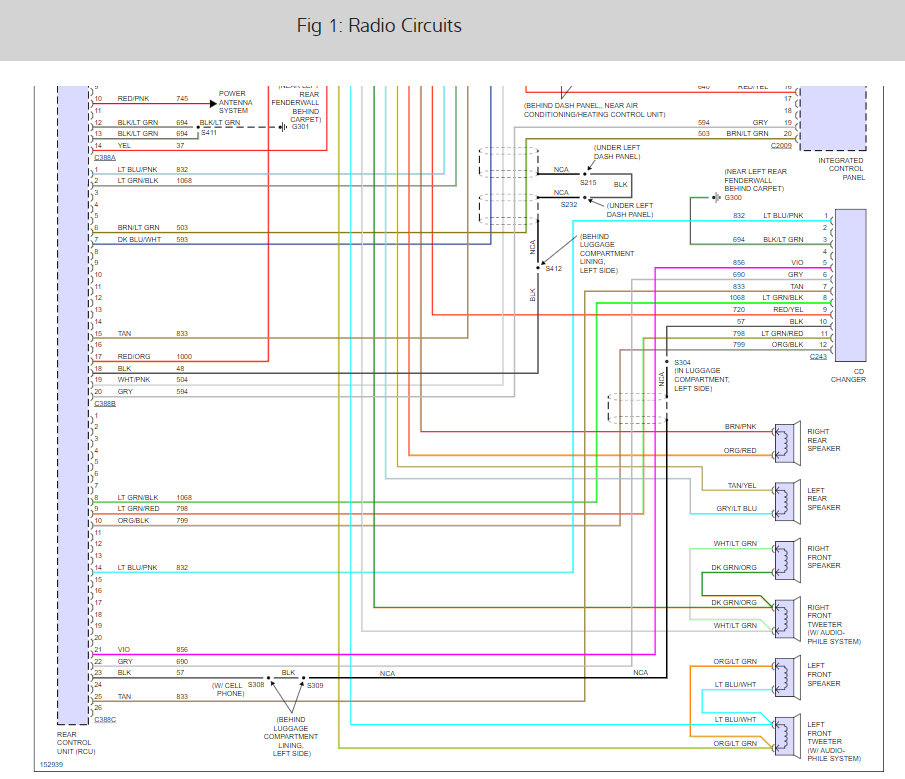

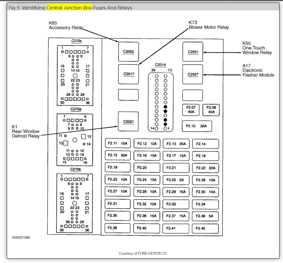

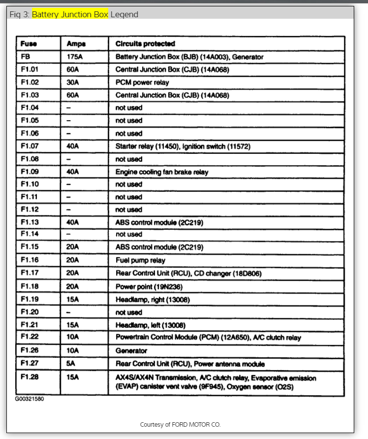

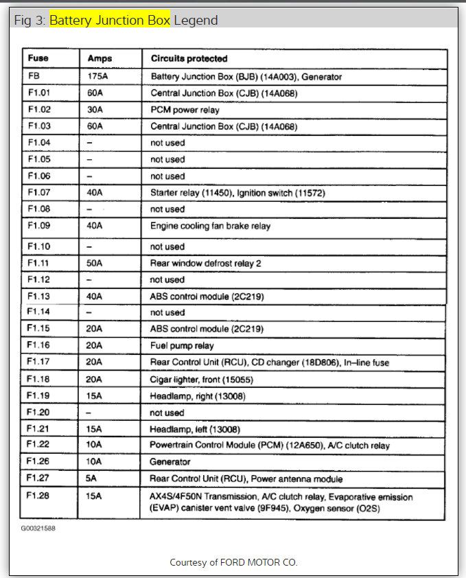

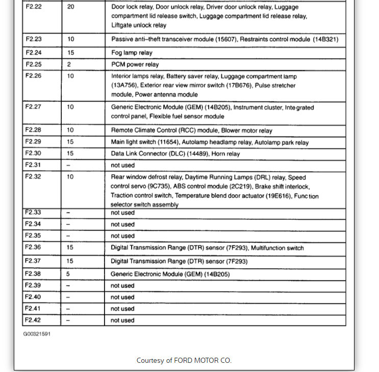

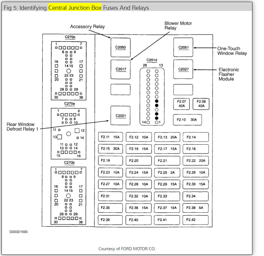

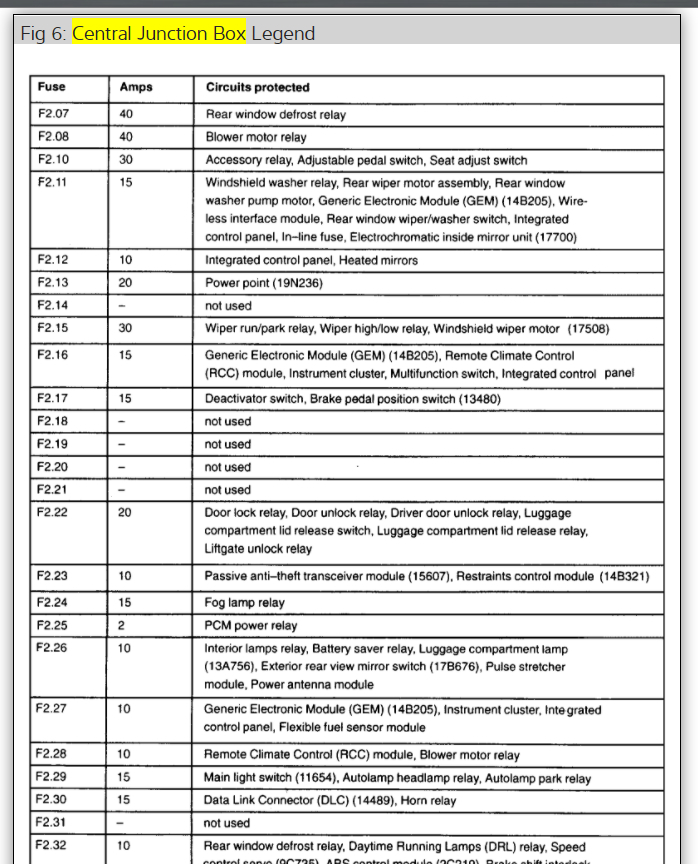

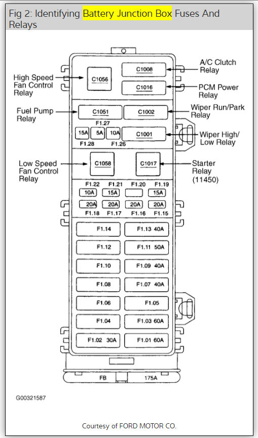

Check fuses under hood fuse #17 and #27 check fuses under left side of dash fuses # 37, 27, 1, and 11
I found the wiring guides for both the radio and the cigarette lighters. Use a test light to see if there is power at the fuses.
Here are a couple of guides to get you started.
and
Diagrams (below)
Please let us know what happens, we are interested to see what it is.

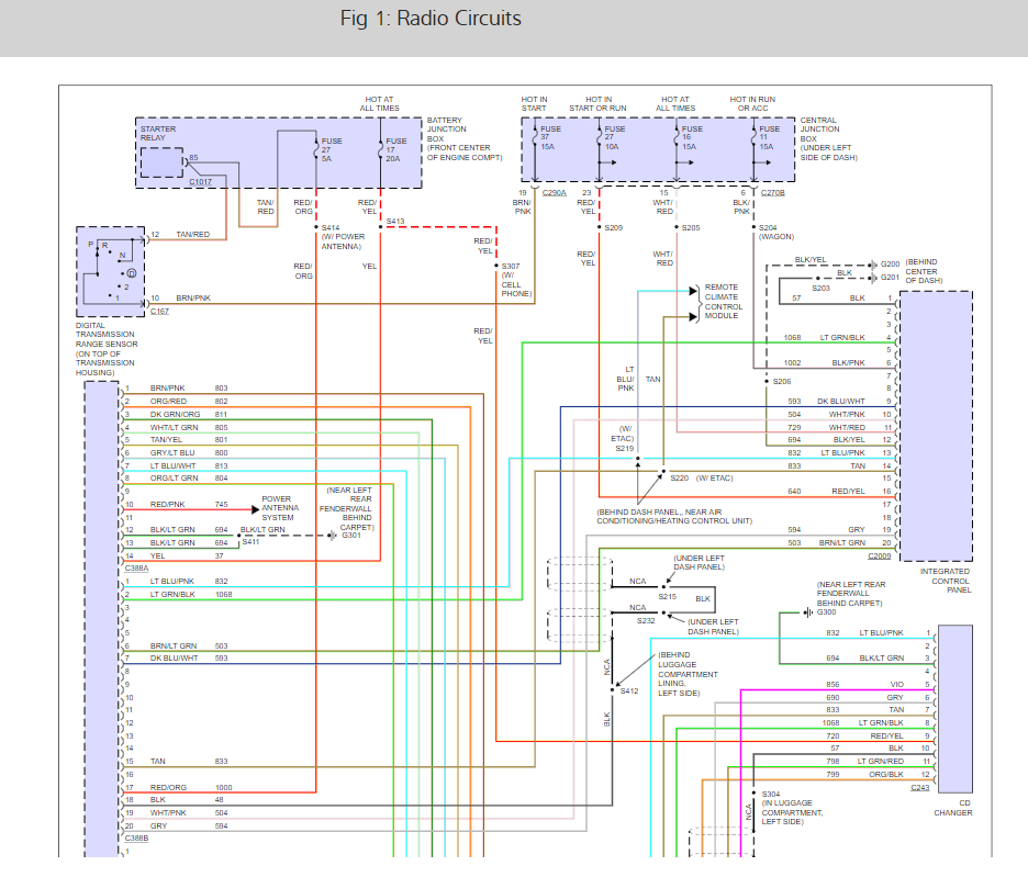

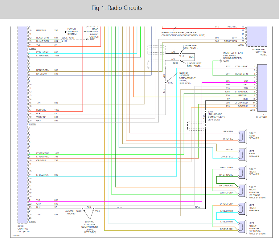

radio stopped working- I'm getting no power to the rear control unit/tuner/amp. all the fuses are good. however the fuse in the engine compartment has no power when checked with a meter. is there a relay somewhere that i'm overlooking?
Dec 25, 2018 at 7:07 AM (Merged)
BMRFIXIT
  • 19,053 POSTS

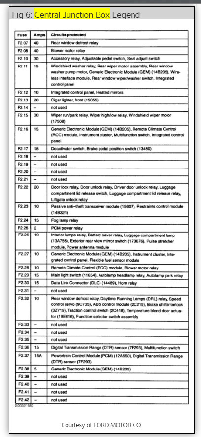

no listed relays for the system

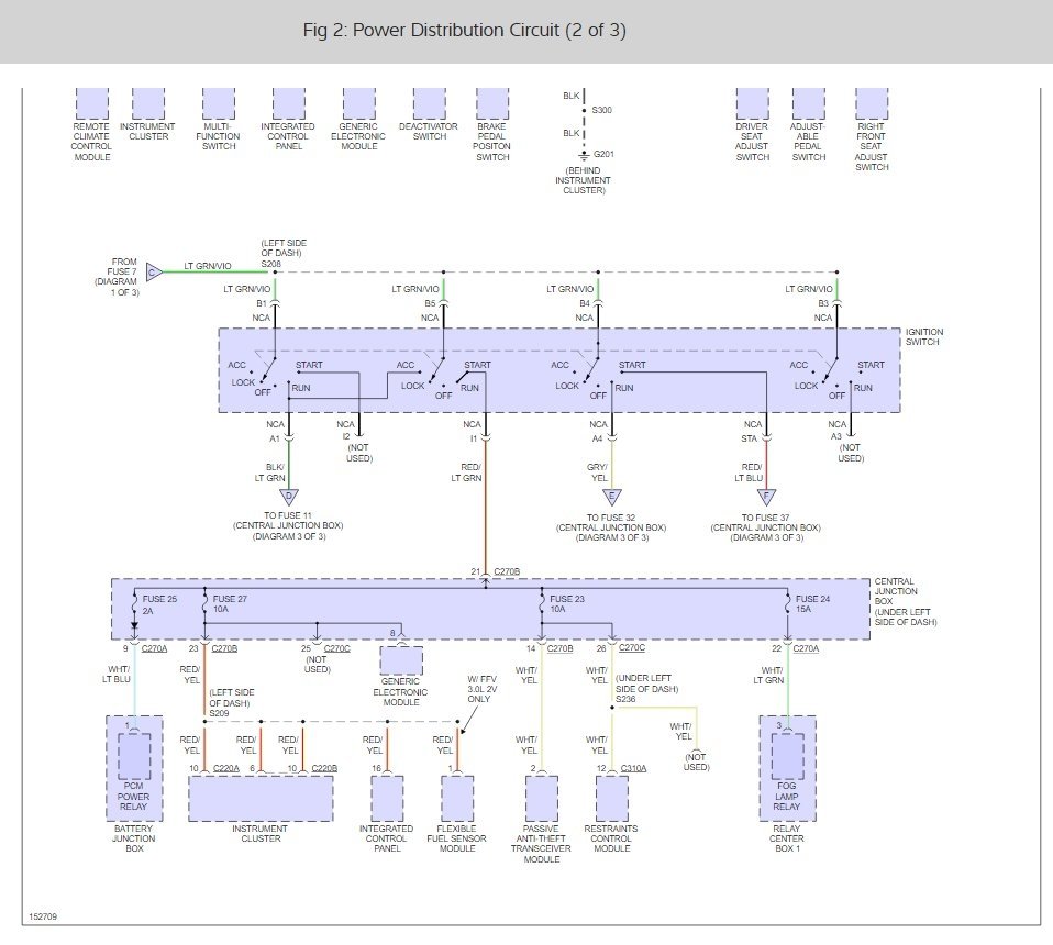

Under hood fuse # 27 5 A check for power when in starting
as for fuse #17 20A fuse should have power at all times if not check wiring and connectors
also check fuses under left side of dash
fuse #37 15A hot when in start
fuse #27 10A hot in start and when key on engine running
fuse #16 15A should be hot all the time
fuse #11 15A hot with key on or running and when in ACC
if not check for short or open in wiring system
let me know which one
and I will look it up

JTF1967
i checked all the fuses- #27 under the hood does not have power at any time.
JTF1967
i ran a hot wire from #17 fuse to the control unit in trunk-red/yellow wire and the stereo worked. if the wire is bad can i just run a new wire and splice into the red/yelow wire at the control unit if i fuse the wire.
BMRFIXIT
  • 19,053 POSTS
yes you can do that
make sure you have a fuse on it
