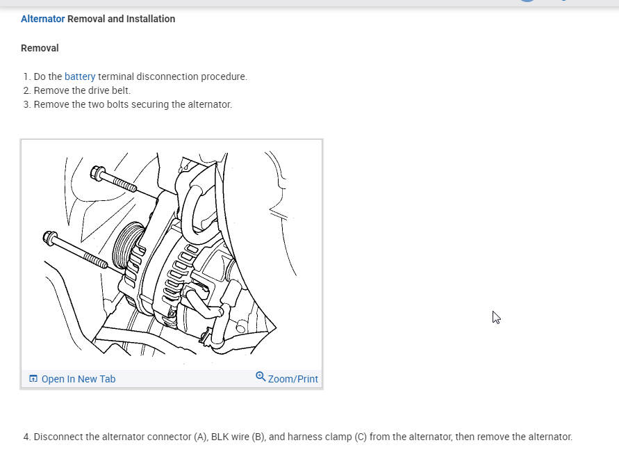

I am replacing the alternator in the car listed above. I removed the belt, 2 bolts and electrical connections. I wiggle the alternator(appears to rotate around the removed bottom bolt position) but can't lift it out. I vaguely remember something about a plastic in the bottom bolt position and if this is true, could it have moved? I see from YouTube the alternator is a tight fit, could it be at 88 years old I not longer have the strength to free it?

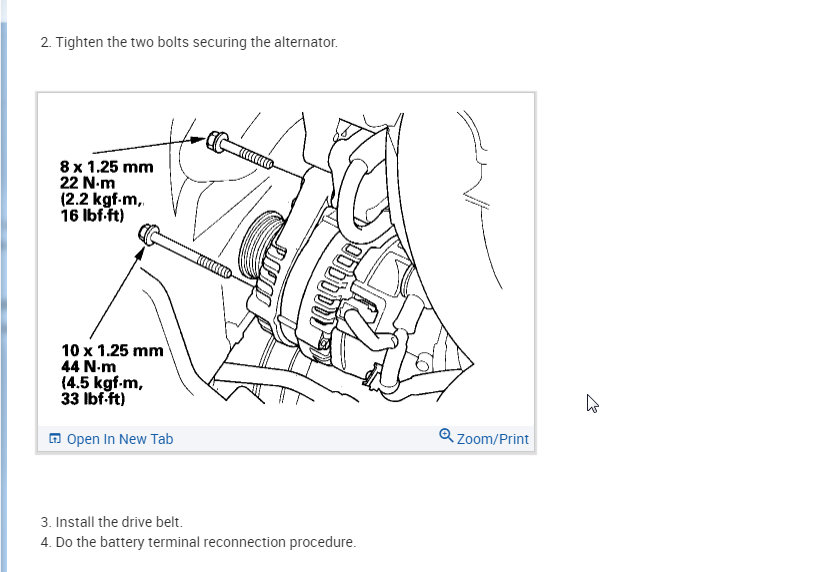

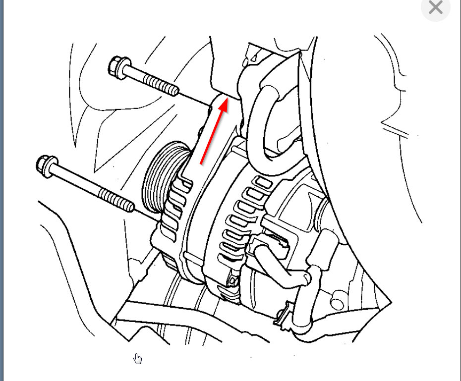

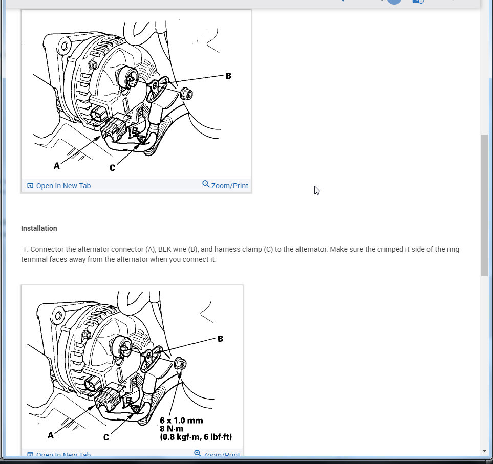

I am attaching the process for this from the manual. I know what you are talking about with the plastic sleeves that go through the bolt holes. I don't believe Honda used them so I bet it is just hung up with dirt, rust, corrosion. So what I would do is take a screw driver or pry bar and pull down on the joint that I am pointing at in the last attachment. Normally this happens on the top bolt where it is hung up and you just need to break it loose. If you want, put a tie strap or something around the pulley and tie to something so that when you do break it loose, it doesn't just drop or pinch your finger if you are trying to hold it.
Let me know how you make out. If this is not exactly what you are dealing with, can you get a couple pictures with your cell phone or even a video? Thanks

With 30,000 mile the area is clean with no rust or dirt. The alternator moved/moves from the top bolt position quite easily and it rotates up and down smoothly. It moves as if the bottom bolt was in place. There was some movement though as the top bolt can no longer be screw in.

Tom, I finally got the alternator out by rapping the upper bolt area, left andright, with a hammer. Thank you for your help.
