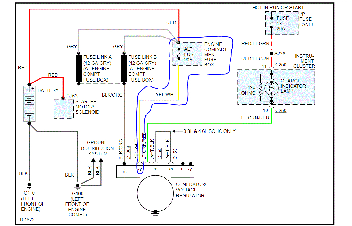

My battery light came on and the next day or 2 it shut off on me at a light. Replaced the alternator and battery. Also replaced the pig tail going to the alternator it was brittle and loose. Fuse wouldn’t blow right away. Now it blows when I put the fuse in. I have a diagram for the charging system, can you tell me the color wires and where they could be shorted? Can the short be on another circuit affecting this too? Thanks
Mar 2, 2020 at 8:31 AM
  • 110,251 POSTS

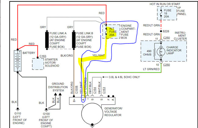

I want to confirm which fuse is blowing. I assume it is the 20 ALT fuse. If I am correct, disconnect the battery and check to see if there is continuity to ground from the yellow/white wire at the alt. (See pic 1) I attached what I have as far as a schematic as well.
Here are a few links you may find helpful:
If it is blowing as soon as you put the fuse in, there is a dead short to ground. So, confirm none of the pins in the new connector are damaged. I suspect the yellow/white wire is toughing a ground point.

Yes. That is the correct fuse, I will run the tests you gave me and report back. Thanks again for your time.
Mar 2, 2020 at 8:55 PM
  • 110,251 POSTS
You are very welcome. Let me know what you find. Since it is blowing the fuse immediately, I suspect there is a short in that wire or internal in the alternator. You could disconnect that wire from the alt to see if it still blows if you suspect it is internal.

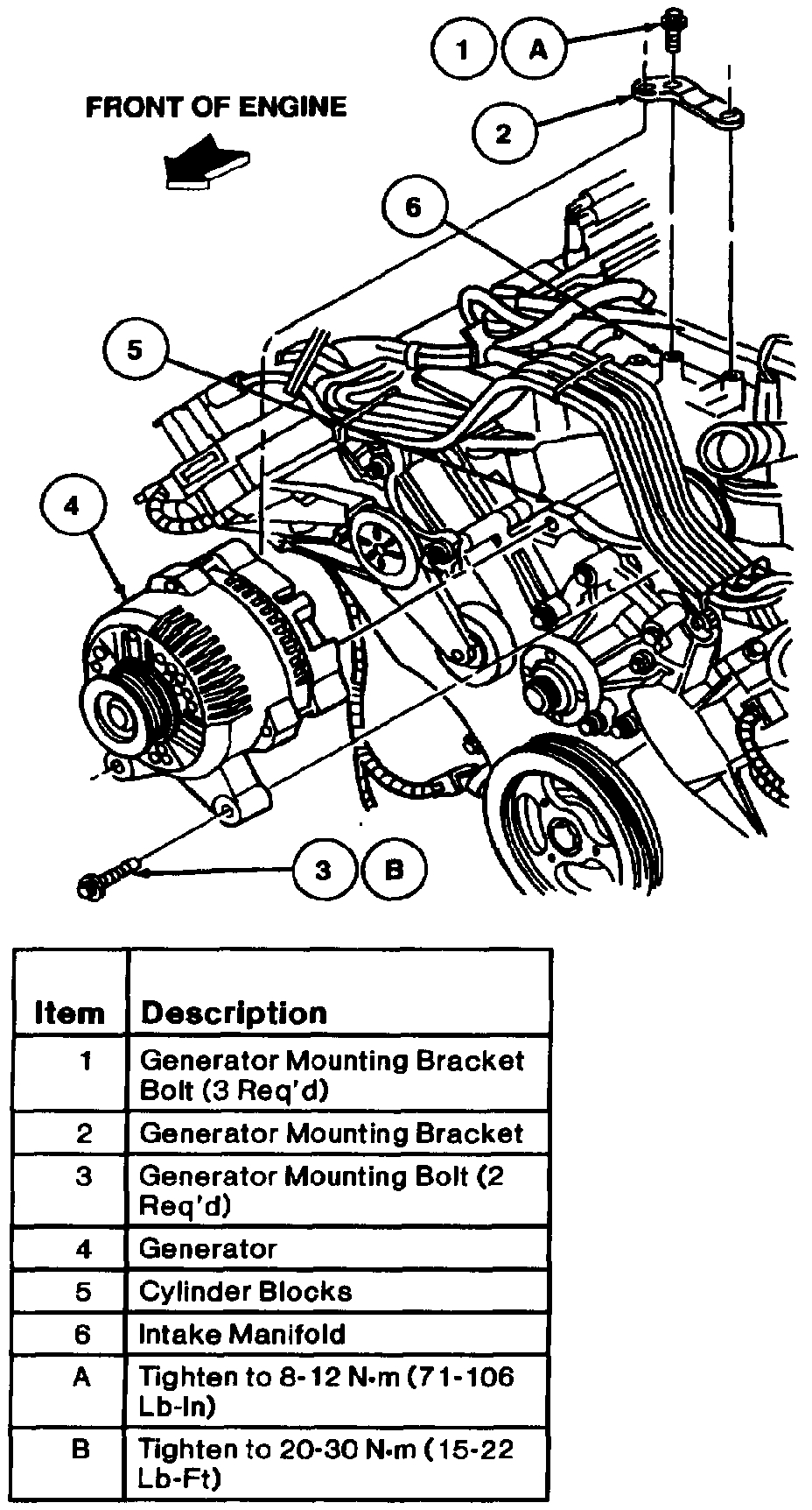

Here is a link that explains removal and replacement in general
https://www.2carpros.com/articles/how-to-replace-an-alternator
Directions from alldata / Pic 1 correlates with the directions.
REMOVAL
1. Disconnect battery ground cable.
2. Disconnect the wire harness attachments to the generator (GEN) and voltage regulator.
3. Disengage the generator drive belt from the generator pulley.
4. Remove retaining bolts and generator mounting bracket.
5. Remove the mounting bolts and the generator.
INSTALLATION
1. Position the generator on the engine.
2. Install the generator mounting bolts. Tighten bolts to 20-30 N.m (15-22 lb-ft.).
3. Install generator mounting bracket and retaining bolts. Tighten bolts to 8-12 N.m (71-106 lb-in).
4. Install the drive belt over the generator pulley.
5. Connect the voltage regulator wiring and output wire to the generator and voltage regulator. Tighten output terminal nut to 7-9 N.m (62-79 lb-in).
6. Connect battery ground cable.

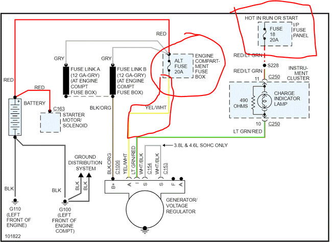

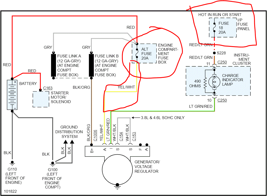

Then it's not the alternator. I suspect (since it was disconnected) the problem is between the fuse and alternator.
Take a look at the attached pic. (note I am looking at a GT model 4.6L) Note that the power comes from the battery to the fuse, through the fuse, and into the yellow wire with a white tracer and then to the alternator.
So, if with the alternator disconnected that fuse blows, it has to come after the fuse which is the aforementioned wire. You need to check to see if it is shorted to ground. Check the wire, the connector, and everything you can on that wire. Or, with the battery disconnected, check to see if there is continuity to ground in that wire. There shouldn't be if it is disconnected.

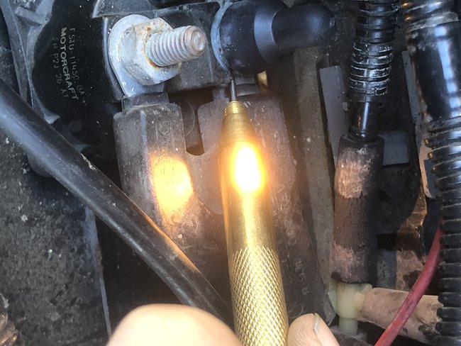

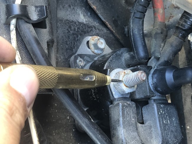

Used a test light on my starter solenoid not sure if that plays a factor.
Nov 6, 2020 at 9:55 AM
Just to jump in and answer that question. It appears that is the control wire on the starter. You should only have 12 volts on that when you are cranking the engine. So if you were not cranking the engine when you tested with with your test light then it would not light up.
Nov 6, 2020 at 10:11 AM
DOUGIEP15
  • 13 POSTS
Thanks for the response, in regards to the picture I posted, I was not cranking the engine.
Nov 6, 2020 at 10:22 AM
  • 110,251 POSTS
That wire only gets 12v when the key is in the start position. So what you found is normal. Have you checked the connection at the alternator? If you have and it's good, remove the alternator and have it bench tested at a parts store. Most will do it for free.

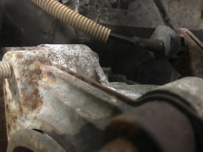

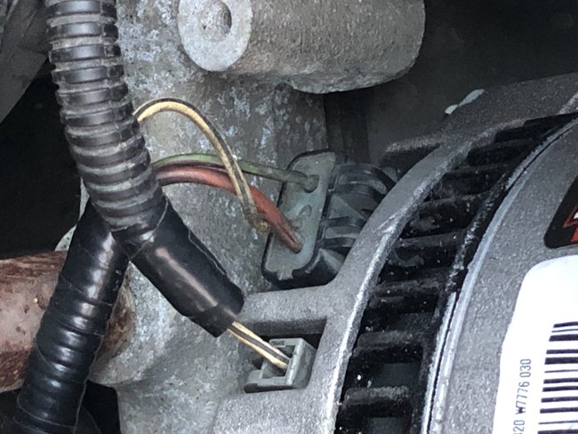

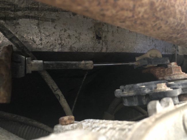

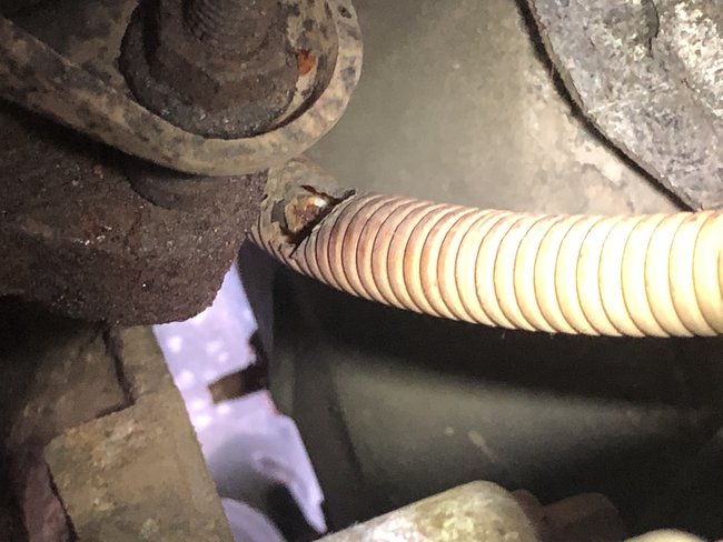

Not sure if this would cause the alternator fuse to keep blowing. I followed the cord from what you see in the picture all the way up to the instrument cluster.
Nov 7, 2020 at 7:34 AM
  • 110,251 POSTS
What wire is that in pic 1? Where does it go? That certainly needs attention.
Nov 7, 2020 at 7:39 AM
DOUGIEP15
  • 13 POSTS
Hey Joe, that burnt wire leads up into the instrument cluster.
Nov 7, 2020 at 7:42 AM
  • 110,251 POSTS
If you shield it, does the fuse still blow?
Nov 7, 2020 at 7:45 AM
DOUGIEP15
  • 13 POSTS
Going to try right now.
Nov 7, 2020 at 8:06 AM
DOUGIEP15
  • 13 POSTS
Still blows when I shield it.
Nov 7, 2020 at 8:26 AM
  • 110,251 POSTS
I was hoping that was the issue. However, it needs repaired regardless.

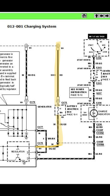

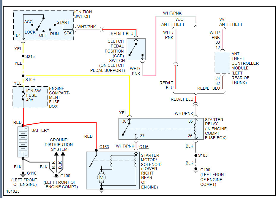

This is the diagram for my 2003 Ford F-150, I’m bringing my alternator to do bench test tomorrow after work.
Nov 8, 2020 at 10:04 AM
  • 110,251 POSTS
Sounds like a plan. Let me know what you find. Also, when looking at your schematic, it's a bit blurry. However, it looks the same. Is there something different you are seeing?
