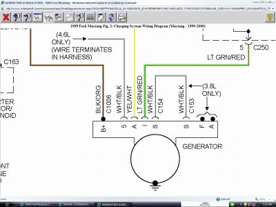

You sure its not computer controlled voltage regulator-I'm away from my database-I'll get back to you ASAP
I've you checked all the fuses involved w/the charging system.
Feb 26, 2008 at 3:19 PM
  • 75,988 POSTS
Okay am back -you might want to check wire to wire from and to the alternator-12.2 volts for an open voltage-meaning no load on battery-is kind of low. Load test the battery again if it doesn't hold 9.6 volts in 10secs while using starter as a loading device-replace it. see below Charge System Diagram
https://images.2carpros.com/forum/automotive_pictures/12900_alty_12.jpg

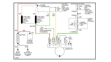

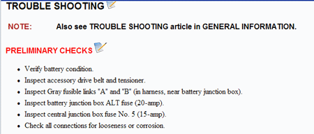

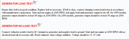

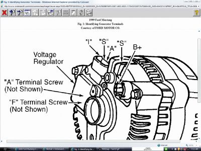

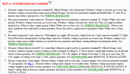

Here's a few tests to perform....
https://images.2carpros.com/forum/automotive_pictures/62217_Test1f_copy_1.gif
https://images.2carpros.com/forum/automotive_pictures/62217_Test2_copy_1.jpg
https://images.2carpros.com/forum/automotive_pictures/62217_Test3_copy_1.jpg
https://images.2carpros.com/forum/automotive_pictures/62217_Test4_copy_1.jpg
https://images.2carpros.com/forum/automotive_pictures/62217_Test5_copy_1.gif
https://images.2carpros.com/forum/automotive_pictures/62217_Test6_copy_1.gif
Feb 26, 2008 at 10:41 PM
PETERMAN1551

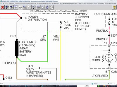

I have done all the tests which all check out, grounds appear fine, cannot find fusable links off of the grey wires per your diagram. Do see the the grey wires and can trace them back to the fuse box on the fender well, but no fuses apparent in the wiring. All fuses in the fuse box and under the dash are fine.
Could it be the female part of the connector that plugs into the back of the voltage regulator on the alternator? Also, I have been told that possibly my model year car has a split regulator system where there is one residing in the ECM. Is this the case? If so, how do I check if it is bad? Replace the ECM and how would I do so when it has a specialty tune on it due to all the modification I have made to the car?
