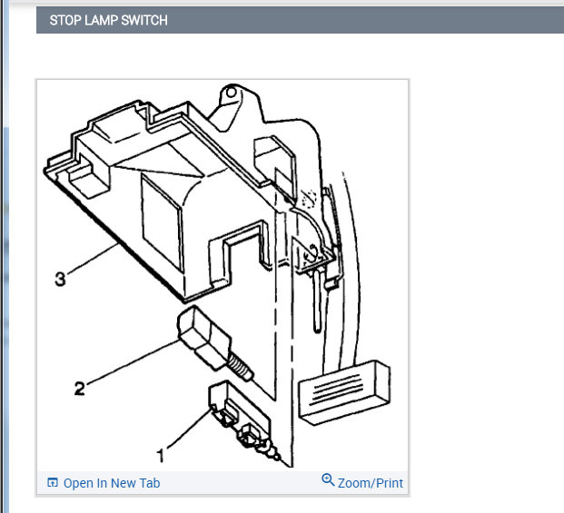

I have check the fuse it didn’t look bad but replaced it with a new anyways. Searched the internet running lights still work, blinkers still work and headlights still work. Did I just get unlucky that all the brake lights burned out at the same time?
Sep 22, 2020 at 12:14 PM

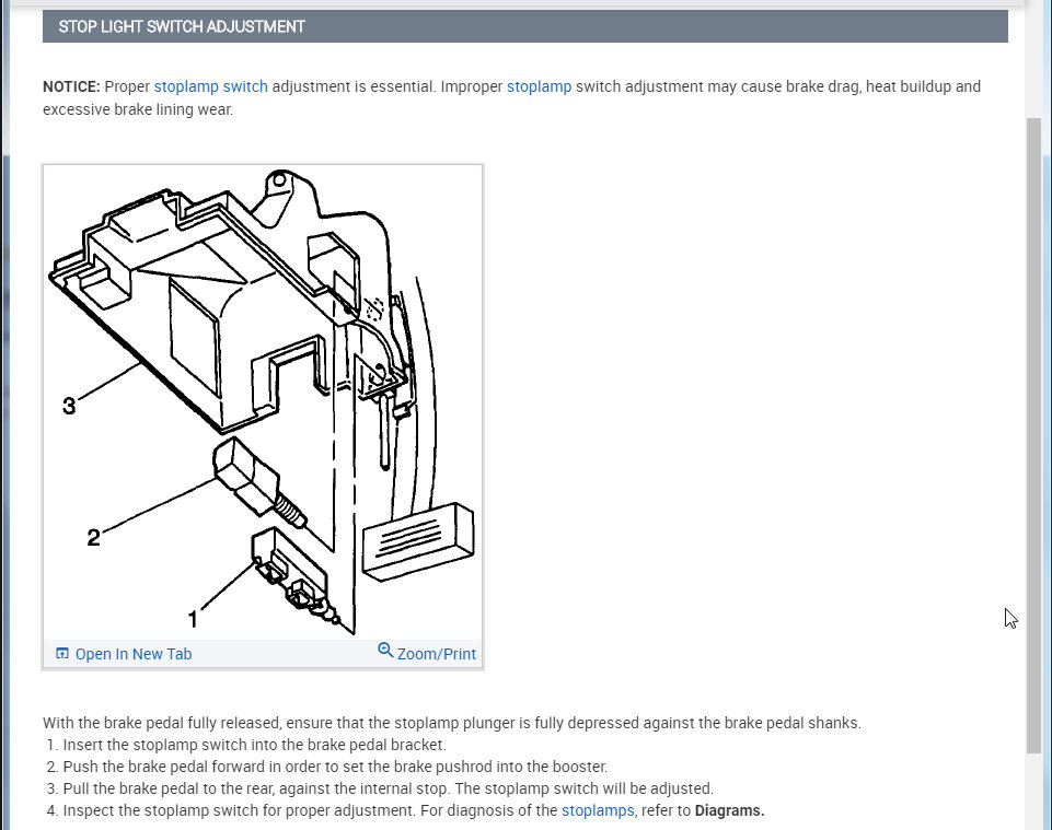

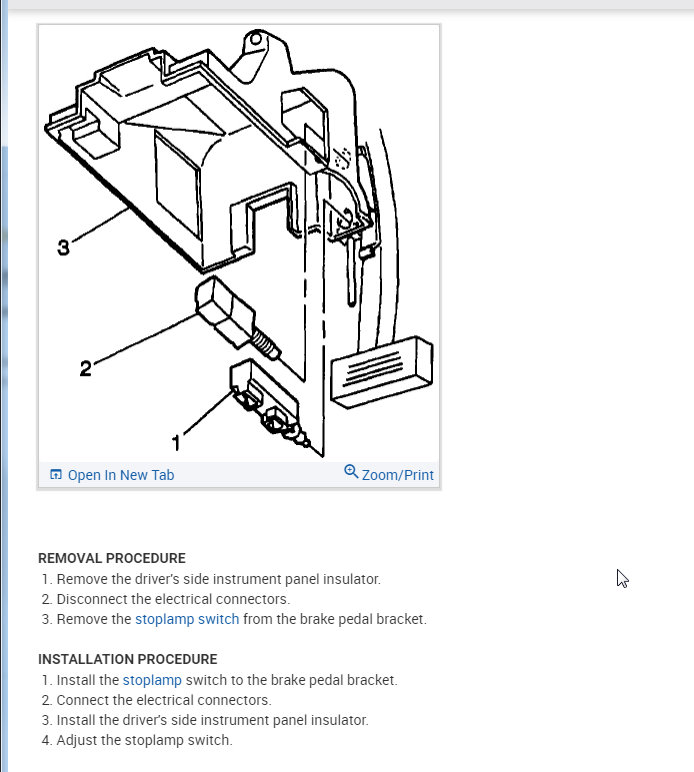

In short, no. All three lights don't just burn out at the same time. I suspect you have an issue with the brake light switch. There is an adjustment process so you can try that first. However, if that doesn't work then I would replace it and adjust the new one and see if that restores your brake lights.

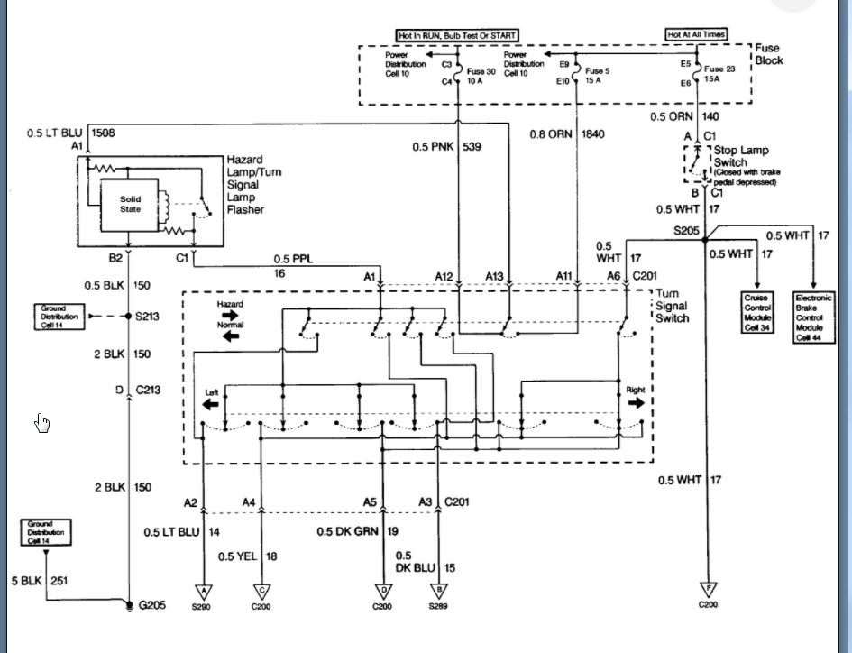

I also attached the wiring diagram. If you want to test it, you can unplug the switch and jump the two wires. The brake lights should come on.
Let me know if you have questions. Thanks
