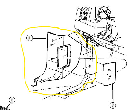

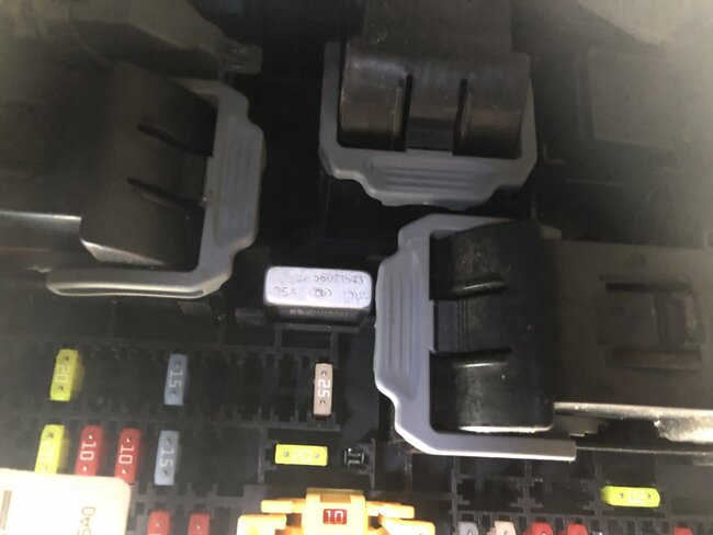

Hello DURANGODODGE,

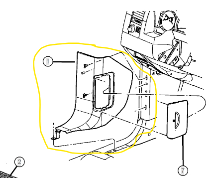

My information is telling me there is a circuit breaker behind the left kick panel that powers the windows. However, it looks like it also runs power to the sunroof motor (if you have it), as well as the power locks and door modules.
But locks work fine, it's only the windows that aren't working. I think testing the circuit breaker is a good first step so we can make sure there isn't an issue with it so we can rule it out.
To do this you will need a multimeter.
Here is an inexpensive one I found if you don't have one:
https://amzn.to/3NUrAOd
Here are some instructions to use one if you haven't before:

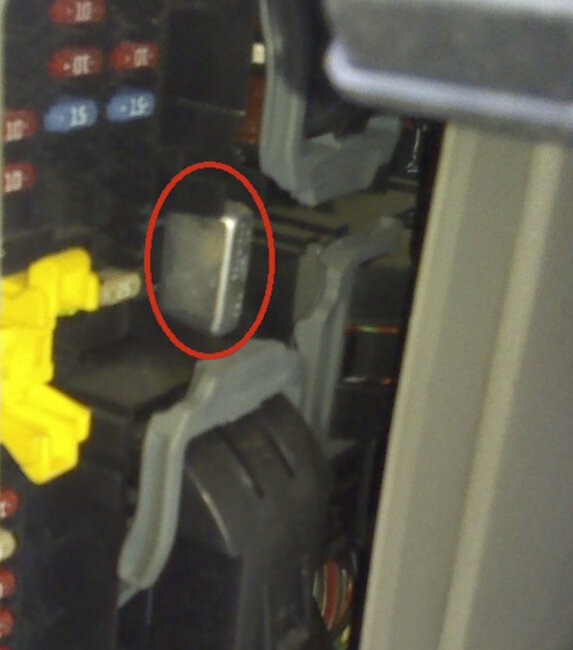

What you need to do is pull it out slightly so that it is still connected but you are able to put the test lead on it.
Touch the black lead to a known good ground on the body.
Then take the red lead and touch one terminal then the other on the circuit breaker.
You should have 12 volts with the key on engine off on both terminals.
If only one terminal has 12 volts, the breaker is bad and needs to be replaced.
If you don't have power on either terminal could be power supply issue or ground.

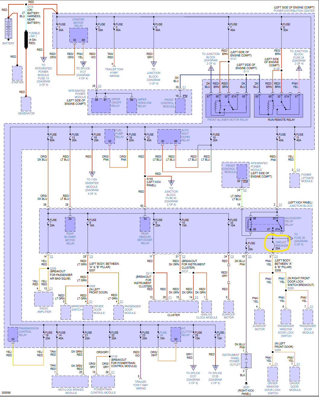

I am adding a wire diagram for you, as well as an image of the location based on my information.

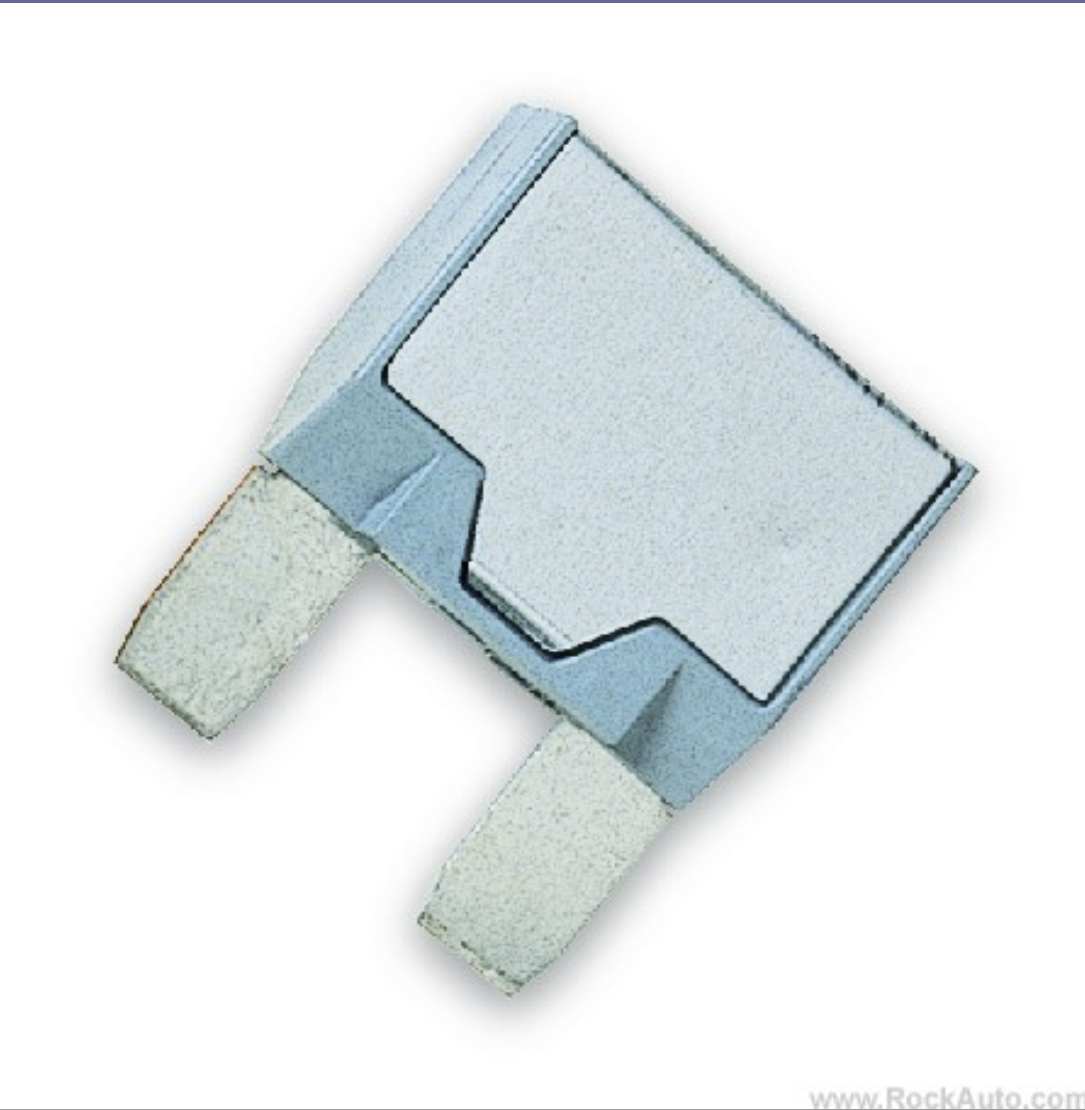

I am also adding a picture of the part.
If you need it, I found one on RockAuto for you here:
https://www.rockauto.com/en/catalog/dodge,2009,durango,4.7l+v8,1442700,electrical,circuit+breaker,2504
Part number is CB191125 from BUSSMAN. Your local auto parts store should have it as well.
Let me know if you need any help when you go to test and based on what we find we can go from there.

Thank you very much. I went and bought a new circuit breaker and replaced the old one and the same problem remained. So, should I get the multimeter and perform the test with the new circuit breaker?
Jun 30, 2023 at 4:37 PM
BRENDON S
  • 653 POSTS
Hello DURANGODODGE,
You're welcome. Happy to help. I would so we know whether it is getting power there or not or if there is any other information we can gain from that area. We will need it either way to do some more testing plus it is a good tool to have.

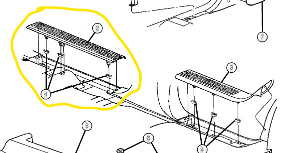

Hello DURANGODODGE,

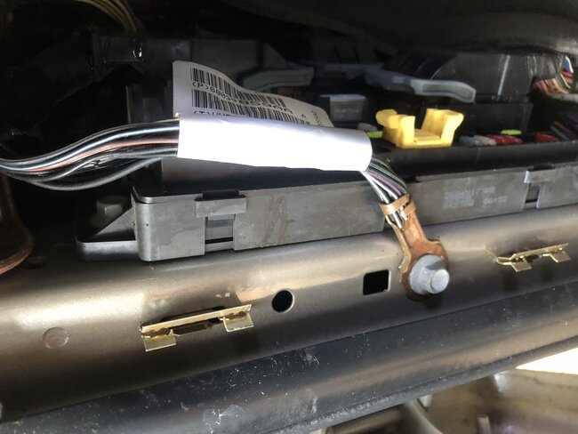

The best place would be behind that same kick panel. This is usually a common ground location.
Best thing to do is to remove the sill, it is the piece of trim held in with clips.
Then I would take off the kick panel so you can have room to work.
I have included a picture of both. Looks like the kick panel might be held in with some screws. Usually, it will have a clip too.

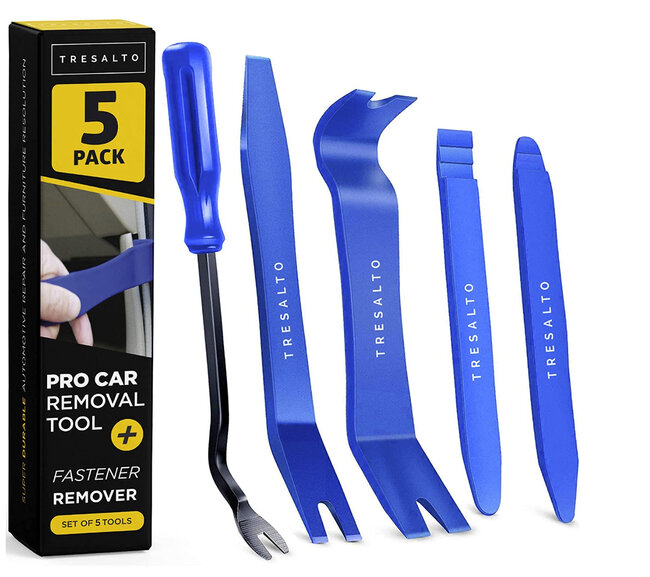

You will need a tool designed to help remove these pieces. Usually called a trim puller.
I have added a picture for you. Your local auto parts store should have some as well as Amazon.

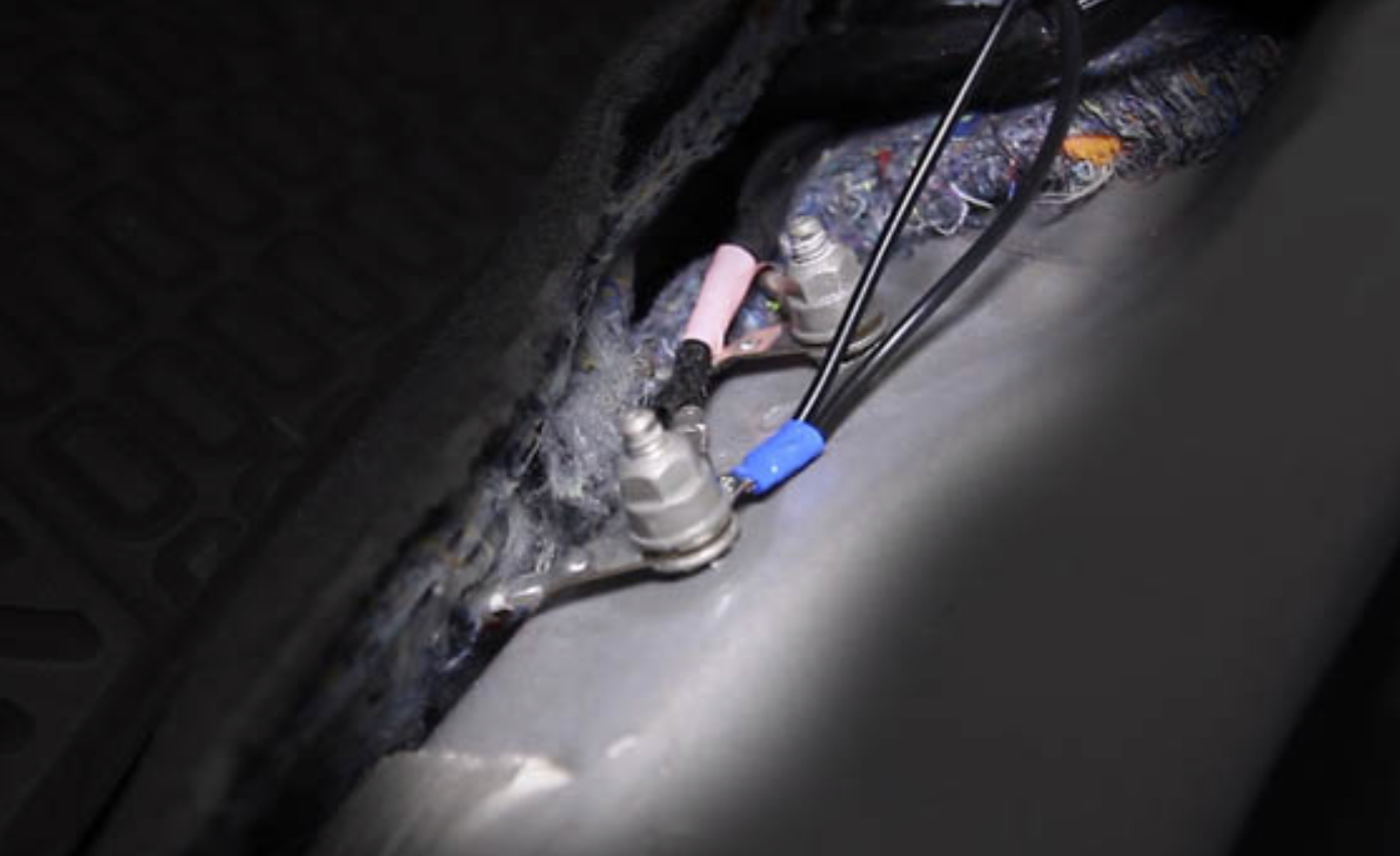

Then you will have access to ground. So anywhere on the body that will have no paint is the best spot but usually there is a bolt with a bunch of wires attached to it in this area. You can just touch one of those bolts on the top. Make sure it is screwed into the body.
Another good spot is the bracket for the e-brake as long as it's bare steel if not a bolt that holds it to the body is a good spot. Brake pedal bracket could work as well.
Also, when you get the tester make sure it has a continuity tester, which will make an audible beep if the circuit is complete. We will need this feature to do testing down the road.
Also make sure it has a fuse in it. They all should but all meters are not created equal, so just double check. This will help save other wiring or modules from being damaged in the event something might get touched with the leads and exceeds a certain amperage.
Go slow when pulling the trim especially in that area as it often rusts the clips over the years which make them swell and become tighter.

I have included an image of a typical body ground.

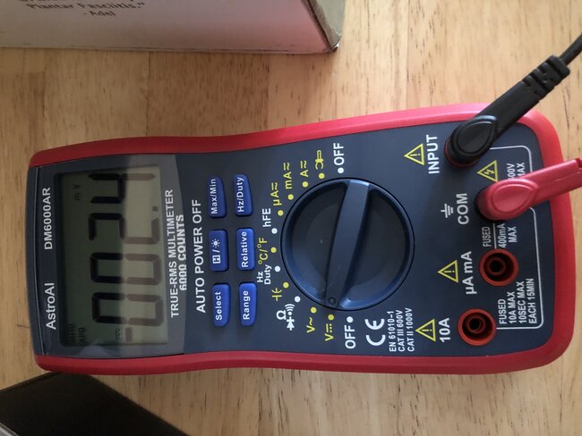

Well, I did as you directed with the multimeter. The screen registered 2.9 ish with either terminal. The screen actually bounced around between 2.9 to 3.0 on either prong on the fuse. Does this mean there is a power source or ground problem in the fuse box, or am I messing up? I also got the same result with both the existing circuit breaker and the new one I purchased. Another question: When I turn on and set the multimeter it doesn't sit at zero. It bounces around in value if I move the multimeter. For a ground, I used the door latch because I wasn't sure if the enclosed photo is a ground.

The leads are backwards. The black one needs to go in COM and the red lead will go where you have the black lead now. Make sure the meter is off before you put the leads in.
Sorry I should have mentioned that.
Then turn it back on and see what it does. It should auto-calibrate.
If it is still acting up put it on resistance which is the omega symbol, 2 up from where you are, and touch the 2 leads together and see if it shows any reading. It should be 00.0.
That ground in the picture is perfect. Put the black lead on that and try again on the circuit breaker.
So far it looks like you have some power, but I am wondering if the meter is faulty, or it just wasn't a good area to ground to. The meter seems like it might have gotten damaged in shipping but let's not condemn it yet.
With a small amount of voltage, it can be power or ground that is causing it. By attaching directly to that body ground, we know we have a good ground. If we don't have a good enough ground the voltage reading will be lower on the meter but not necessarily mean it doesn't have 12 volts on the breaker.
So, use that ground in the picture after switching the leads and see if anything changes. Also check the instructions and see if there is a calibrating procedure for it. Hitting "Range" might calibrate it.

When I put the meter on omega, it shows 0.L. When I touch the leads, it bounces around at all different numbers. When I used the bolt instead of the door latch for a ground, both readings were at 1.8+.

Unfortunately, though I think there is something wrong with that meter. I don't know the seller, I suggested it because it was cheap and had all the features you would need to test properly. I would contact the seller and return it. I think it got slammed around in shipping and is damaged.
I would run to your local auto parts store and grab one unfortunately, so you can continue testing. Make sure it has a continuity test with an audible beep and a backlit screen.

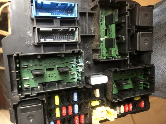

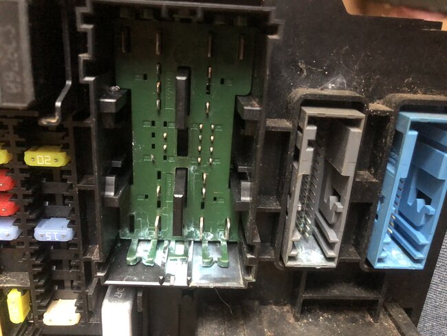

Well, I'll try and explain what has transpired. My wife ran out of patience (or confidence) in my attempt to find the problem and took her car to the dealer. If you recall, they had diagnosed the problem as needing a junction fuse box relay replaced. (Block relay $561.). (Labor $175 per hour). plus, usual shop charges and sales tax, for a total of $1,239. When i went to moparparts.com, the price MSRP for the junction fuse box relay was nearly 1/2 the price the dealer charged. so now the dealer installed the new box, and the windows still did not work. The mechanic says the ground was bad, (probably leaking down through the window weatherstripping which does look a bit rotted on drivers left lower corner. Then he said he had to use an external ground, which I don't understand. Is that because he already installed the box? All work now. Sounds to me like you were right after we tested the bracket at 1.86 v when you said it could be a ground problem. I'm enclosing a picture of the old box and you will see a discoloration or corrosion, (I think) on the 3 boxes on top right. Your thoughts would be much appreciated. Also, you have gone so far and above what I expected when I checked out your website, and in my mind, you were right on with your opinion and directions, that I can't thank you enough. I knew I would not be able to do the repair myself, but I was questioning the dealer "diagnosis".

An external ground to me sounds like he by-passed the original ground. There is a black with a light green tracer or stripe. It comes from the driver's side switch and ends in the center of the vehicle according to what the wiring diagram says. It's funny, after we were done with the circuit breaker testing, I was going to have you check for continuity on that ground wire. They probably moved it to keep from having to remove the seats and center console. Which would have cost a lot more in labor, especially with their labor rate.

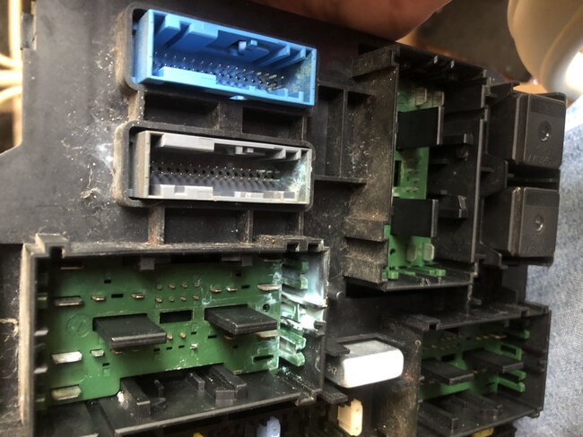

The fuse box looks like it might be grease but it's hard to tell. Some of the terminals do look like they might be corroded though. Probably looks way worse inside.
