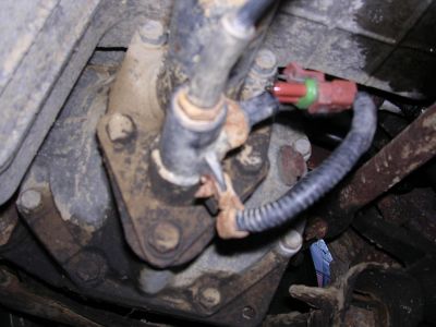

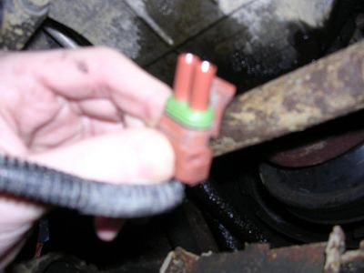

Thanks for the continued help, I dont mean to continue to bother you but I feel like we're on the verge of solving this! :) I got under the truck and looked at what you described, i THINK i located it. I took my digital camera out there with me and was able to snap a few shots of what I think might be the switch. Can I get your email and send you the picture to make sure we are on the same page?

GRUBBERS10
  • 5 POSTS
Thank you for your patience, I didnt realize I could post a picture on here. This picture is of what I think you might be talking about. This red plug is located to the right of the differential and plugs into what im finding to be called the "shift housing", indirectly plugging it into the differential. This plug is infact 2 prong. In this picture I have it unplugged. Could you tell by this picture if this is exactly what we're discussing.

Mar 4, 2007 at 1:43 PM
CHEVY22
  • 1,375 POSTS
you got it man , go get some parts and fix it ,jim
