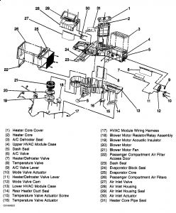

High side a little high what is ambiant air temp? Heater core have manual shutoff valve? if not sure blend door is working to route air to evap. bypassing core? does box look like this?
https://images.2carpros.com/forum/automotive_pictures/198357_Graphic_79.jpg

Ambient air temp was around 92 deg. The heater core is controlled by the OEM valve but the inlet hose temp was approx. 155 deg. and the outlet hose temp approx. 95 deg. so the valve was working. Hard to tell from pic if it's representative of what I have. Both heater & evap cores are mounted together inside box (evap core is mounted nearest air supply side and heat core is mounted between it and fan) and fan is mounted on suction side and pulls air through evap core first and then heater core.

Print diagram and enlarge. look at #8 check operation of blend door. Think heater core is getting hot and warming air that would account for highside being elevated. if heater core had no flow then how did temp drop 60deg passing through?

Enlarged diagram but it blurrs so much that when I print it it blurrs too much, can't bring it into focus enough to read. Rechecked the truck, blend door is closing properly. Has dash-operated heater control valve and valve is working properly; truck came back from 8 hour route and I checked the core port temps. The inlet port coming from the engine was 155 deg and the outlet port was 95 deg with the dash switch set on full cold; when i set the switch on full hot both ports went to approx. 155 deg. I set the switch on cold and within five minutes the inlet was back to 155 & the outlet had gone to 95; I believe the outlet temp is staying around 90 or so degrees because the ambient air temp was 92-94 deg with a heat index of 101 deg plus the underhood temps were high. With the switch on cold the vent temp was 75 deg and temp went to approx. 145 deg with the switch set on hot. The low side pressure reading was 45-50 psi and the high side pressure 245 psi. I forgot to take a pic of the box setup; will get that today & send to you.
