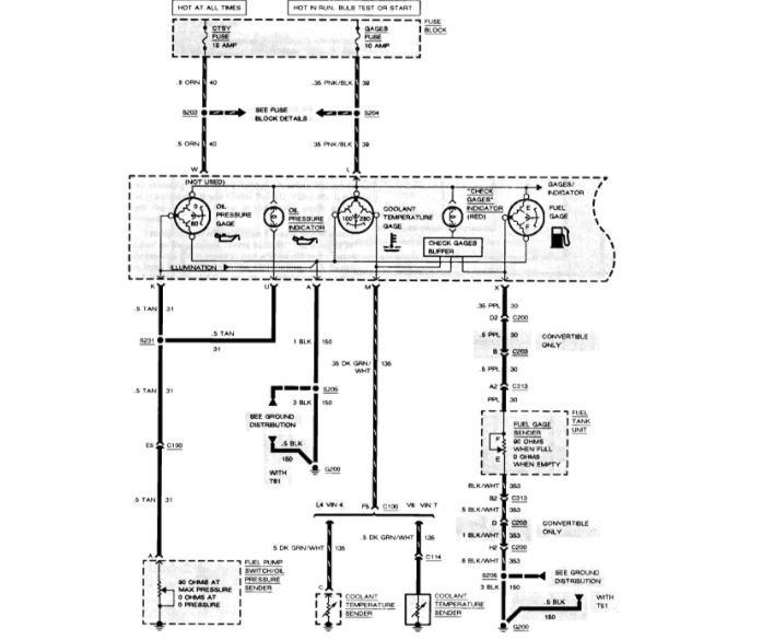

All of the gauges on my dash board don't work, the speedometer doesn't work, the gas hand is under the e even after i put gas in. the temperature doesn't move it stays under 100 the rpm does not move it stays on the line underneath the 1. the dash lights come on but that is it. What can i do to fix that and how much is it going to cost me?

I do not think that the problem is electrical, it appears that the temp gauge is stuck - it is below 0 and will not move. The speedometer gauge is on 41 MPH even when the ignition is in the off position - appears to be a calibration issue. My questions are:
1) Does this make sense, e.g., is the logic here correct?
2) Where is the best place to take it for repairs.
3) How much should I expect to pay for this type of repairwork, e.g., what is reasonable?

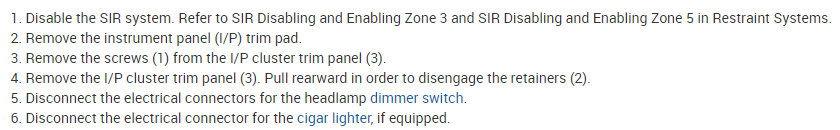

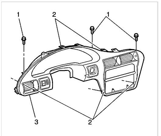

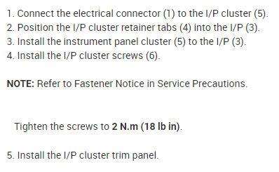

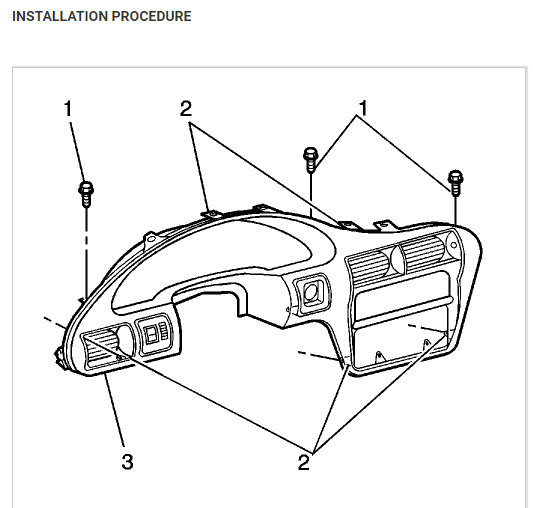

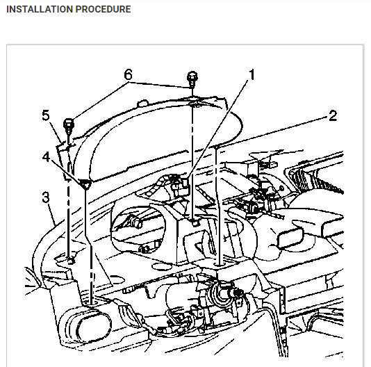

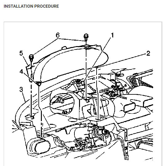

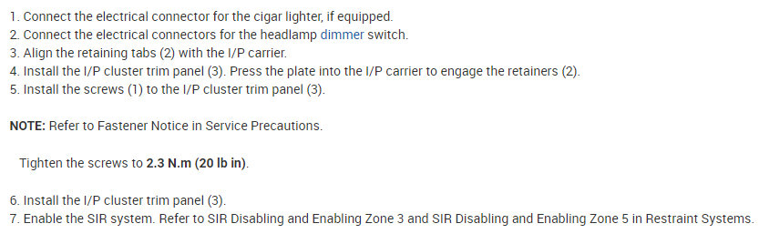

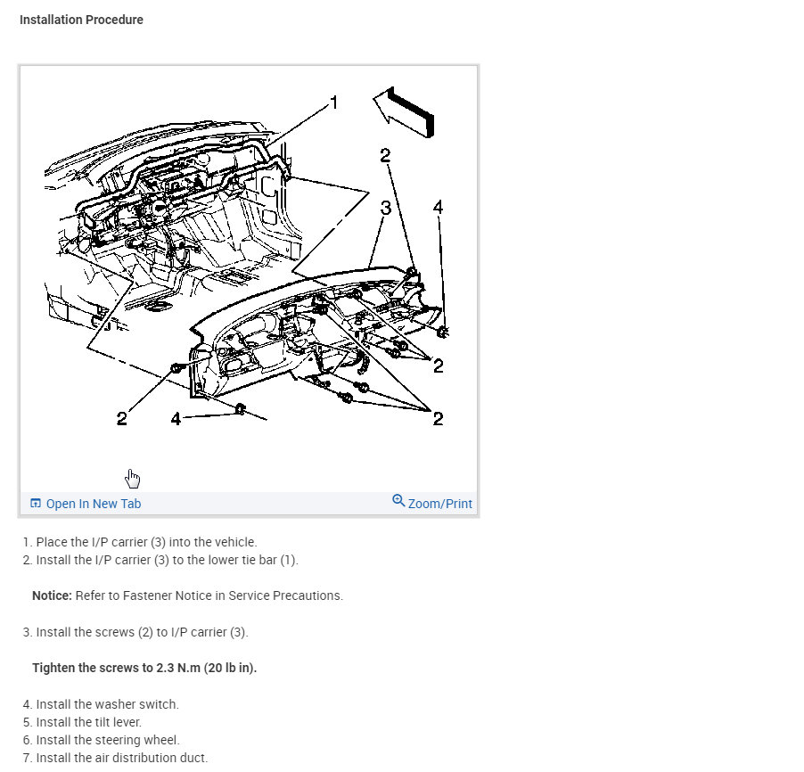

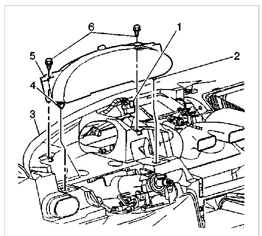

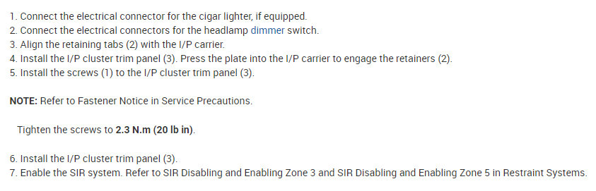

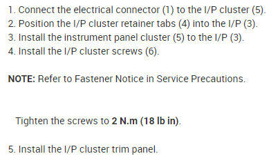

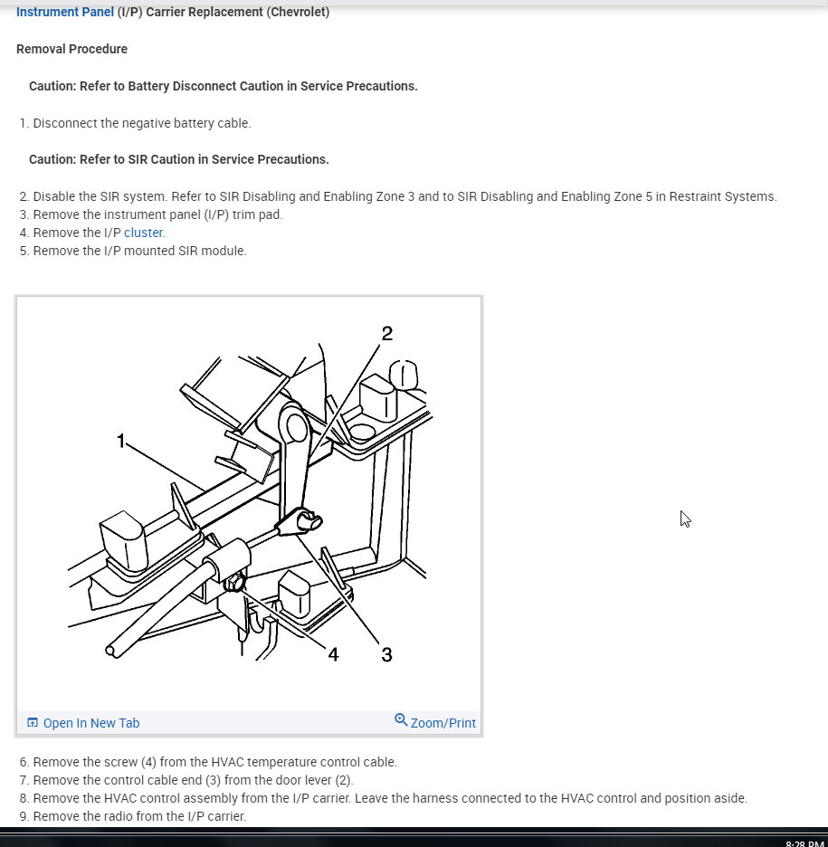

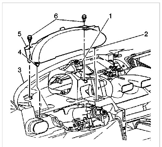

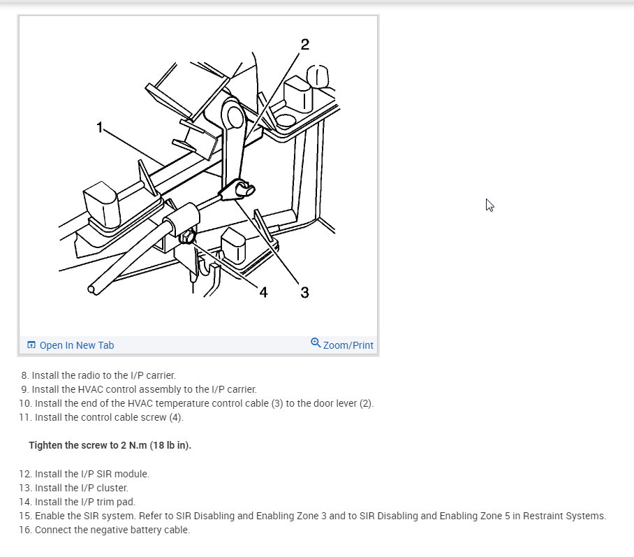

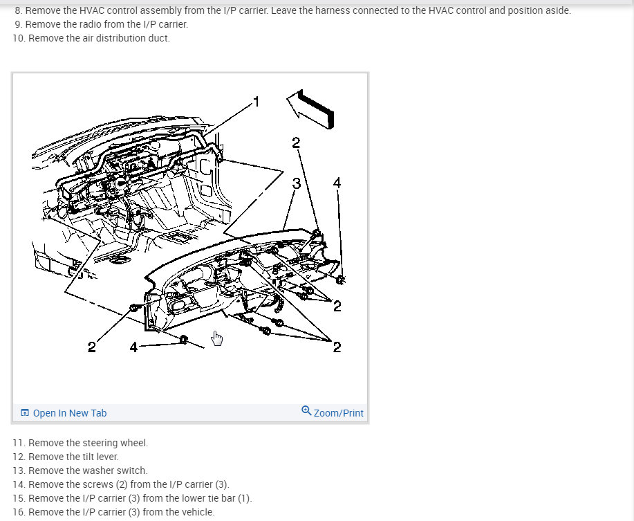

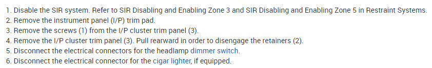

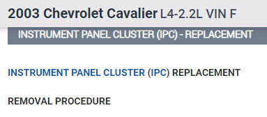

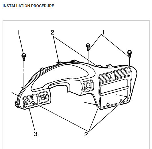

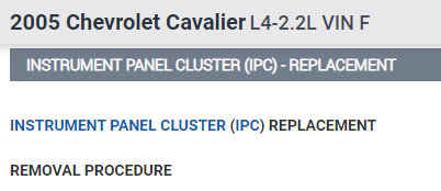

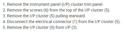

Each of these issues points to a cluster issue. The BCM and PCM each send info in for the lighting and gauges separate of each other and it is very unlikely that they are both causing the same issue. Take a look at the wiring diagram and you will see each is separate.
I included the procedure to replace the cluster which if it were me, this is what I would do and go from there. Thanks
Jul 8, 2021 at 3:26 AM (Merged)

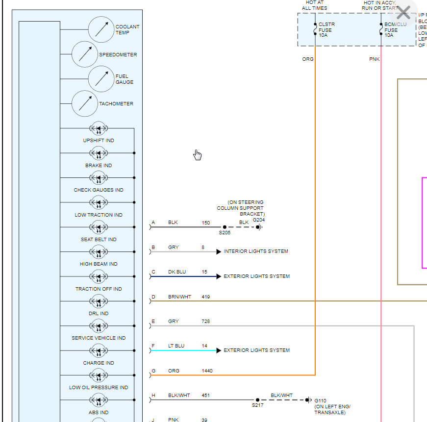

check 10 amp fuse labeled CLUSTER, in the instrument panel fuse block (on driver's side of instrument panel)

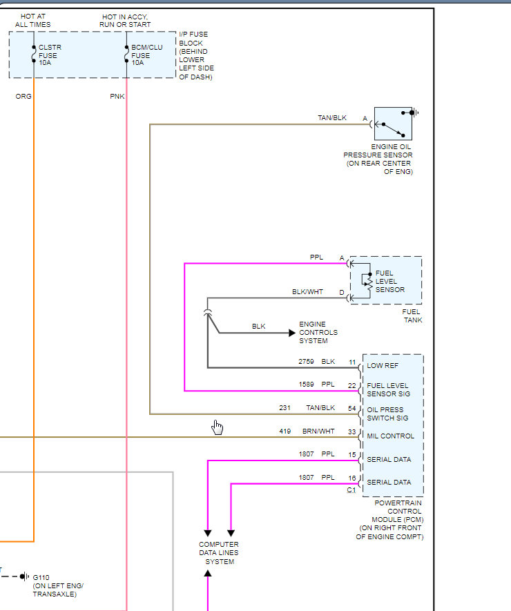

This seems to be an ancient thread, but I ran across it after I had a similar problem and have solved it, so thought I would post a reply. I knocked out my instrument cluster when replacing the battery, and pulling the battery leads, holding them together, and whatever did not work. Pulling and reinstalling the obvious "cluster" fuse did not help either. Haynes notes two fuses going into the instrument cluster microprocessor -- "cluster" and "CLS/PCM". The latter does not seem to exist on my car, but I have got a "BCM/CLU".
Long story short, turned the ignition to "run", pulled the BCM/CLU fuse, put it back in, and everything is alive. Looks like this gives the instrument cluster microprocessor the clean start it so desperately craves.
Jul 8, 2021 at 3:27 AM (Merged)
KSCULLIN
I had already tried everything else listed (checking fuses, disconnecting battery, etc); got the the pulling the fuses with the ignition "on" steps and tried that. I had to pull both the "BCM/CLU" and "cluster" fuses and replace them with the ignition still "on" to get it to work. By the way, I also got a jump from a drained battery.
This may be significant; I pulled the BCM/CLU fuse first, then the cluster fuse and replaced them in FIFO order (BCM/CLU fuse first, then the cluster fuse).

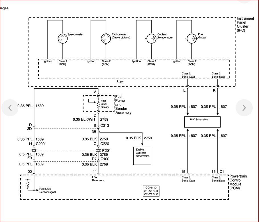

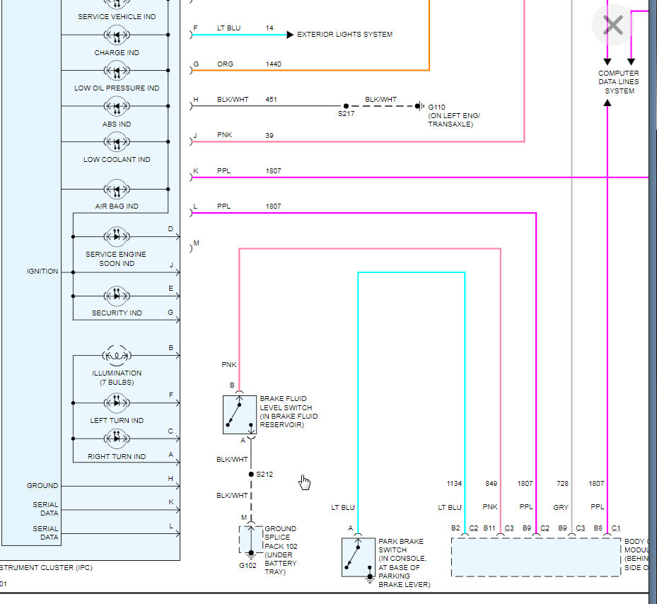

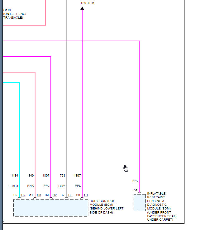

Good morning.
Attached is a diagram of your cluster. check the two fuses listed for power on both sides.
The smell concerns me. it sounds like the alternator may have failed. if the light is on, then there is a problem.
do you have a voltmeter to check the voltage at the battery while the engine is running?
