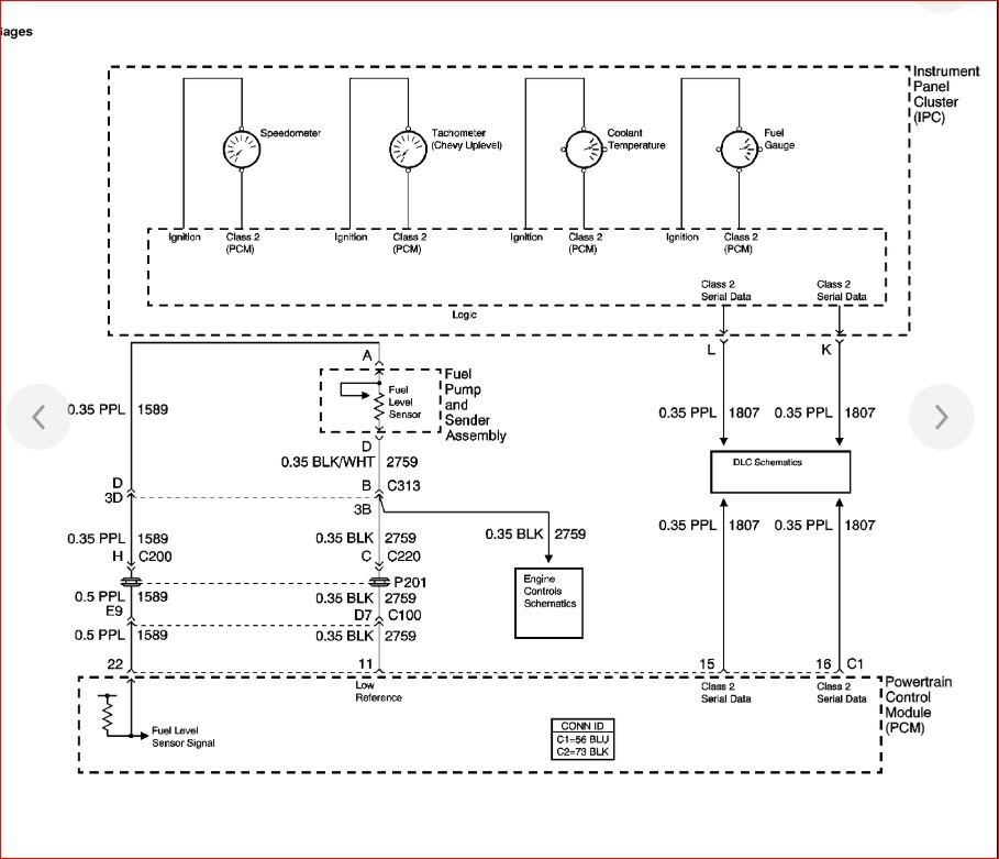

It sounds like the printed circuit board or the stepper motors in the cluster may be faulty in the cluster to be causing an abnormal reading since the car is otherwise running normally. I've attached picture steps below on how to remove and replace the trim to gain access to the cluster as well as remove and replace the cluster itself on your Cavalier. Some places like speedometer shops can repair instrument clusters. Depending on the area you live and which type of shop doing the repairs average shop labor is about $100 an hour labor. Hope this helps and thanks for using 2CarPros.

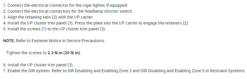

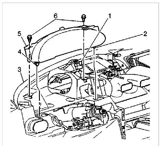

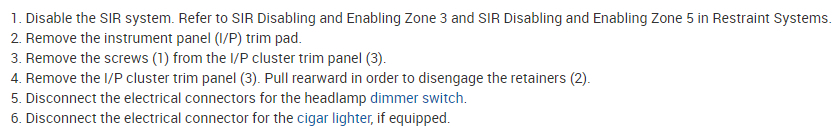

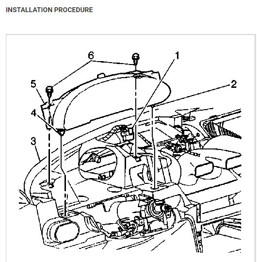

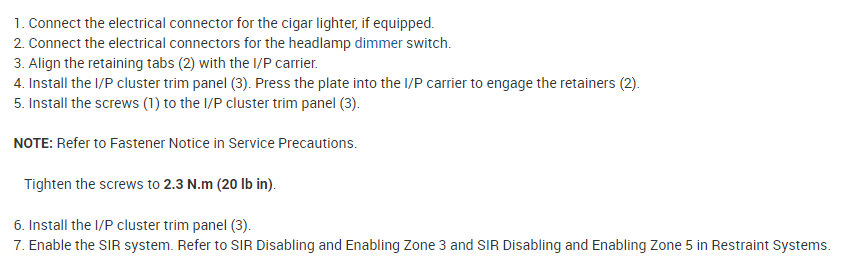

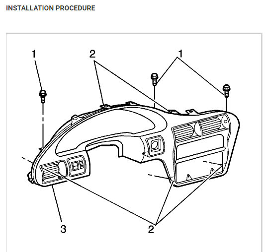

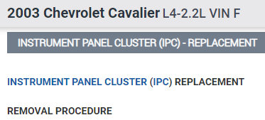

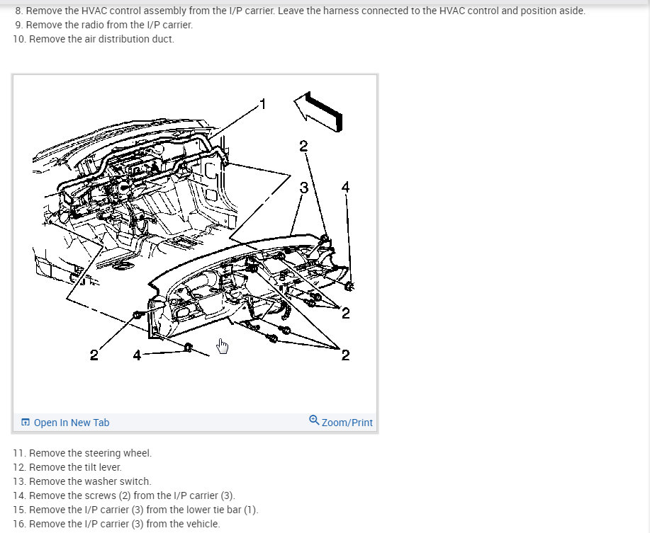

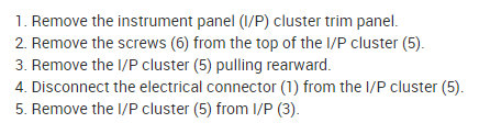

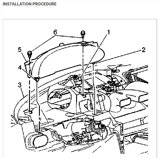

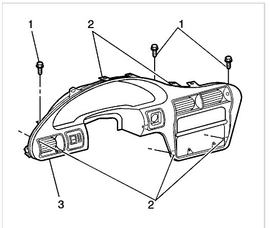

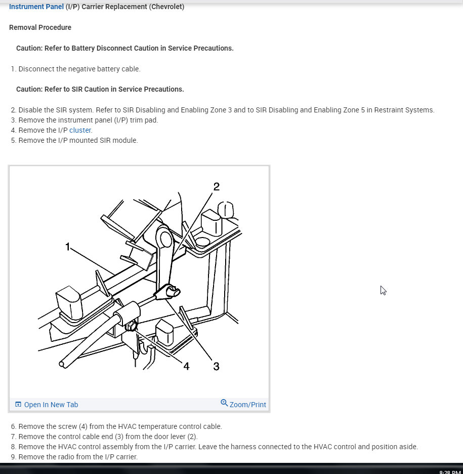

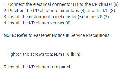

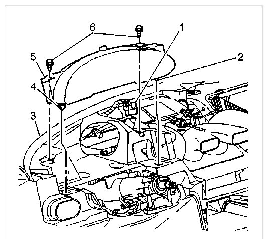

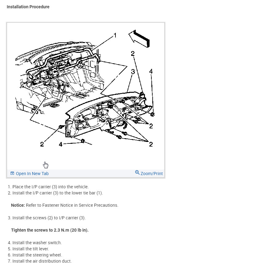

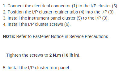

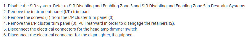

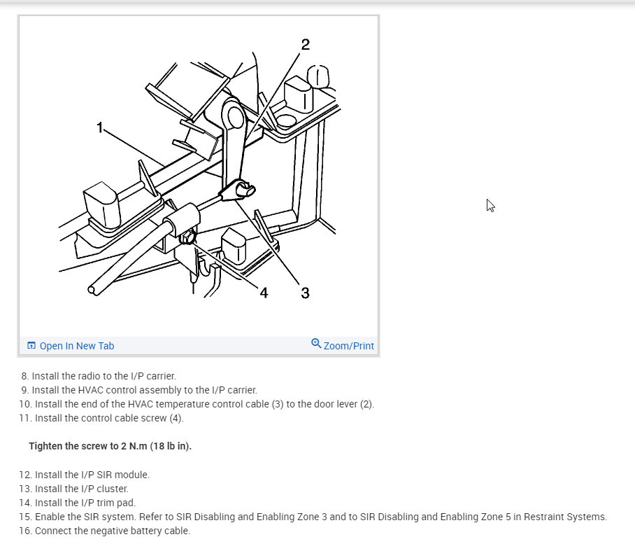

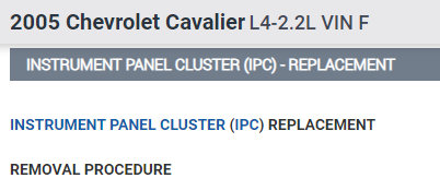

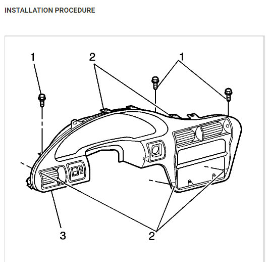

Each of these issues points to a cluster issue. The BCM and PCM each send info in for the lighting and gauges separate of each other and it is very unlikely that they are both causing the same issue. Take a look at the wiring diagram and you will see each is separate.
I included the procedure to replace the cluster which if it were me, this is what I would do and go from there. Thanks

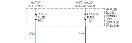

  • 16,542 POSTS
check 10 amp fuse labeled CLUSTER, in the instrument panel fuse block (on driver's side of instrument panel)

This seems to be an ancient thread, but I ran across it after I had a similar problem and have solved it, so thought I would post a reply. I knocked out my instrument cluster when replacing the battery, and pulling the battery leads, holding them together, and whatever did not work. Pulling and reinstalling the obvious "cluster" fuse did not help either. Haynes notes two fuses going into the instrument cluster microprocessor -- "cluster" and "CLS/PCM". The latter does not seem to exist on my car, but I have got a "BCM/CLU".
Long story short, turned the ignition to "run", pulled the BCM/CLU fuse, put it back in, and everything is alive. Looks like this gives the instrument cluster microprocessor the clean start it so desperately craves.
Jul 8, 2021 at 3:27 AM (Merged)
KSCULLIN
I had already tried everything else listed (checking fuses, disconnecting battery, etc); got the the pulling the fuses with the ignition "on" steps and tried that. I had to pull both the "BCM/CLU" and "cluster" fuses and replace them with the ignition still "on" to get it to work. By the way, I also got a jump from a drained battery.
This may be significant; I pulled the BCM/CLU fuse first, then the cluster fuse and replaced them in FIFO order (BCM/CLU fuse first, then the cluster fuse).

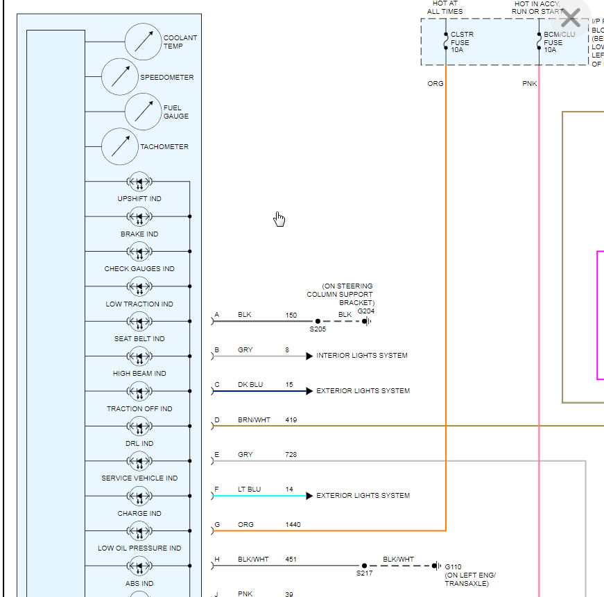

FARMERJOE
  • 15 POSTS

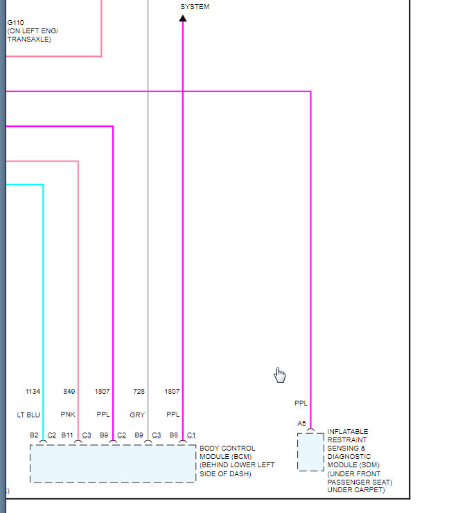

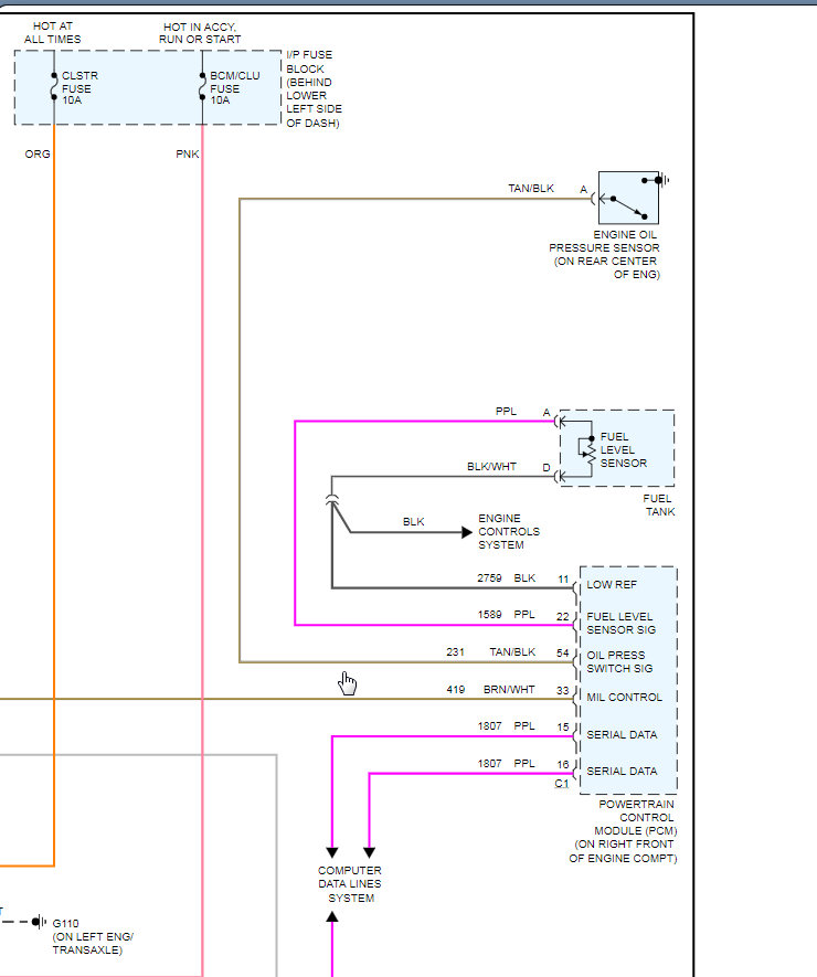

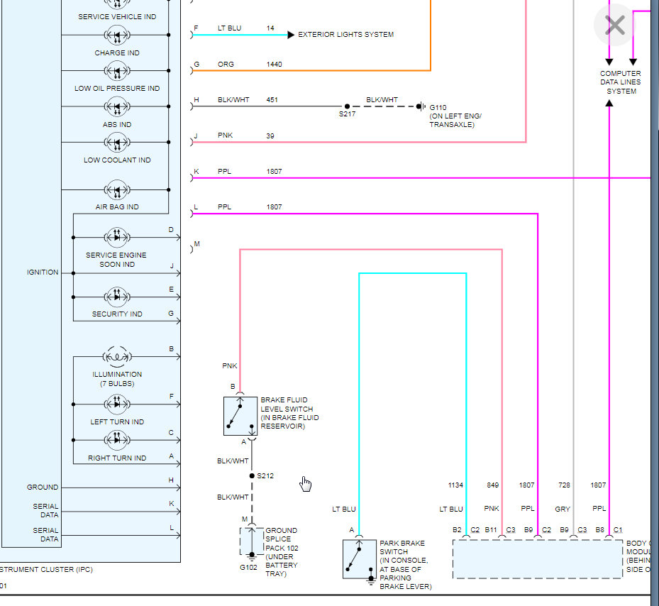

Wife was driving the car, smelled a funny burnt plastic odor and the dash gauges quit working, the turn signals work but the alternator light is on the car runs and starts.

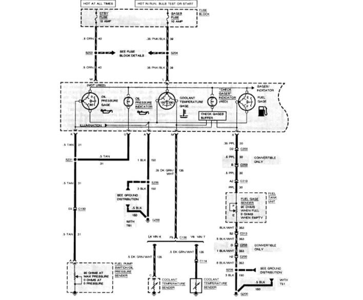

Good morning.
Attached is a diagram of your cluster. check the two fuses listed for power on both sides.
The smell concerns me. it sounds like the alternator may have failed. if the light is on, then there is a problem.
do you have a voltmeter to check the voltage at the battery while the engine is running?
