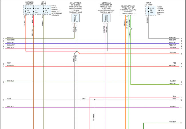

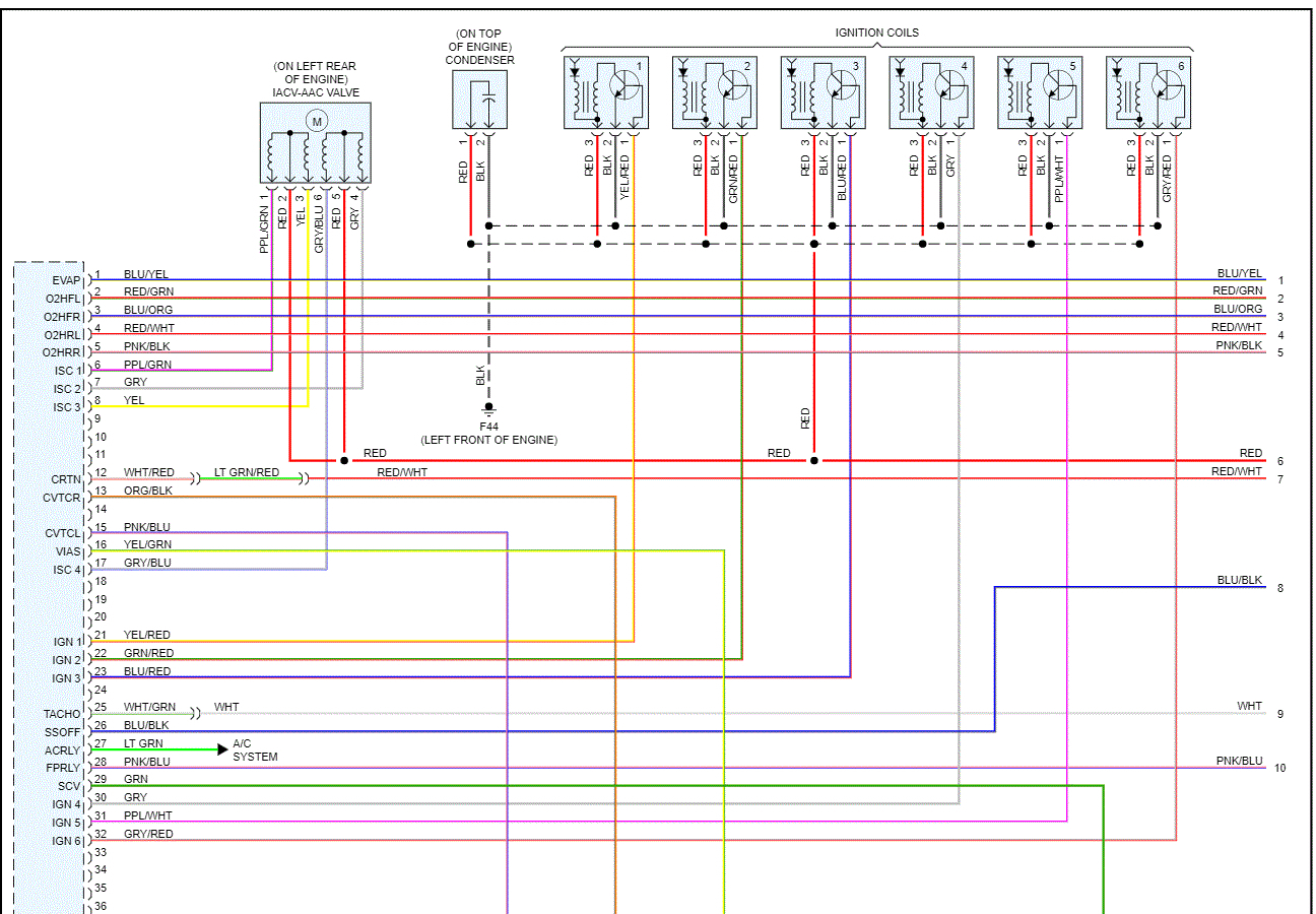

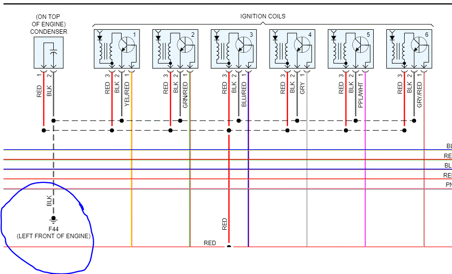

This issue started after changing a new engine then no spark after I discovered that the brain box flash out and seized. service soon light there for I bought another brain box program, the key light went off as it means the key programming is okay. yet no spark in all coils. open current to the crank,camshaft sensors and coils are available also the ground N to all the coils and sensors available as well. please help what could be the problem? Thanks, Busy!!!
Jun 19, 2020 at 5:46 AM
  • 110,240 POSTS

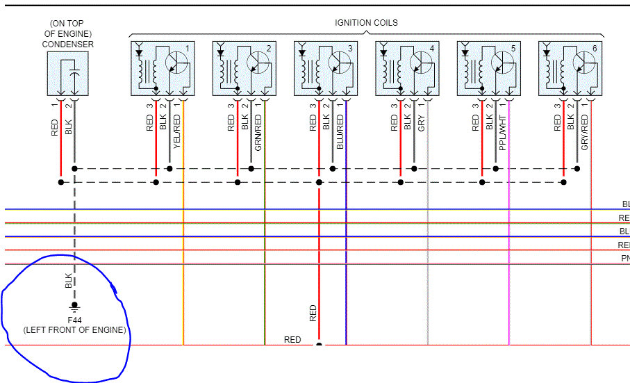

When you say there is an open circuit to the crank, what do you mean? An open means no continuity in a wire, Please explain. Also, the ground to all coils is common. Are you certain it is tight, clean, and in good condition? See pic 1

To your first question, I said open current, I mean an ignition current output when you switch the ignition On, your second question, yes the ground are tight and clean, I added more ground from chassis to engine,
Your last question, the engine aren't of the same year model but their closely similar with little differences and the difference is the old is carrying 2 camshaft sensor while newer engine is infinity Qx4 and its having additional sensor of two wire at the front of the engine on the timing cover by the right if you are facing the car,I also learned that the throttle body is not clipping as it use to normally but the ETCC fuse is normal. please I need a guide on how to get a spark on the coils. .

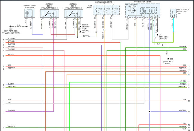

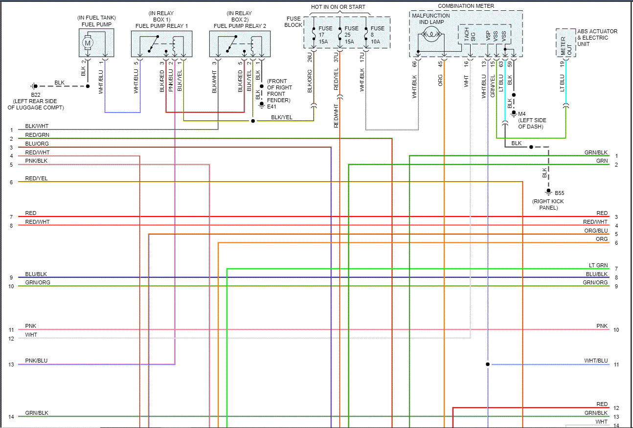

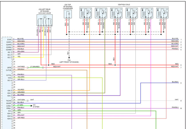

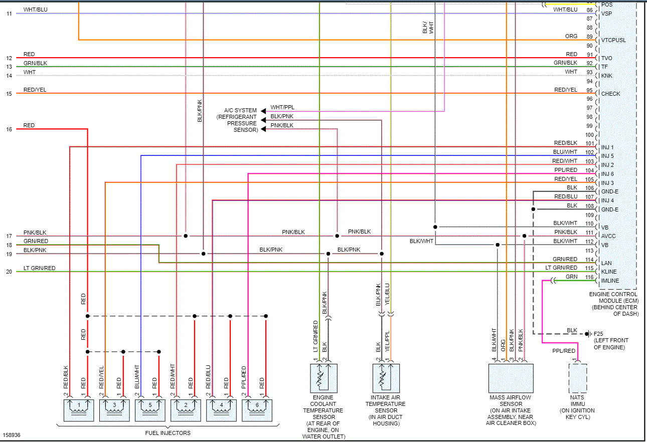

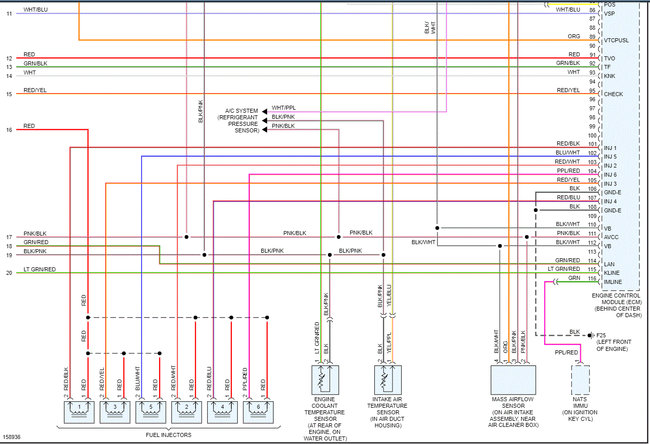

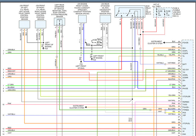

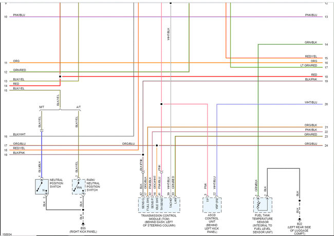

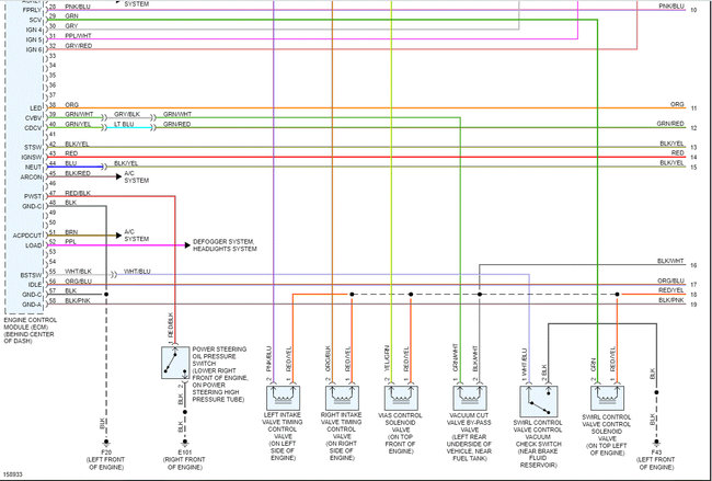

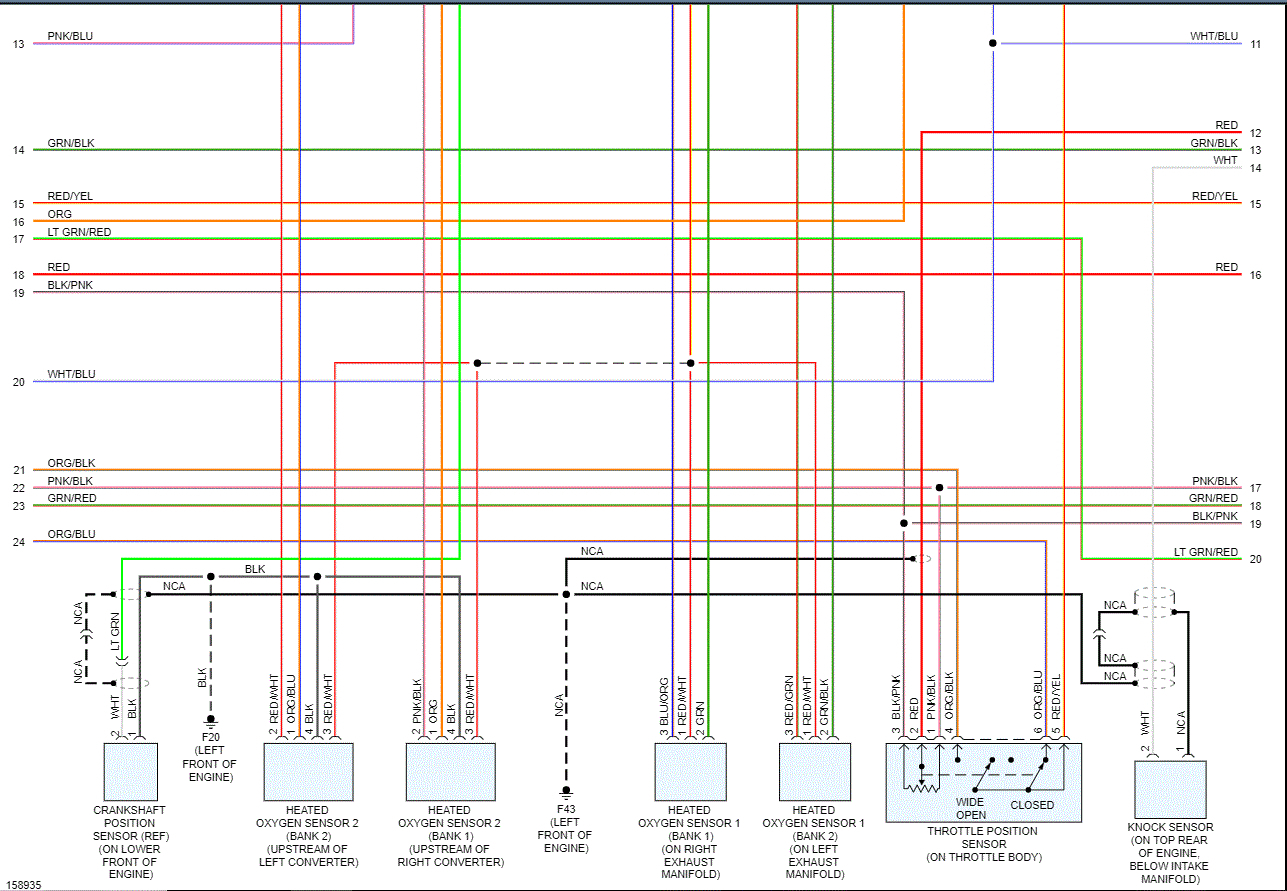

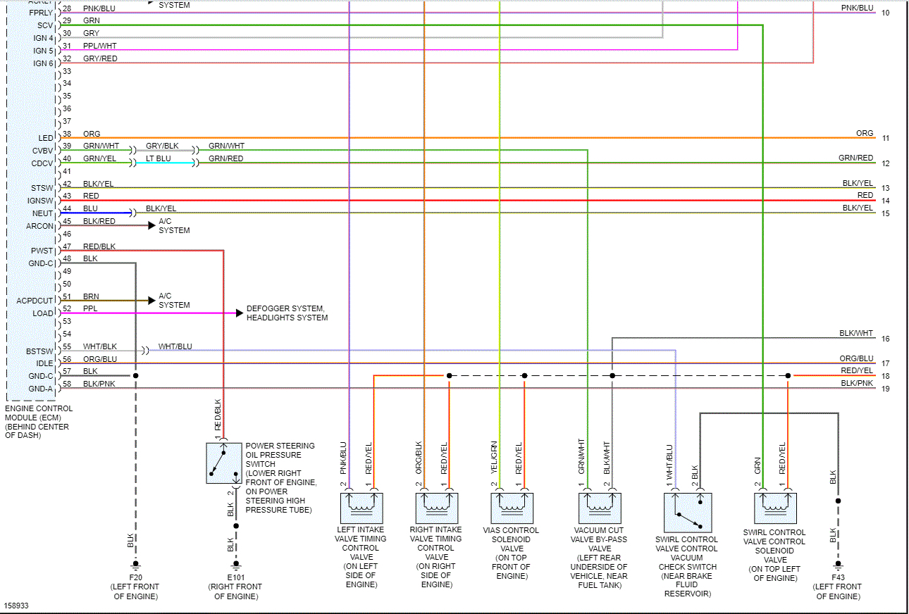

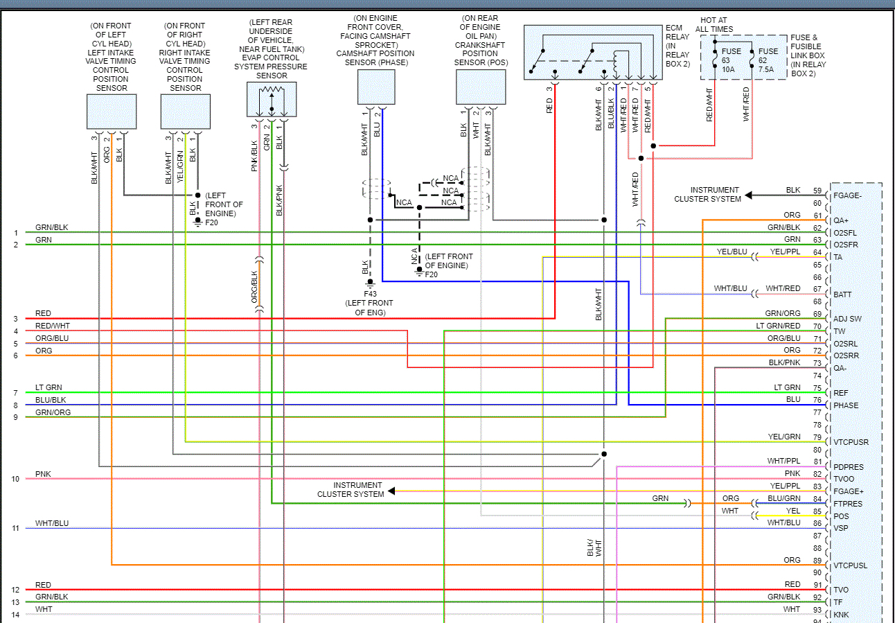

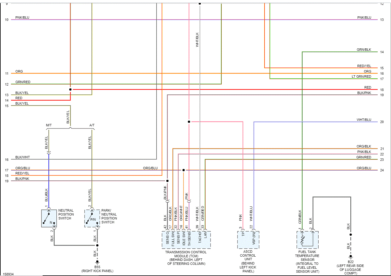

I attached the entire wiring schematic for the power-train management for the Nissan. I overlapped them so you could follow them. Let me know if that helps.
As far as the sensors being different, see if the part from the old engine can be switched. Hopefully the design isn't much different.
