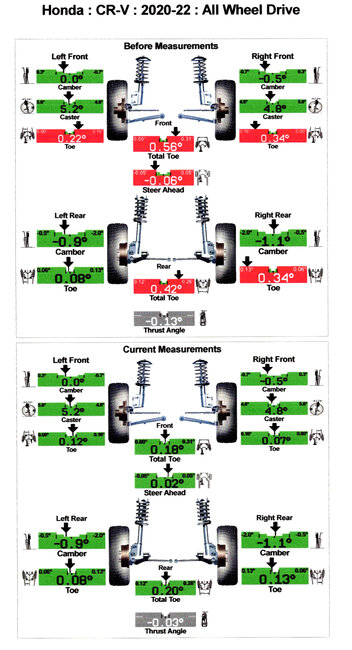

I just had the "product upgrade' steering rack recall installed.
As part of that the dealer had to do an alignment.
The before and after readout of the alignment specs left me wondering if I need to go back and have them redo it.
My specific concern is the thrust angle in the after readout. My limited understanding is that the thrust angle should be 0.0 degrees.
Mine is 0.03 degrees so the front and rear wheels are not exactly lined up with each other.
Please see the attachment.
Should I complain??

When you check the thrust angle, in a perfect world, it should be 0.0 degrees. If you can imagine an imaginary line drawn perpendicular to the center of the rear axle and down the center of the vehicle and to the front axle, both axles would be perfectly centered.
This is used to make sure both the front and rear wheels are perfectly in line with each other and centered to prevent what is called tracking. Also, it is used to make sure the wheelbase (distances between the front and rear wheels) is equal.
Should it be 0.0? Yes, it should. Will 0.03 hurt? In reality, which is 3/10 of one degree, so basically, it is virtually nothing. But you certainly have a right to have it set to 0.0.

What I would suggest is to drop off a box of donuts, or cookies, (chocolate chip were my favorite), in thanks for doing such a good job. There are always a range of tolerances for each value, and your alignment shows you had a pretty conscientious mechanic. Thank you for posting the printout. I thought I was the only alignment specialist who left one in every vehicle.
"Caster" on the front wheels is not adjustable on about 99 percent of front-wheel-drive cars, and it usually doesn't need to be. "Camber" on all four wheels is commonly not adjustable on the majority of import models. When it is not in specs, it is usually due to sagged coil springs due to age, not mileage. The lower ride height changes the geometric relationship of the suspension parts. When that happens, even an alignment to include readjusting camber won't solve a bad tire wear problem. Only new springs will fix that.
In this case the mechanic left camber on all four wheels just as they came from the factory.
That is to be expected. It appears he tweaked right rear toe to bring it into specs. That is not part of this repair. If he did that, it was on his own time to make the final product as good as possible. It is also real common for the slip plates on the alignment hoist to stick from dirt or rust buildup. Those need to slide around freely from the slightest touch. That can cause the alignment measurements to change from things like opening and closing a door, tugging on an adjustment, or simply tightening a bolt.
The first thing I noticed is your mechanic has his alignment computer set to read each measurement to two places after the decimal point. That makes for real precise measurements at the huge cost of having to take a lot more time on each car. They can be set to read to just tenths of a degree. That is done by people who are more interested in speed, to get more cars in and out each day, than for customer satisfaction. I always had my computers set to read to hundredths of a degree. For reference, back as far as the late 1980s, mechanical alignment equipment could barely read to 1/16 degree with any precision, but that was good enough for old, heavy, rear-wheel-drive vehicles. Now we're reading to the hundredth of a degree.
Another thing to be aware of is the alignment computer can be set to tighten up the range of tolerances that are displayed. That means each adjustment has to be closer to "perfect" before the number turns green on the display. If that is not done, any value shown in green is okay, meaning it's within specs. If the "reduce tolerances" button is pressed, it means for a value to be shown in green, it has to be even closer to "perfect", or really, really okay. I can't tell if that was done here, but the tolerance readings typically would not be reduced for a warranty alignment or when checking a vehicle as it came from the factory. Most cars don't require that level of precision.
Also be aware with the level of precision alignment computers provide, you will never get every value perfect. To try to do that would be like building a house and demanding the final product be within 1/16" of the design. There's just too many variables even with all the precision in the world. You're correct that rear thrust angle should be 0.0 degrees, but if you check 100 cars, not one will actually have that. Your car is showing .03 degrees, which, if rounded off, is 0.0 degrees, as you listed. Your mechanic is measuring to a second decimal place for more precision, but he will never get it to 0.00 degrees. This is so close to perfect, I would be thrilled if all of my alignments were that good. Also note the value is shown in gray meaning the manufacturer doesn't even supply or specify a spec for that value. It's only purpose for even being measured is so the computer can show the mechanic where to adjust front toe to set each wheel perfectly parallel to the rear wheels. That's to ensure the steering wheel is straight. Rear toe is not adjustable on a lot of front-wheel-drive vehicles, and never on vehicles with a solid rear axle. It still gets measured automatically so the computer knows where to have us adjust front toe, but it's not uncommon to find a thrust angle of a half inch, (1.00 degree). While that may sound like a lot, it's not nearly enough for someone following you to notice "dog-tracking". By the time you can notice that on another car, thrust angle is going to be a good couple of inches.
I must apologize here. I always set my computers to read toe in inches and fractions of an inch. They can also be set to read toe in degrees, as has been done here. I can relate one form of measurement to the other, but not good enough to describe it. Basically what it comes down to is the back of your car is offset from the front by roughly 1/128 of an inch. With that level of precision, a butterfly on your mirror will change those values. Simply opening a door a few inches will change some of the measurements a lot due to the weight transfer in the car body.
If the alignment was okay before the service, the only thing that needs to be adjusted when replacing the rack and pinion steering gear is "front toe" on each front wheel. To get those into specs takes the better part of a minute on each wheel. To get them so close to perfect, as you have here, takes longer, but the value we're most interested in is the "Steer ahead". When that is 0.0, it means overall, the two front wheels are parallel to the two rear wheels. That is adjusted when the steering wheel is locked in the straight, or level, orientation. To say that a different way, imagine you have all four wheel perfectly parallel to each other and the steering wheel is perfectly straight when you're going down the road. Now imagine you lift the seat up and turn it a little, then set it back down. You may feel crooked, but the wheels, steering wheel, alignment, and tire wear haven't changed. Your thrust angle would be off a lot, but the "steer ahead" angle would still be right on the money.
For my last comment of value, be aware all these numbers on the printout only apply to a vehicle that is standing still, and with no load. All of these number will go so far into the red when a driver sits in it that no amount of adjustment can bring them back to specs. What the specifications say is if you set them to the values shown when the car is standing still, that will result in the best tire wear and handling when it is being driven on the highway. Now consider the wide range of weight difference and distribution depending on who is driving and how many passengers you have. Instead, there's three things you need to look at. The first is the steering wheel should be straight when you're driving on a straight road. The second is the car should keep going straight when you let go of the steering wheel. That is a function of camber. It should be nearly equal on both front tires. They want to pull in the direction they're leaning. We want both pulls to be equal to offset each other. The third thing is tire wear, but that takes some time to show up. With the numbers on your printout, tire wear should be very good. That's a whole different topic we can cover later, if necessary. For now, check out this article:

Very thorough answer that has put my mind at rest. Basically, where I was coming from was that the car is new and this 'product upgrade'/recall required the mechanic to take apart much of the front end, e.g. drive shafts, front sub frame, etc. etc. Honda paid 2.5 hours which seemed cheap to me to take all this apart and reassemble it. I was concerned that Honda cheaping out caused the mechanic to not be as diligent as he might have been. You have told me this was absolutely not the case; I have already apologized in my head for those thoughts [I never expressed them].
Thank you very much!!
