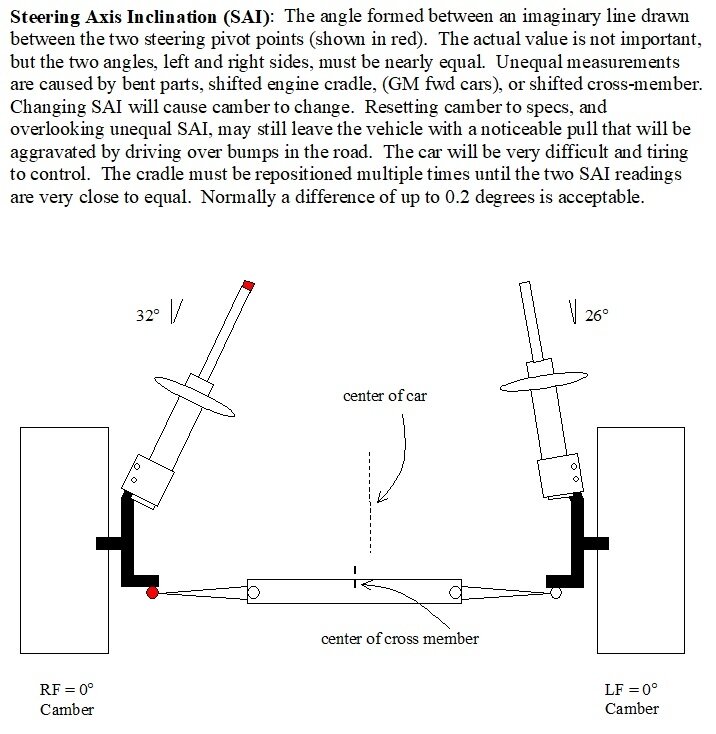

The drawing below is a copy of one of my "Notes Pages" I handed out in class relating to SAI. This is greatly exaggerated for clarity. The SAI is an imaginary line drawn through the two steering pivots as viewed from in front of the car. On older cars and trucks, that was a line through the upper and lower ball joints. On smaller cars that line runs through the lower ball joint and the upper strut mount. When reassembled, those upper strut mounts have to go back to their original orientations. It's the lower pivot points, those lower ball joints, that get moved off to one side when the cradle they're attached to gets installed off-center. This view is from in front of the car looking back at it. Both heavy black spindles, what the wheels are attached to, were moved to the left in the drawing, (passenger side on the car), but camber was readjusted at the bottoms of the struts to position them straight up and down again. That brought camber back to 0 degrees in this example, but it didn't address SAI which is 32 degrees on one side and 26 degrees on the other. That is what has to be measured and corrected as the very first step of this "special" alignment. With experience that can be corrected in ten to fifteen minutes. Often it's more frustrating and can take a lot longer. We have to loosen and slide the cradle a little, tighten the bolts, measure "caster", another of the three main alignment angles, by turning the wheels to one side, taking a reading, turning the wheels to the other side, taking another reading, then letting the computer calculate those values for each front wheel. That might sound simple, but each time we take those readings can involve another ten minutes, and it's not uncommon to have to do that over a half dozen times. Caster and SAI are two alignment angles that can not be observed changing on the computer screen as we make the adjustments. We have to make the adjustments, then take a series of readings, then let the computer figure out if we made it better or worse.
To remove a little confusion, camber is the inward or outward tilt of the wheels, as viewed from in front or in back of the car. You'd think we want the wheels to be perfectly straight up and down, which would be 0.00 degrees, but most models call for slightly positive camber, meaning the wheels are tipped out a little on top. That's done for best tire wear, and it places most the vehicle's weight directly over the wheel bearings which reduces stress on them. Once SAI has been corrected, we can start with the regular part of the alignment. That is to readjust camber to specs. It's also critical it be the same on both sides. Tires want to roll in the direction they're leaning. By making camber equal, the two pulls offset each other, and the car goes straight.
No spec is given for SAI. The only requirement is it must be the same on both sides. A typical value is around 28 degrees. On your car that would be the angle the struts are tipped in on top. Most manufacturers specify the two readings must have a difference of no more than 0.2 degrees. Shifting the cross member to one side as little as 1/8" changes that difference way more than 0.2 degrees, so you can see it's a very precise and difficult adjustment to achieve.

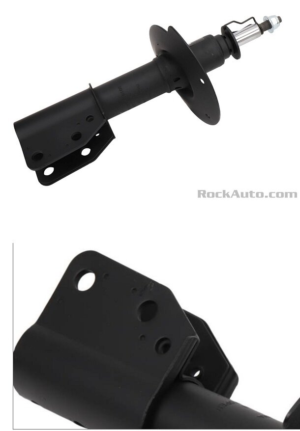

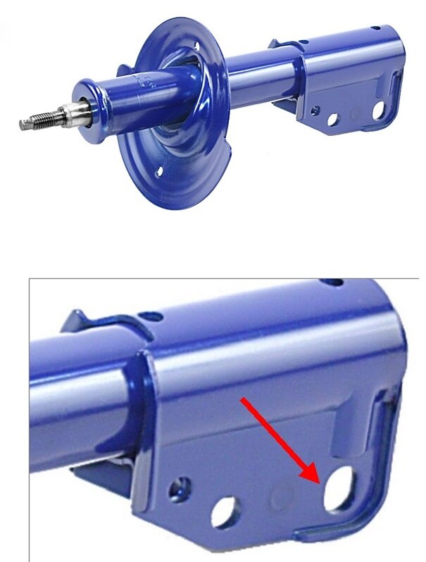

The last possibility that I already eluded to is the need to make a front wheel adjustable. That is done by grinding the lower of the two lower strut mounting holes oval-shaped. Chrysler and Toyota struts come with those holes elongated from the factory. GMs have to be ground out with a die grinder and special metal-cutting bit. That too only needs to be done once, but it may need to be done again when the struts are replaced. Some aftermarket struts come with those holes already elongated. The second photo below shows a Delco replacement front strut for your car. Both mounting holes are round, so no camber adjustment is possible until the lower hole is modified. The third photo shows the same strut from an aftermarket supplier, Monroe in this case, which is a huge supplier of high-quality shock absorbers and struts. My red arrow is pointing to the elongated hole they come with from the factory. No modification is needed to allow camber to be adjusted.
