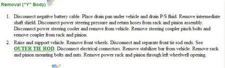

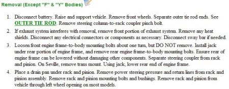

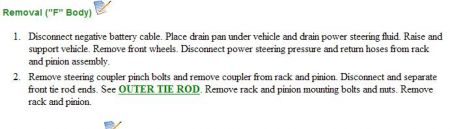

How do you remove the rack and pinion out of the left side? The pressure line, return line, tie rods, and mounting bolts are removed . It is loose and ready to be taken out but the space is too small. How do I get more room to get it out?
Nov 28, 2009 at 8:48 PM
MHPAUTOS
  • 31,937 POSTS
Hi there, See text for removal of rack assembly. mark (mhpautos)
