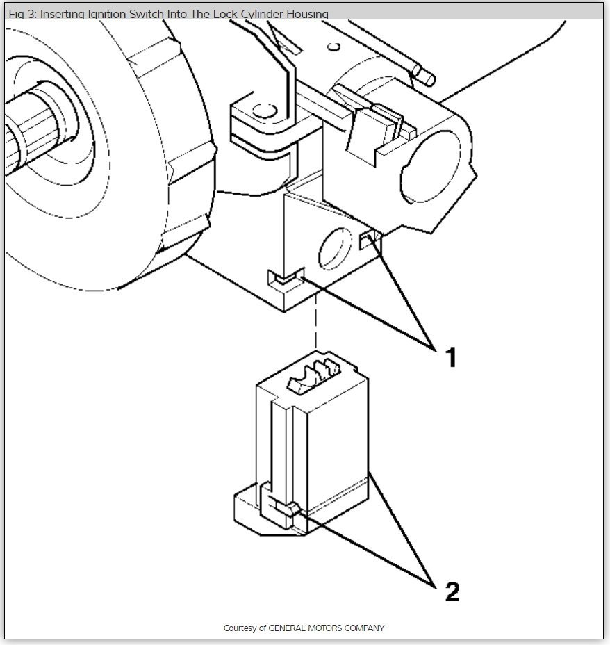

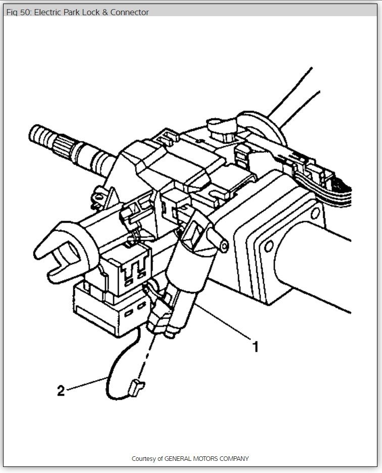

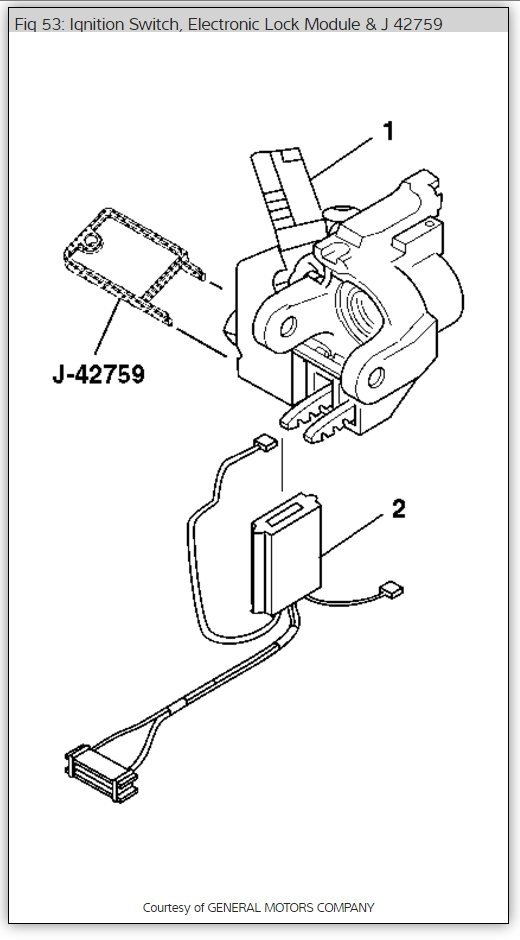

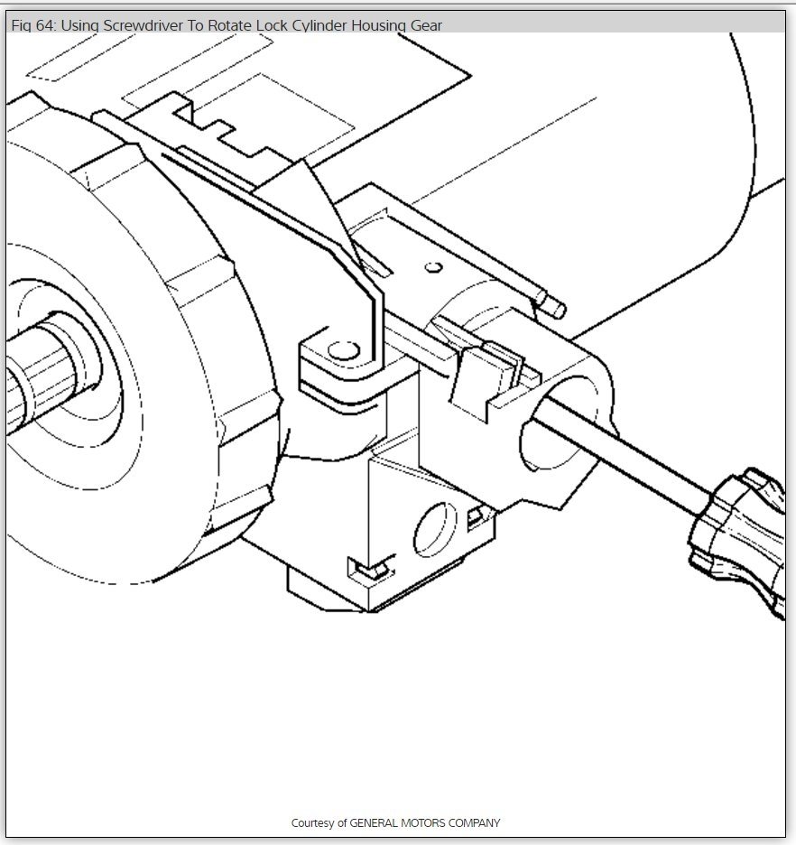

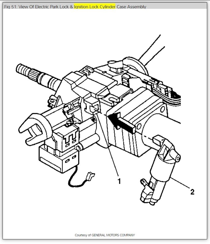

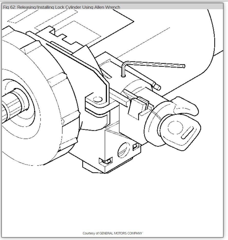

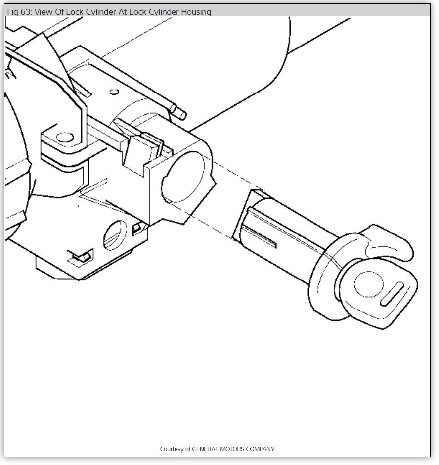

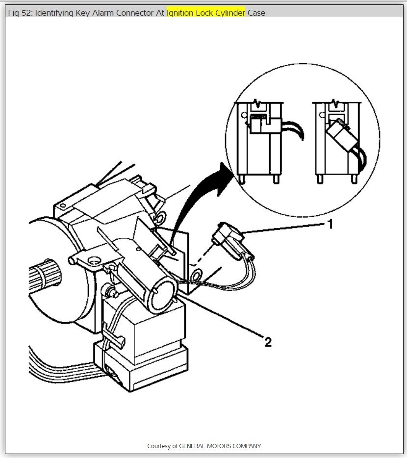

It could be one of a few problems, First follow this guide to go over the obvious.
https://www.2carpros.com/articles/ignition-switch-wont-turn-stuck
But is it probably becasue the key is worn out and needs replacement, here is some guides (BELOW) to help you get the problem fixed.
