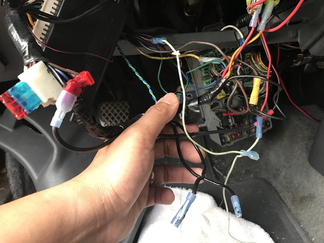

Did try it, but no luck. i bought the car with an after market alarm on it, and some of its wires are not connected anymore. if i disable the alarm by removing all its connections do you think it will work or do i need to put back all the wires that are disconnected?

well thereis a factory alarm on that and by changing what you did originally is why I said I tmay need programming by a mechanic to run. a lot of these systems shut off spark or fuel so i'd really recommend going to a mechanic so he can hook his scanner up and see what is going on.

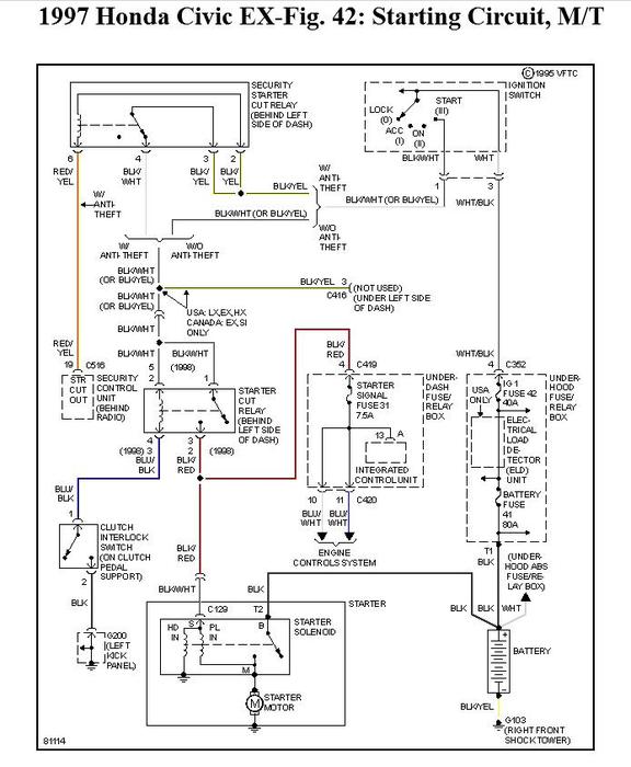

Here is the update..we think that this is not the immobilizer issue.did put back the old immobilizer,and we spray with starting fluid and the car run for 2-3 seconds....we scan for code and we only have the P0113-intake air temp.sensor...we check the crank sensor connector,and we have constant voltage and a ground..we checked the triggering signal by turning the crank pulley by hand,we have a 5 volts but...when we turn it by hand wouldnt go ON and OFF...its just stay on 5 volts...are these diagnosis goin to bad crank sensor...thank u..

I told the technician about that,maybe the immobilizer...but he keep saying that its not..coz the car starts when he put starting fluid...he is saying that the crank sensor is bad because he cant get injection pulse and spark for the coil...i called honda and they said they need the car but the problem is its not running...i did try the immobilizer bypas code..but after i turned the key to lock,the green key stay lit for atleast 15 to 20 seconds..please,help me on this..thank u

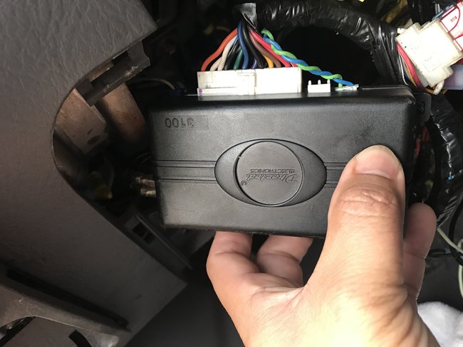

Hi ken thank you...we did checked everything..checked the crank sensor by turning the pulley by hand...reading gors to 0 to 6.7 volts..replaced cams sensor still no luck...before,the old immobilizer unit when i turn key on the green key light is not flushing at all...and then bought new immobilizer unit online and put it in...now the green key light keep blinking...

Is that alarm after market? it looks like it is.

Yes it is...do you know where can i put a fuel port so that i can check the fuel pressure..coz the mechanic just used his thum to check the pressur..im just wondering coz it start with a starting fluid...thanks a lot for you guys time

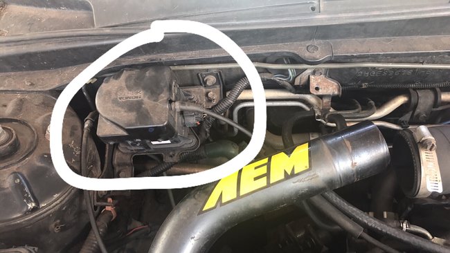

BRYAN08
  • 12 POSTS

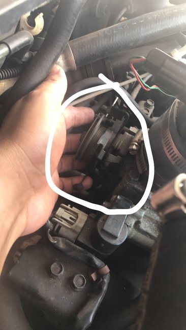

Ei ken...i found a disconnected cable...attached photo...i dont know if its connected for the car not to run
Jan 4, 2021 at 4:24 AM (Merged)

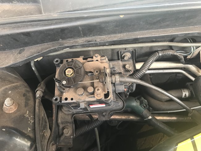

BRYAN08
  • 12 POSTS
I removed the cover to expose the inside...th
  • 55,721 POSTS
This is the cruise control, does nothing to keep the car from running.
