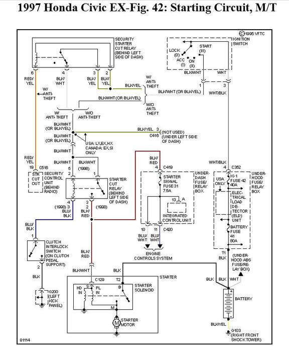

I have a 97 honda civic 5 speed won't crank lights turn on battery and starter is good alarm light on all the time
Oct 27, 2020 at 4:28 AM (Merged)
ACOSTAAE
  • 14 POSTS
O yeah n it starts up good when u push jump Start it
start with a battery test first before going anywhere. it may a simple repair. basics first.
KHLOW2008
  • 41,812 POSTS
If you do not have even a slight click while turning the key, it most probably is not the starter or battery. The immobilizer would be the cause.
Try using a remote wire to jump the starter solenoid with battery voltage to test if it cranks.
ACOSTAAE
  • 14 POSTS
All I get is humming noise under the dash. Could it be the ignition switch
KHLOW2008
  • 41,812 POSTS
Guessing doen not work. You need to perform tests to find out. Get a testlight ready and have you done as advised?

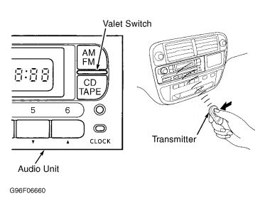

the alarm will not let the car start, I have bought a new battery for the keyless entry. every thing turns on but the car will not start. diasabled the siren but alarm stays on. i have tried removing battery, removing fuses to security system. tried key in the door. how do I disable the security system?
DAVE H
  • 13,383 POSTS
TRANSMITTER PROGRAMMING Insert ignition key into ignition switch. Turn ignition switch to ON position. Within 10 seconds, press and hold valet switch for at least 5 seconds. See Fig. 1 . The sound of lock actuators turning to UNLOCK will be audible. NOTE:If radio tuner is ON, it will go off and come on again when programming procedure is completed. Within 10 seconds, press one of the transmitter buttons. The sound of lock actuators turning to UNLOCK will be audible. Turn ignition switch to OFF position. After storing its code, ensure transmitter works properly by repeatedly pressing one of its buttons. System begins working after pressing any transmitter button 6 times. NOTE:If it is desired to program codes of more than one transmitter, repeat step 2) within 10 seconds with next transmitter. Fig. 1: Storing Transmitter Codes Courtesy of AMERICAN HONDA MOTOR CO., INC.
https://images.2carpros.com/forum/automotive_pictures/266999_valet_1.jpg

K I replaced the starter bypassed it to make sure while key is front and on nuetural n starter just runs by it self. Could it be the flywheel. But it still don't crank. But starts when u push Start it.
ACOSTAAE
  • 14 POSTS
And battery is good.
KHLOW2008
  • 41,812 POSTS
How did you bypass the starter?
ACOSTAAE
  • 14 POSTS
Lol. K im sure a perfessional wouldn't recommend it 0:) but with a screw driver to both bolts. But only did it two times I didn't want to burn it out
KHLOW2008
  • 41,812 POSTS
In one of my previous post I told you to use a remote wire to apply battery voltage to the starter solenoid. That is the proper way. Using a screwdiver and at the wrong terminals, that can mean disaster if anything goes wrong. Under such testing, the starter would run but it is not going to engage as the pinion gear is not being pushed out by the solenoid.
At starter disconnect ONLY the solenoid wire.
Get a piece of wire, add a fuse to it and attach one end to the starter solenoid terminal. Touch the other end to the battery positive terminal and see if it cranks. Remember to have the vehicle in NEUTRAL.
Just for confirmation in case the starter is good. We would be doing other testings from here so I need to be very sure I understand you correctly the present conditions and symptoms.
1. No clicking noise when ignition key is turned to crank engine. True/False.
2. Security light stays on during cranking.
3. Dash indicator lights stays on when turned to On or while cranking.
4. Clicking noise of relay underdash, during ignition on or while cranking?
5. Was anything done prior to this occurring?
We are working on whatever information you have provided and if you do not provide the correct information or do not perform work as we suggested, we would be wasting our time as the desired result is not achieved.
ACOSTAAE
  • 14 POSTS
1. Yes there is no clicking noise.
2. No security light stays on all the time with and without putting the key on.stays completely on even when car is NOT being messed with.
3. Yes
4. Yes
5. No
KHLOW2008
  • 41,812 POSTS
We shall concentrate on the starting circuit for now. The starting system is rather simple and not many items to check. Get a DVOM and test light ready and go through the wiring schematics I have attached to understand the system first.
ACOSTAAE
  • 14 POSTS
The only problem I don't have a test light. Or dvom but I can see if I can buy one in the morning. It's 3 am n Perty tired :) thank u berry much Mr machanic I will let u know manyana thank u again :)
