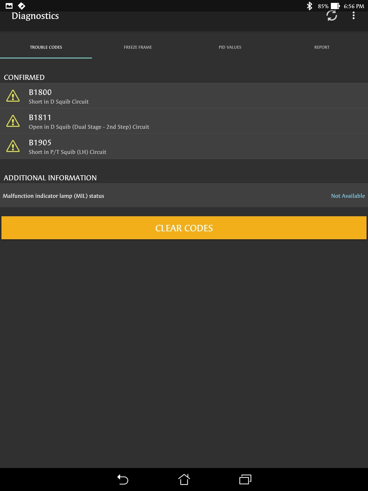

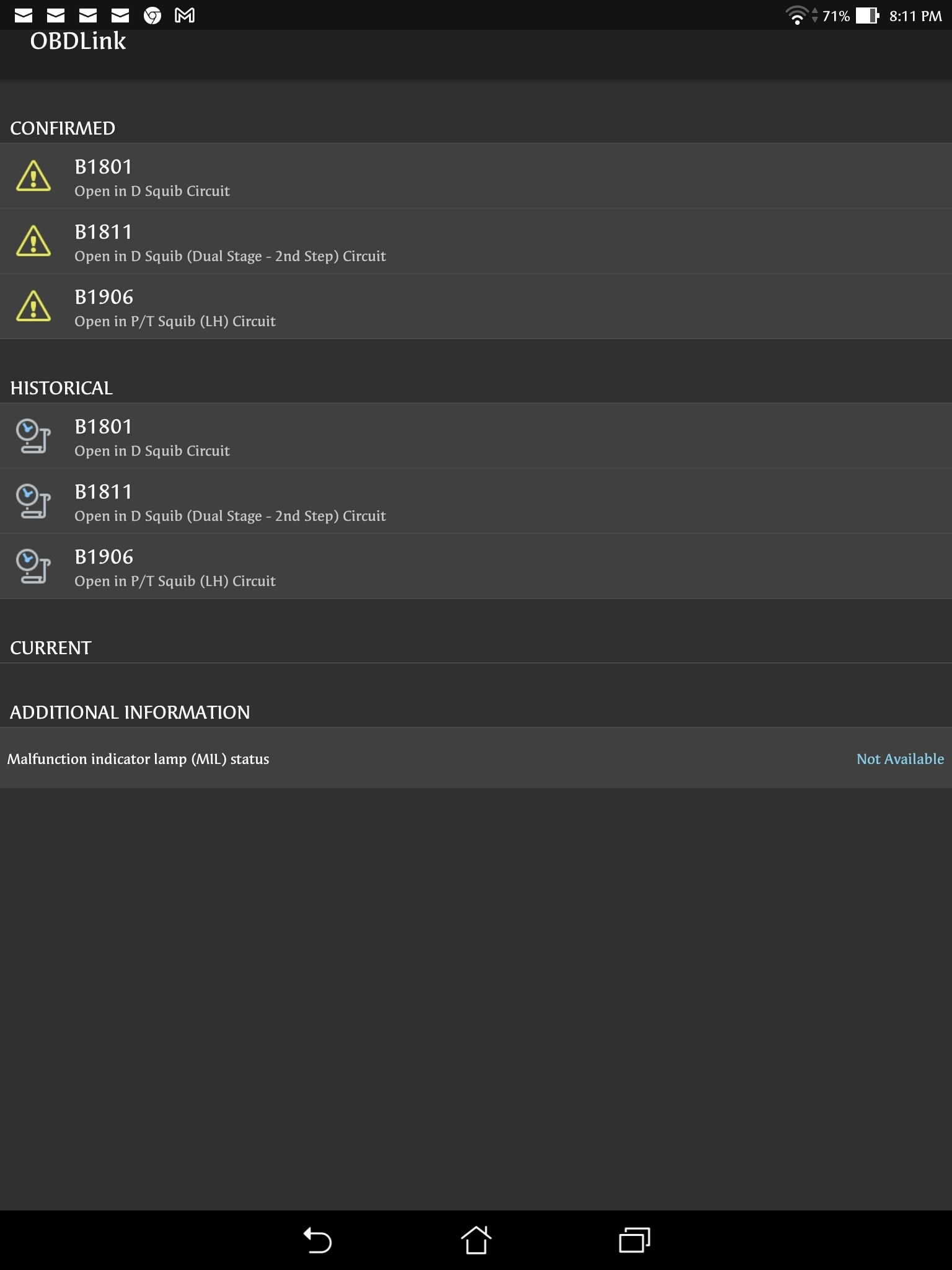

The airbag light of this vehicle turns on and I diagnosed it, and it detects as follows:
1. B1801: Open in driver squib circuit
2. B1811: Open in driver squib circuit second step
3. B1906: Open in pretensioner circuit LH.
Then I began to check, and noticed that the seat belt pretensioner connector was not plugged in, I plugged it in, and changed the spiral cable, and the fault codes changed from:
B1801 changes to B1800
B1811 changes to B1810
B1906 remains, then I loop Positive and Negative circuit with wire, and it changes to B1905.
At this point, I become stocked, is it the steering pad and seat belt that need to be replaced?

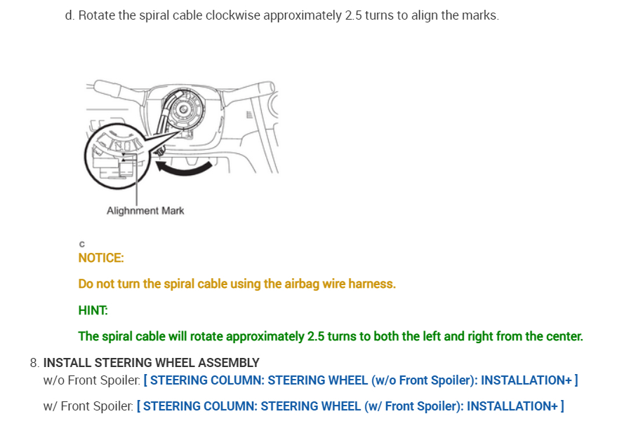

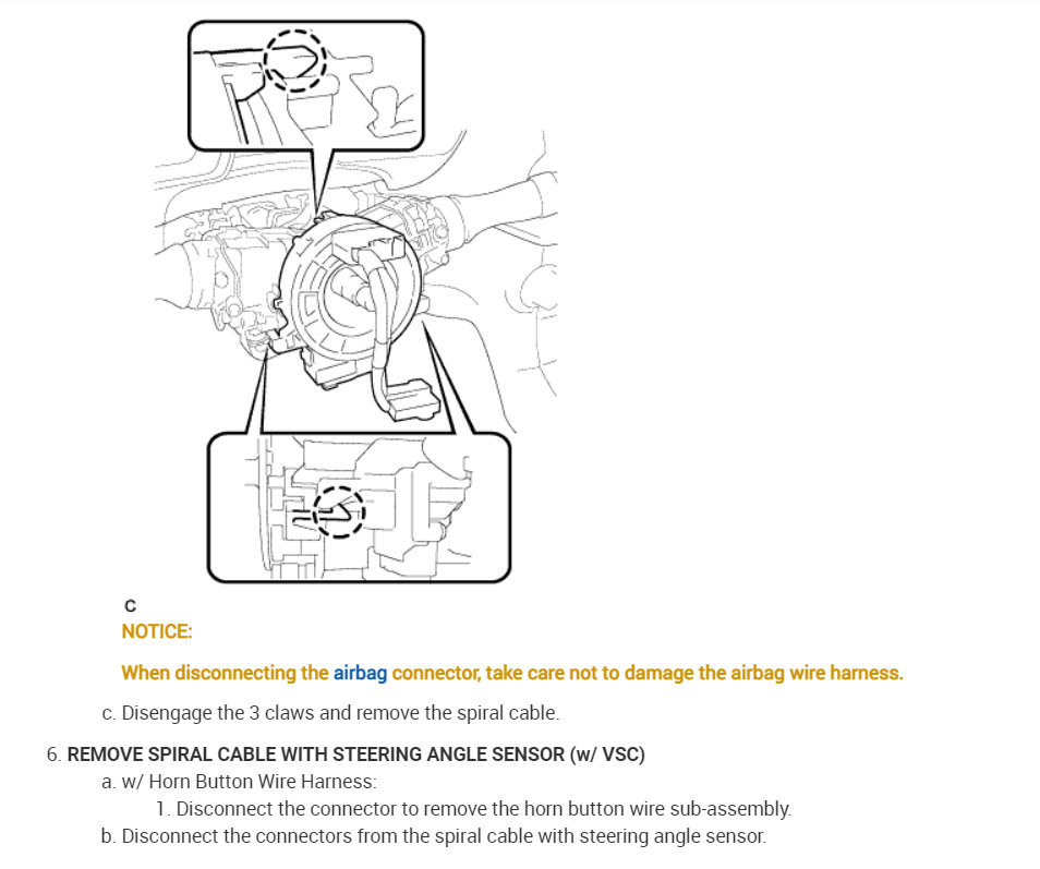

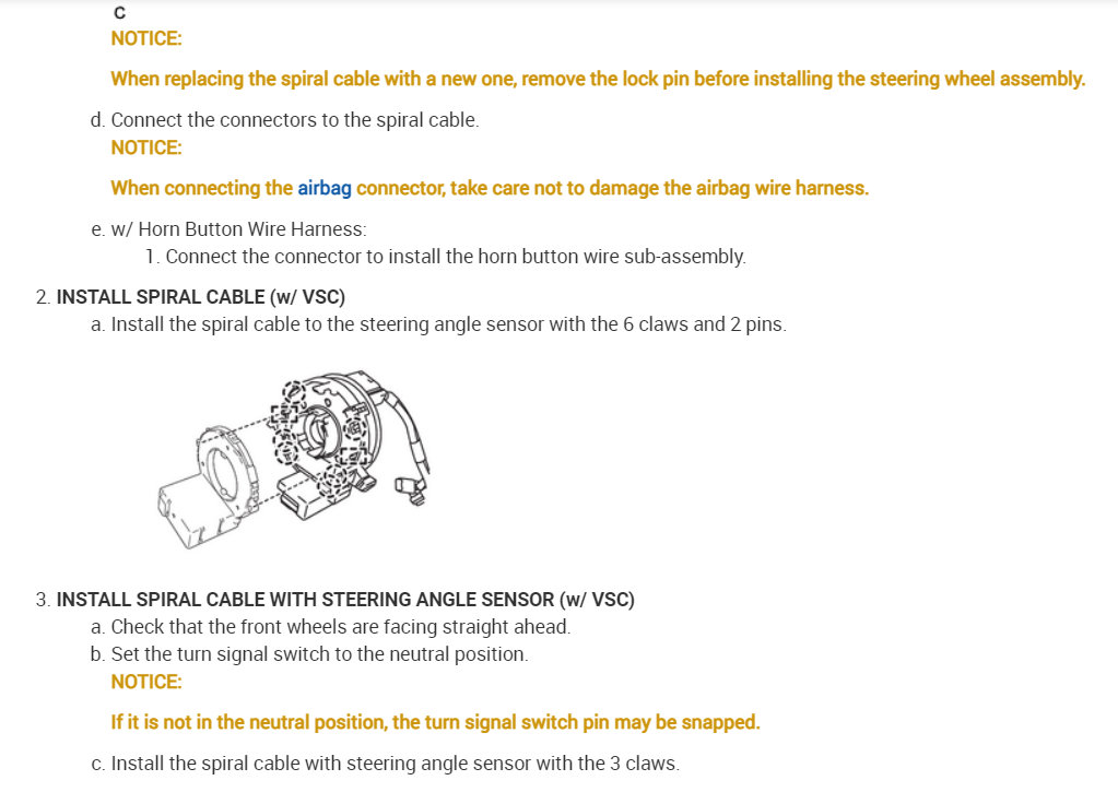

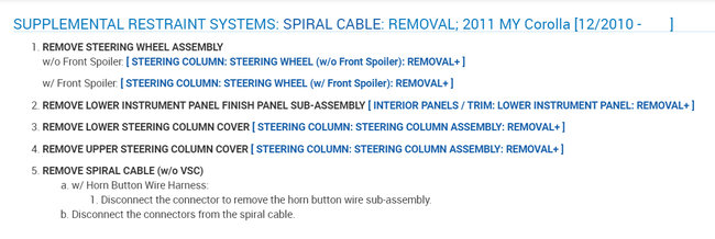

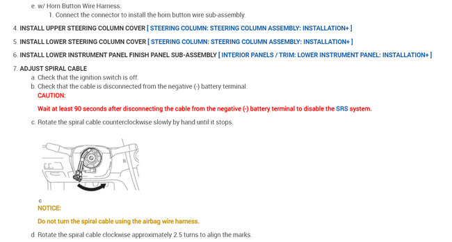

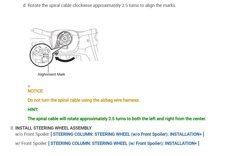

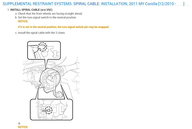

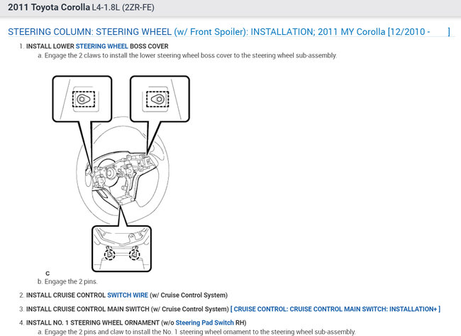

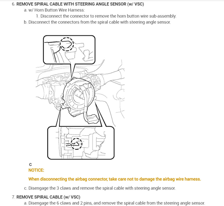

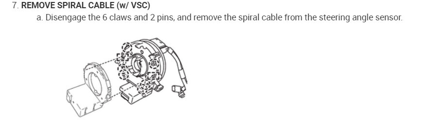

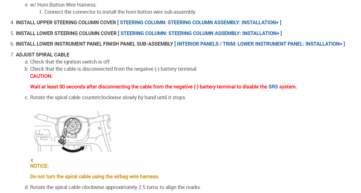

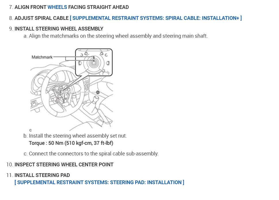

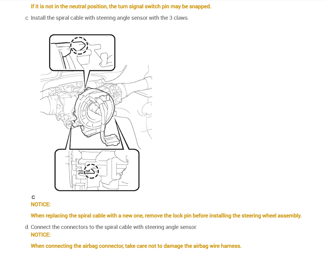

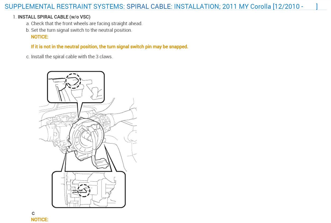

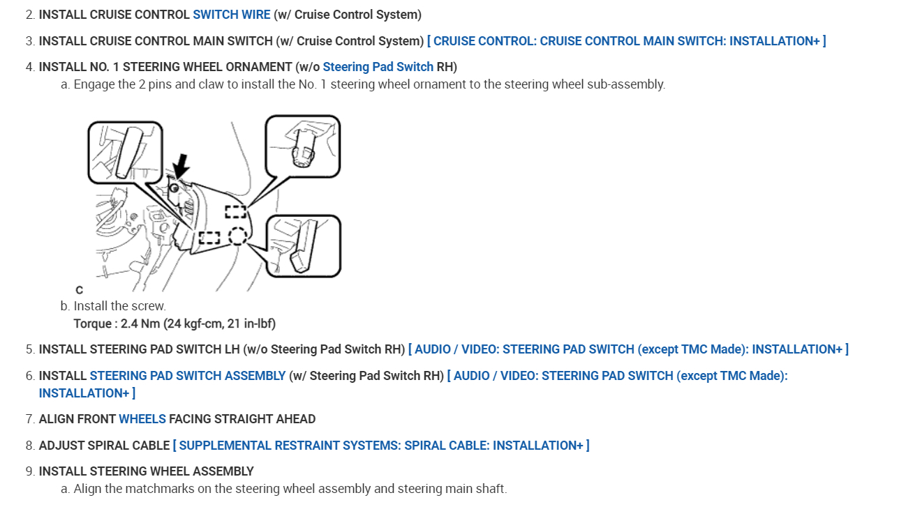

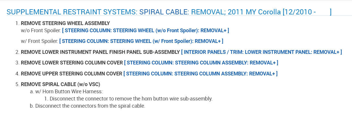

This is common when the clock spring or coil wire (same thing) goes out here is a general guide on how to fix it these specific instructions in the diagrams below to show you how on your car:
https://www.2carpros.com/articles/steering-wheel-clock-spring-removal
