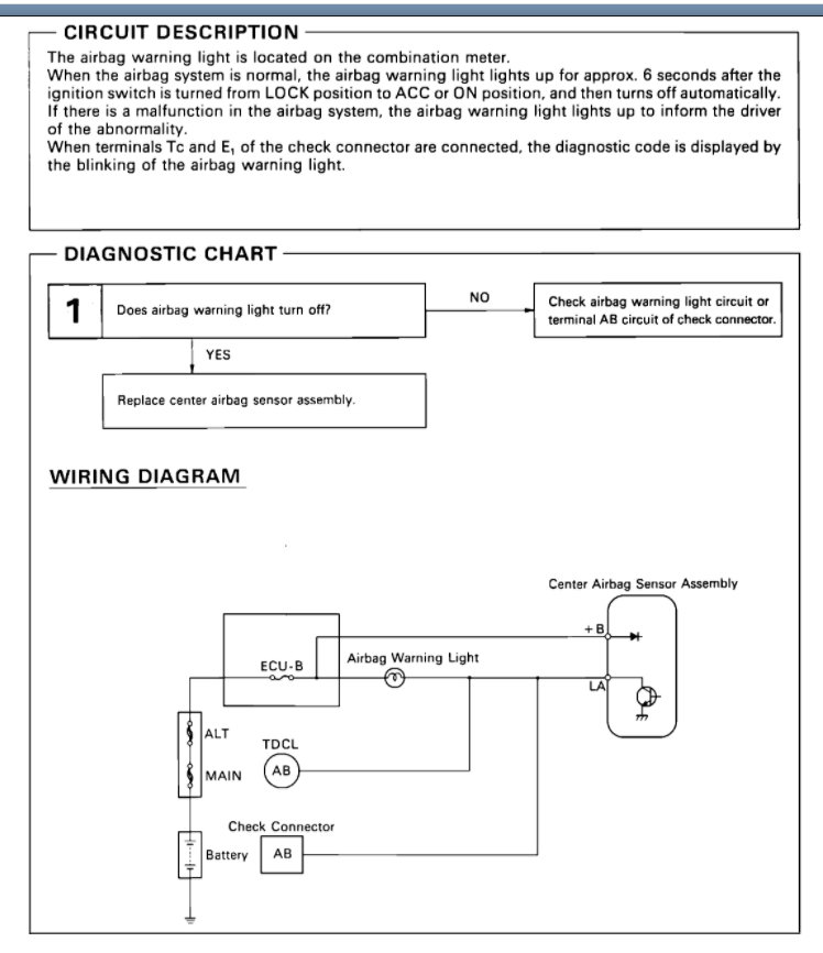

My airbag check light does not light up when I've turned my key to the utility position. I am trying to pass a provincial inspection and they are failing me on this. I took apart the dash and pulled out the module that houses the airbag light, tested the right bulb that should illuminate the airbag warning and it seems to work fine with a battery test.
I then read that I could possibly diagnose the issue by shorting out terminals on my diagnostic plug under the steering wheel. I did that (shorting terminals E1 and TC which should give me a code for airbag issues with the airbag light blinking in a certain pattern) and the light still did not illuminate. However the "cruise" light began to flash continuously, and according to the code (if the "cruise" light gives the same signals as the airbag light) that could mean either a problem with the battery or a problem with the center airbag sensor assembly.
Can I use this blinking cruise light as a diagnostic indicator for the airbag system? What other issues could this be? Is it safe to access the centre airbag sensor assembly?
Oct 7, 2014 at 2:51 AM
  • 55,381 POSTS

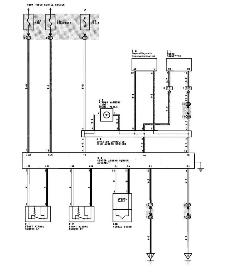

It sounds like you have a fuse out here is the airbag wiring diagrams which show the fuses you need to check to fix the problem. This guide will help with the diagrams below.

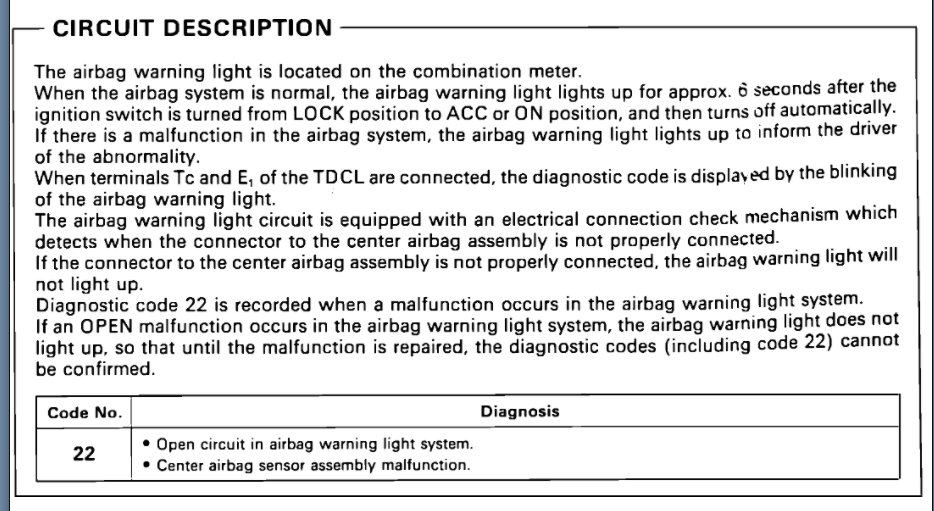

Hi everyone,
I have the LE model. It gave an issue regarding to my Airbag light in my dashboard ever since I changed the D transmission light bulb couple of days ago in my dashboard since it was burned out. Once I was finished my Airbag warning light turned on. I did a diagnostic flashing a 41 code. I read here to clear that code i need to go to the DLC 1 or DLC 2 putting two separate grounding wires in TC and AB then alternate back and forth grounding TC for ten seconds so my warning light could flash constantly. However, I am not sure which is a good source of grounding wire because I used two paperclips and small alligator clips that are negative and positive but it did not work. Can you guys provide me links for a good grounding wire or tell me a different way I can do this that is more simple to clear this error code in step by step?
By the way here is what I used in the picture to troubleshoot the error code.
Thank you so much.
Jan 7, 2021 at 10:26 AM (Merged)
KHLOW2008
  • 41,814 POSTS
I just replied to your question in another thread and since you have this, it should be much easier. Just use two pins or paper clips inserted into the desired position and clip on the wire leads, just make sure you do not get the two shorted to each other as it would interfere with the procedures.

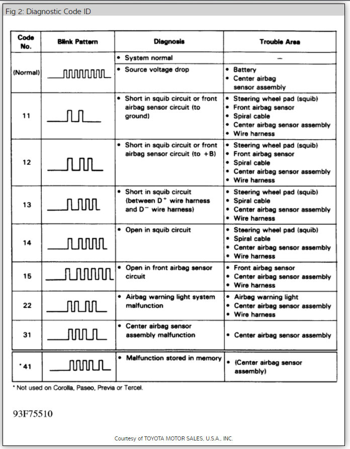

1992 Toyota Camry 6 cyl Front Wheel Drive Automatic

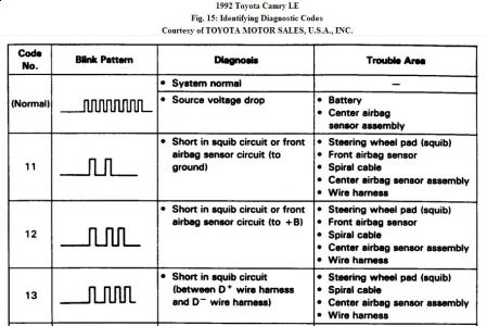

What does air bag code 13 mean. I ran the OBD test and this is the code I got.
Jan 7, 2021 at 10:27 AM (Merged)
IMPALASS
  • 3,112 POSTS
Hello –
I have provided the info you requested…………
Code 13 (Short In Squib Circuit Between D+ & D- , Part 1 Of 6). Camry – you need to have this check to ensure your airbag system is working properly.

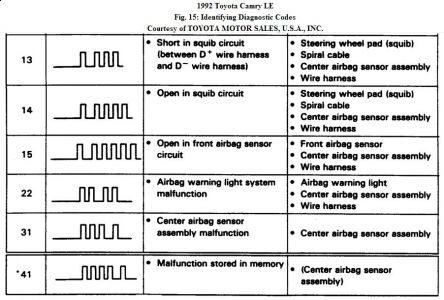

KHLOW2008
  • 41,814 POSTS
Hi Street Rat, When the airbag indicator lights stays on after more then 6 seconds when the ignition switch is turned, a malfunction code has been detected by the center air bag sensor assy. (IMAGES BELOW) You would need to retrieve the trouble code to find out what is causing the problem. AIR BAG RESTRAINT SYSTEM -1992 Toyota Camry LE Diagnostic Code Check 1. Jump together terminals Tc and E1 of Total Diagnostic Communication Link (TDCL) connector TDCL is located under left side of instrument panel near fuse block. 2. Read diagnostic codes by noting number of AIR BAG warning light flashes. Normal code indication will flash light twice per second. If a malfunction code is present, first number of code number will equal first digit of a 2-digit diagnostic code. After a 1.5-second pause, second number of code number will equal second digit.
https://images.2carpros.com/forum/automotive_pictures/192750_SRSDTC92Camryfig15_1.jpg
3. If 2 or more codes are present, a 2.5-second pause will occur between codes. After all codes are displayed, a 4-second pause will occur and codes will be repeated. After code has been identified, see appropriate diagnostic code and perform tests as specified. 4. If more than one malfunction code is present, codes will flash from smallest numbered code to highest. If malfunction code is not displayed or is continuously displayed, see TROUBLE SHOOTING. If AIR BAG warning light remains illuminated and diagnostic code is normal code, a source voltage drop is present. This malfunction is not stored in memory. If power source voltage returns to normal after approximately 10 seconds, AIR BAG warning light will automatically go out. See DIAGNOSTIC CODE NORMAL, SOURCE VOLTAGE DROP under TROUBLE SHOOTING. 5. Code 22 is recorded when a malfunction is present in air bag warning light system. If an open circuit is present in air bag warning light circuit, AIR BAG warning light will not glow. Diagnostic codes (including Code 22) cannot be confirmed until warning light circuit is repaired. 6. When a malfunction is present in SRS, malfunction Codes 11 through 31 are displayed. After repair of malfunction, Codes 11 through 31 can be cleared from memory but Code 41 will remain. A special procedure is required to clear a Code 41. NOTE: On all models when clearing all other codes except Code 41, use Clearing Malfunction Codes (Except Code 41) procedure. On all modes with Code 41 only, use Clearing Malfunction Code 41 procedure. Clearing Malfunction Codes (Except Code 41) Turn ignition switch to OFF position. Remove negative battery cable or ECU "B" fuse for at least 10 seconds to clear codes. When reconnecting battery, ensure ignition switch is in LOCK position. If battery is connected with ignition switch in ACC or ON position, diagnostic system may not operate correctly. Clearing Malfunction Code 41 1. Connect wire probes to check connector/TDCL terminals Tc and AB. See Fig. 13. Turn ignition switch to ACC or ON position and wait approximately 6 seconds. Starting with Tc terminal, apply body ground alternately to terminal Tc and terminal AB twice each, in cycles of .5-1.5 seconds. 2. When alternating probes between body ground, simultaneously release one probe from body ground while applying ground to other terminal. If time interval is too long, Code 41 will not clear. After several seconds, when AIR BAG warning light starts to blink a regular cycle, Code 41 cancellation is complete.

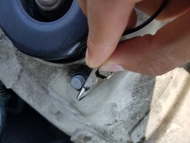

VLADSC50
  • 42 POSTS
Hi KHLOW2008,
I have the same issue and I'm having a hard time understanding wire probes to reset my error. Some also say 'grounding' or 'ground wire which I don't know what type of wire is that. I tried with paperclips and small jumper clips that are negative and positive but no luck. I already understanding the procedure but I think I'm missing the right equipment to do so. Can you provide my links so I have an idea what I need to buy to take this error code off my dashboard?

VLADSC50
  • 42 POSTS
Hi KHLOW2008,
Thank you so much for the response. I knew I was doing something wrong. Because what I was doing was using alligator clips connected on the end of the paperclips while doing the procedure. I had a feeling I should of done it with just the wires instead.
Several more questions if you don't mind. Which grounding wire do I use to attach with the paperclips? I looked online and found out it's copperwire. Is that true or there is other ground wire I can get? Do I also get electrical tape to attach the end of the grounding wire with the paperclips? That way I can reach bare metal for my ground?
Thank you so much.

KHLOW2008
  • 41,814 POSTS
You can use any wire. The wire set with clips you have now would be good enough. Clamp one end to a paper clip for plugging into the terminal and touch the other end to a grounding point.

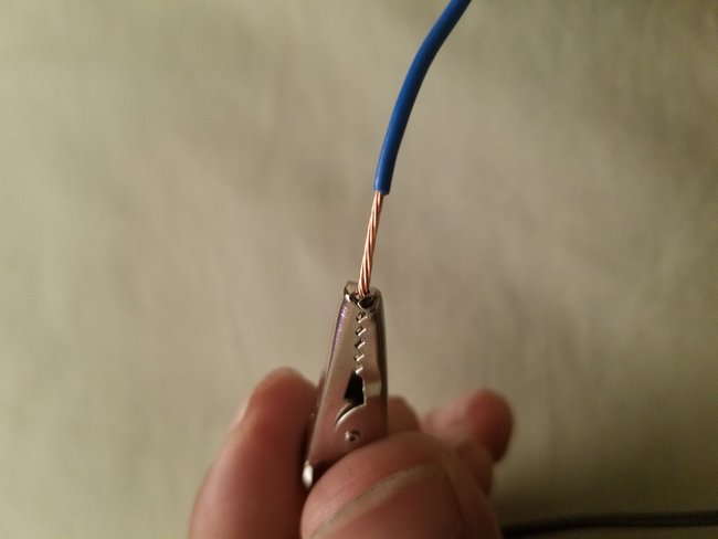

VLADSC50
  • 42 POSTS

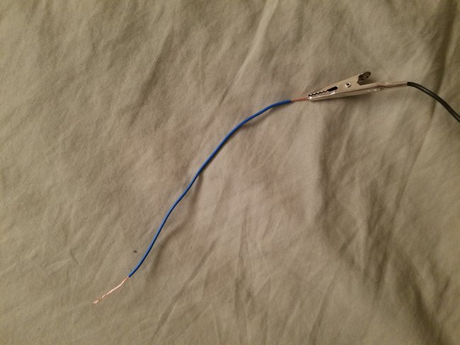

Update. I have successfully cleared the AIRBAG code! I did what you told me and it helped a lot. It took at least many tries to get the speed down which was a quick alternating between the terminals. Many said 0.2 seconds but I didn't think too much about it and just went quickly.
Here is my summary of what I did. I use the ground wire that was thin twisted copper that my father let me borrowed and used the alligator clips to clamp at the end of each wire and placed it in the DLC 1. I then used my ground near the DLC 1 that had three bolts around it and clean it off two bolts but only used one. Now the alternating between grounding the Tc and AB it was done through trial and error. I tried using the ground wire (thin twisted copper) itself, quickly clamping the ground with the alligator clips, different locations of ground, different speeds of alternating with the ground. None have worked, until I relaxed a bit and tried to do it as simple as possible. Which was touching the ground with the alligator clips without clamping since I figured it was mess up my quick timing. Then my father saw the code flash quickly. Once I took off the alligator clip from the ground, which was the Tc, the error code cleared up. I turned on my car twice to see if it stayed on but it didn't.
Thank you so much for your help and I gave my summary if anybody who had the same problem as me so they have an idea what they can do to clear the AIRBAG code. I will add photos in a bit so they have a clear visual what they need and will do.

VLADSC50
  • 42 POSTS
Thank you KHLOW2008 just to make sure is this the link to the online provider where you get your information?
http://www.eautorepair.net/marketing/default.asp?VID=&Count=Y
It says Mitchell DIY. I just want to make sure. Again thank you very much.

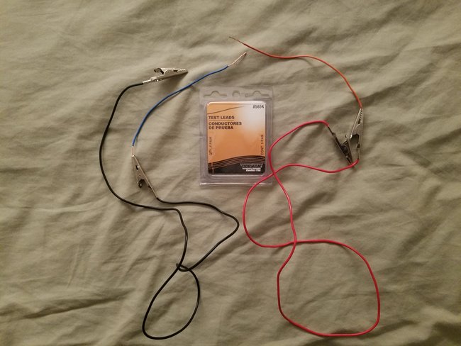

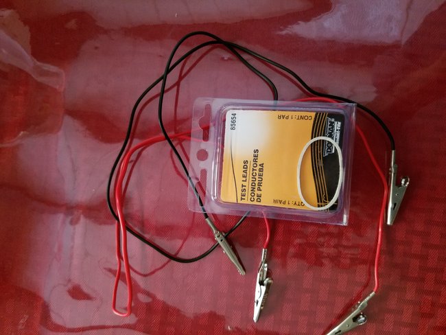

As for the photos here they are.
The first three photos is my set up. I got a pair of test leads from AutoZone and the ground wire, which is the thin twisted copper, clamp on one end of the ground wire in the nose of the alligator clips

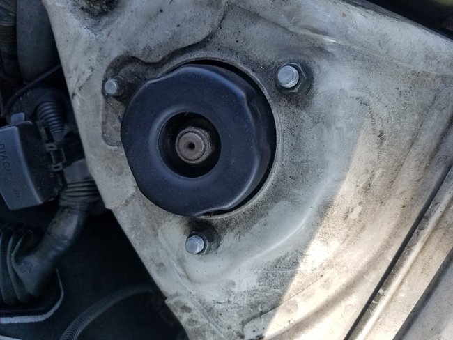

Now the fourth picture is the screws I used for my ground near the DLC 1 box. You'll notice the bottom two are clean which is important to do so to have better ground current. But I only used one to keep it simple. In this case I used the bottom left.
Finally the last picture is how I managed to clear the airbag code after a few trial and error methods. You simply just touch the screw with the alligator clip. I recommend to have a faster timing alternation is to prepare closely to the screw with your alligator clips NOT TOUCHING IT but being near it. This way after the six seconds mark, you have a faster timing alternation between the terminals to the ground since you'll use both of them to clear the code.
I hope this helps for anybody who has the same issue and I apologize for the quality of the pictures.

SZALKUSKT
  • 274 POSTS
Read codes and got a code 22 and changed the center airbag module under the console and cleared codes turned on key and now getting a code 14. i checked the clock spring with an ohmmeter and there is constant continuity even while turning the wheel. i do not think it is the clock spring, and i do not think the center airbag module is bad, but, because i am getting the code 14, open in squib circuit, i believe the actual airbag has a resistance problem or open. how can i check the resistance of the airbag itself and also what exactly should the resistance be? i have seen on the internet where if you put a resistor of proper value in place of a faulty airbag , the light will go out because the ecm now senses proper resistance. i need help troubleshooting the airbag on the steering wheel i think now.

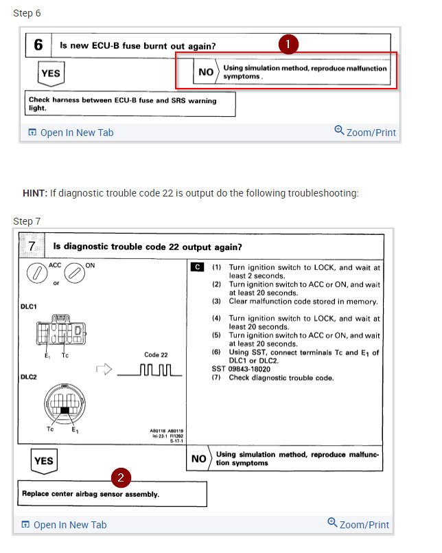

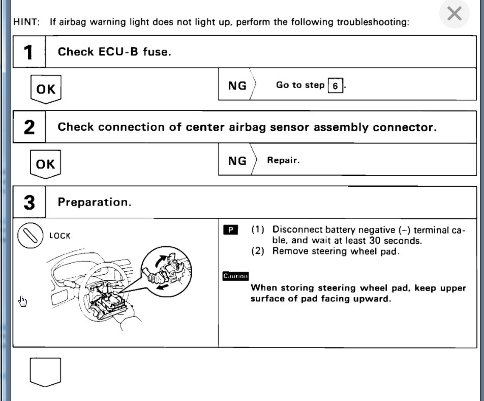

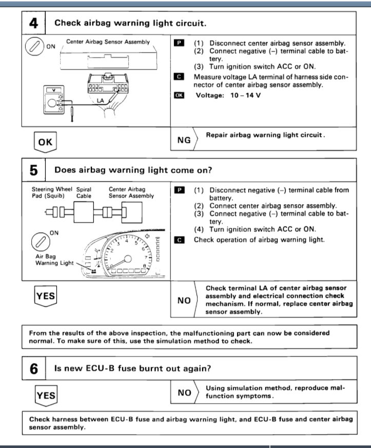

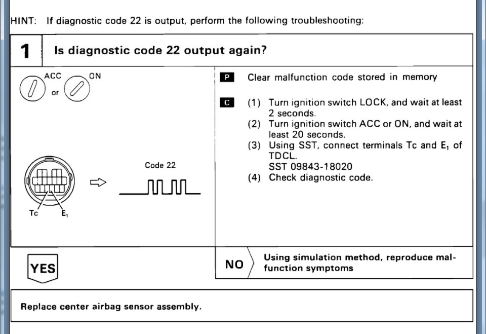

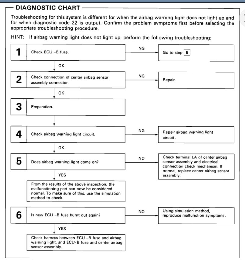

DENO2970
  • 19 POSTS
Hello Sir,
Need some direction on a issue with airbag light staying on. I retrieved a p-code 22 which is associated with the airbag indicator lamp circuit. When I removed the radio and the instrument cluster and reinstalled
everything is when the light would not go off. I checked the lamp again and its fine. Check for good connection as well. Do you have any resolutions or recommendations?
Jan 13, 2021 at 1:31 AM (Merged)
Two things. Did you have the battery disconnected with you were doing this? If so, you more then likely missed a connection and it is causing an open circuit. If not, you may have a shorted center airbag sensor.
Here is the testing that you need to run through to fry and find this issue. Let me know if you have questions. Thanks

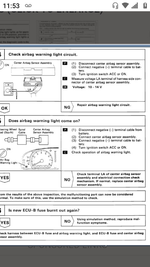

DENO2970
  • 19 POSTS
Yeah, unfortunately I did not disconnect the negative battery terminal. My fault. I will troubleshoot first. Appreciate this very much sir.
DENO2970
  • 19 POSTS
Kenny, I have no voltage at LA terminal of the Airbag Center Sensor assembly. I actually tested all of the exactly how the Diagnostic steps instructed.
Okay. We can figure that out but can you give me the exact info on your vehicle? Make, model, year, engine?
We just need to make sure that yours is the same as listed on this post.
Then I can get you the wiring info for your vehicle rather then possibly confusing things with just posting the wiring info on a different vehicle. Thanks
DENO2970
  • 19 POSTS
Kenny, my sincere apologies. I double and triple checked LA pin at the plug while disconnected from center airbag sensor assembly and I did get the 10-14 volts. Note: The Airbag Warning Light stays off when disconnected and comes back on when connected to the Sensor Assembly. I hope I'm understanding this correctly, on the voltage test. If it has correct voltage, is it asking if the warning light is on while disconnected from the Sensor Assembly?
Here is the vehicle info you requested:
VIN 4T1GK12E3SU111723
1995 Toyota Camry LE 4-DR Sedan AT,
3.0 L 2994 cc 1MZ-FE
Thank you Kenny.
okay . That is great. What this step is asking you to do is disconnect the battery. Connect the sensor back to the connector. Reconnect the battery and then turn the key on. Does the light come on? It may not stay on but when you turn the ignition on, the airbag light should do its self check where the light turns on and then off. If it stays on that is fine, it just means you have a code.
Sounds like your light does come on when it is connected. If it does then it is asking you to go to the next step and check the fuse and circuit as you may have a wiring issue.
Keep in mind it is important to follow the practice of taking the battery negative terminal off when connecting and disconnecting these connectors. If you don't and you get a quick short or spark the air bag can go off and that will injure you.
Just let me know if this is what is happening when you do this test and we can go from there. Thanks
DENO2970
  • 19 POSTS
Yeah, I've always disconnected the battery when plugging or unplugging these type connections.
So how do I proceed? I got voltage, airbag warning light stays lit still, ECU fuse is good, still get code 22.
So do I need to jump to the step where I disconnect the steering wheel airbag spuib connection, right?
Yes. Take a look at the attachment. I show you are here where it is saying you need to clear the code, wait the proper amount of time and then check it again. If it comes back you need to replace the assembly.

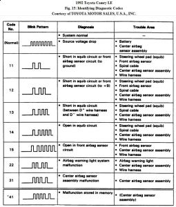

KHLOW2008
  • 41,814 POSTS

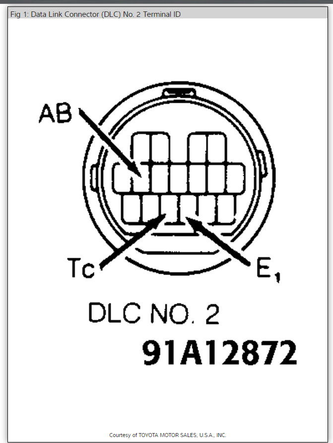

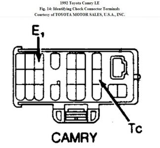

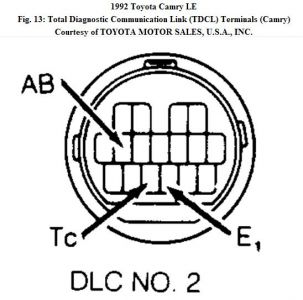

Hi COMERCIALAUTOSERVICE, Thank you for the donation. When the ABS indicator is showing, it could be any fault with the sensors and you would have to go into the self diagnostic mode to retrieve the trouble code. Here are the procedures and there are 2 different types of DLC so you need to check which is the correct one. Diagnostic Code Check 1. Jump together terminals Tc and E1 of Total Diagnostic Communication Link (TDCL) connector using a jumper harness.
https://images.2carpros.com/forum/automotive_pictures/192750_TDCLTerminals92CamryFig13_1.jpg
TDCL is located under left side of instrument panel near fuse block. On alternate models, jump underhood check connector terminals Tc and E1
https://images.2carpros.com/forum/automotive_pictures/192750_TDCLTerminals92CamryFig14_1.jpg
https://images.2carpros.com/forum/automotive_pictures/192750_TDCLTerminals92CamryFig15a_1.jpg
https://images.2carpros.com/forum/automotive_pictures/192750_TDCLTerminals92CamryFig15b_1.jpg
Normal code indication will flash light twice per second. If a malfunction code is present, first number of code number will equal first digit of a 2-digit diagnostic code. After a 1.5-second pause, second number of code number will equal second digit. 3. If 2 or more codes are present, a 2.5-second pause will occur between codes. After all codes are displayed, a 4-second pause will occur and codes will be repeated. After code has been identified, see appropriate diagnostic code and perform tests as specified. 4. If more than one malfunction code is present, codes will flash from smallest numbered code to highest. If malfunction code is not displayed or is continuously displayed, go to TROUBLE SHOOTING. If AIR BAG warning light remains illuminated and diagnostic code is normal code, a source voltage drop is present. This malfunction is not stored in memory. If power source voltage returns to normal after approximately 10 seconds, AIR BAG warning light will automatically go out. 5. Code 22 is recorded when a malfunction is present in air bag warning light system. If an open circuit is present in air bag warning light circuit, AIR BAG warning light will not glow. Diagnostic codes (including Code 22) cannot be confirmed until warning light circuit is repaired. 6. When a malfunction is present in SRS, malfunction Codes 11 through 31 are displayed. After repair of malfunction, Codes 11 through 31 can be cleared from memory but Code 41 will remain. A special procedure is required to clear a Code 41. NOTE: On all models when clearing all other codes except Code 41, use Clearing Malfunction Codes (Except Code 41) procedure. On all modes with Code 41 only, use Clearing Malfunction Code 41 procedure. Clearing Malfunction Codes (Except Code 41) Turn ignition switch to OFF position. Remove negative battery cable or ECU "B" fuse for at least 10 seconds to clear codes. When reconnecting battery, ensure ignition switch is in LOCK position. If battery is connected with ignition switch in ACC or ON position, diagnostic system may not operate correctly. Clearing Malfunction Code 41 1. Connect wire probes to check connector/TDCL terminals Tc and AB. See Fig. 13 or Fig. 14 . Turn ignition switch to ACC or ON position and wait approximately 6 seconds. Starting with Tc terminal, apply body ground alternately to terminal Tc and terminal AB twice each, in cycles of .5-1.5 seconds. 2. When alternating probes between body ground, simultaneously release one probe from body ground while applying ground to other terminal. If time interval is too long, Code 41 will not clear. After several seconds, when AIR BAG warning light starts to blink a regular cycle, Code 41 cancellation is complete.
