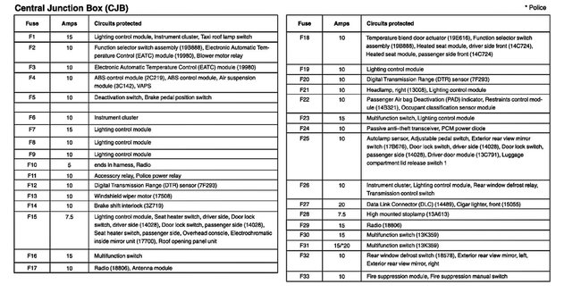

My airbag light stays on, no flashing or chimes, fuse is good. Took it to two shops, neither scanner could communicate with module. Suggested that I take it to dealership, possible faulty module. Any ideas?

If you are 100% that the fuse is good and you have power in and out, you need to be sure of this first.
Fuses 22 and 26 in the under dash fuse box are for the airbag control. Both 10 amp.
I would suggest after you are happy the fuses are good that you need to check the power and ground at the restraints control module. The control unit is underneath the center console.
You have to be very careful when testing the restraints system, you need to power down the system and you cannot unplug/plug the module without having it bolted down first.
You will need to do this before replacing the module.
Do you have access to a multi-meter?
Regards, Joe

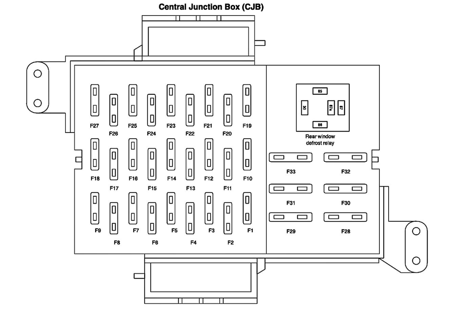

Hey 15thPanzer,
Fuse locations and fuse board layout below.
both fuses should be powered (have 12 volts both sides) with the ignition on.
Regards, Joe
