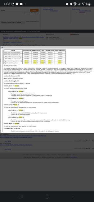

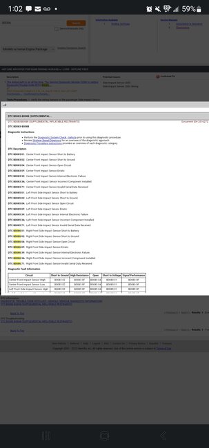

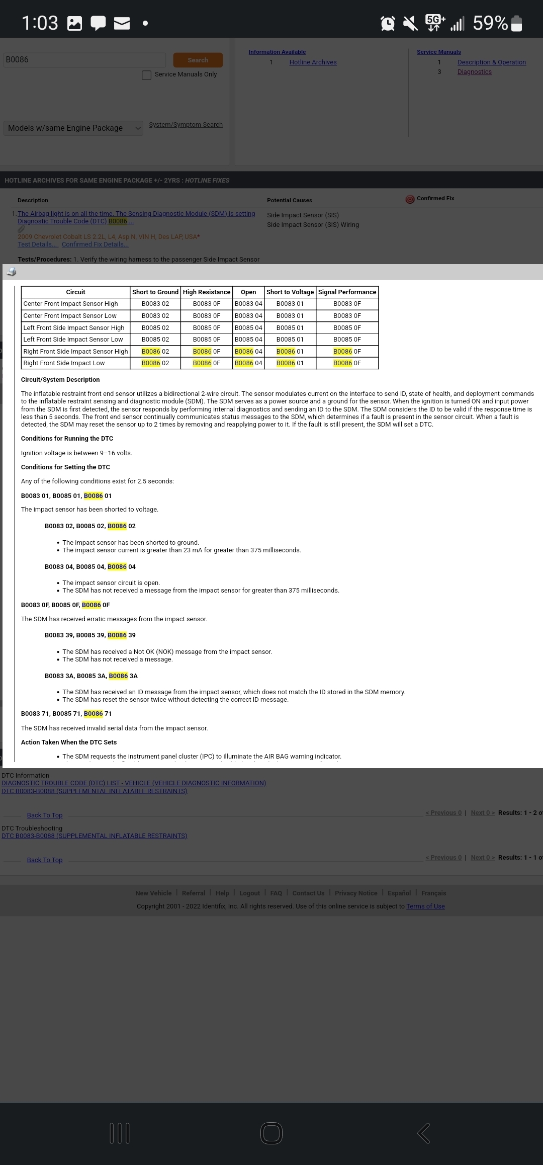

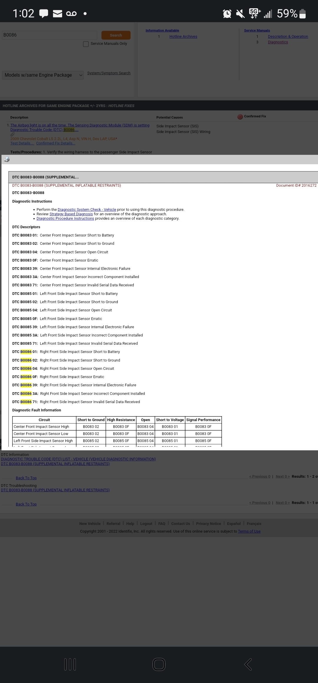

B0085_71 and b0086_71 I posted a pic of the codes, but I don’t see it on here. so here they are.

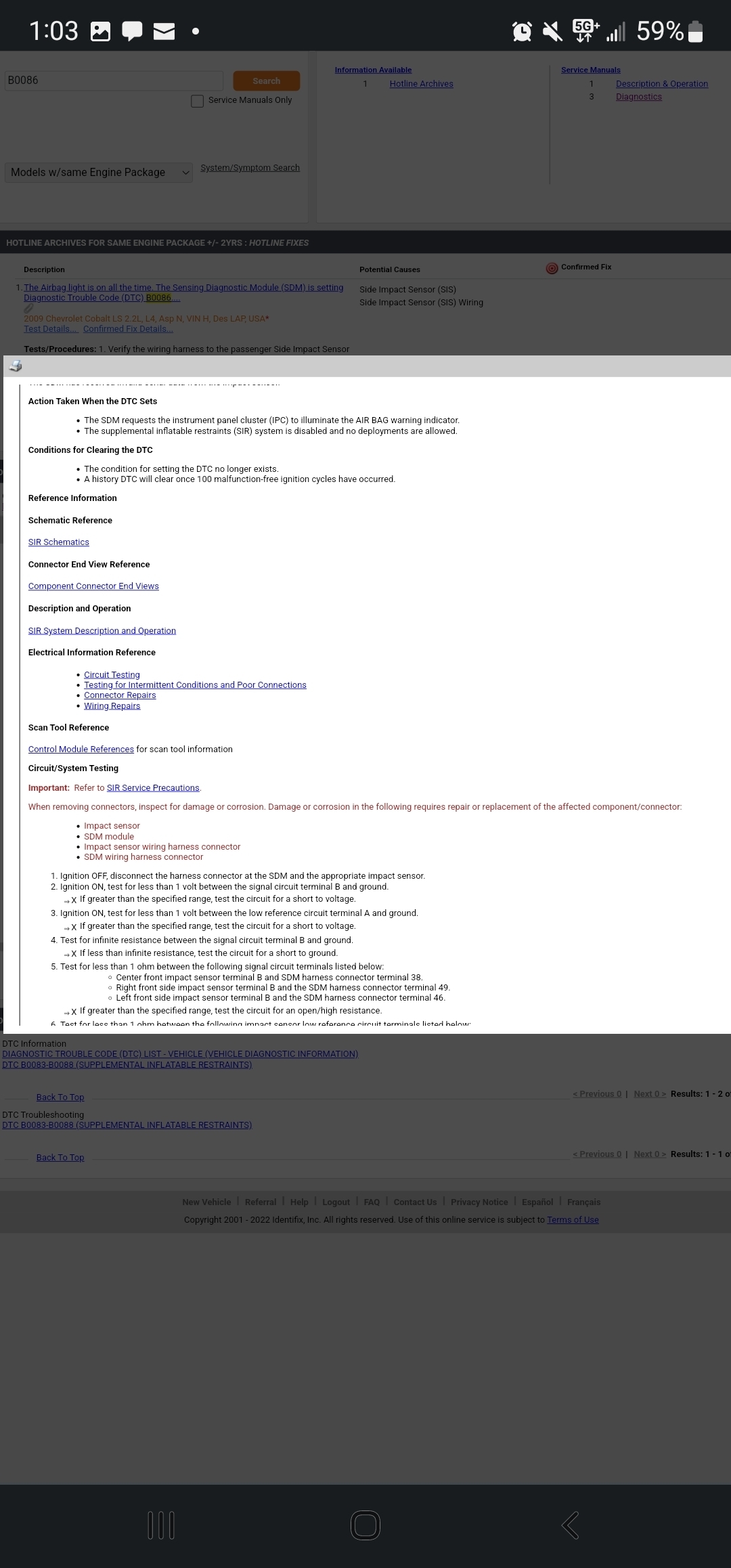

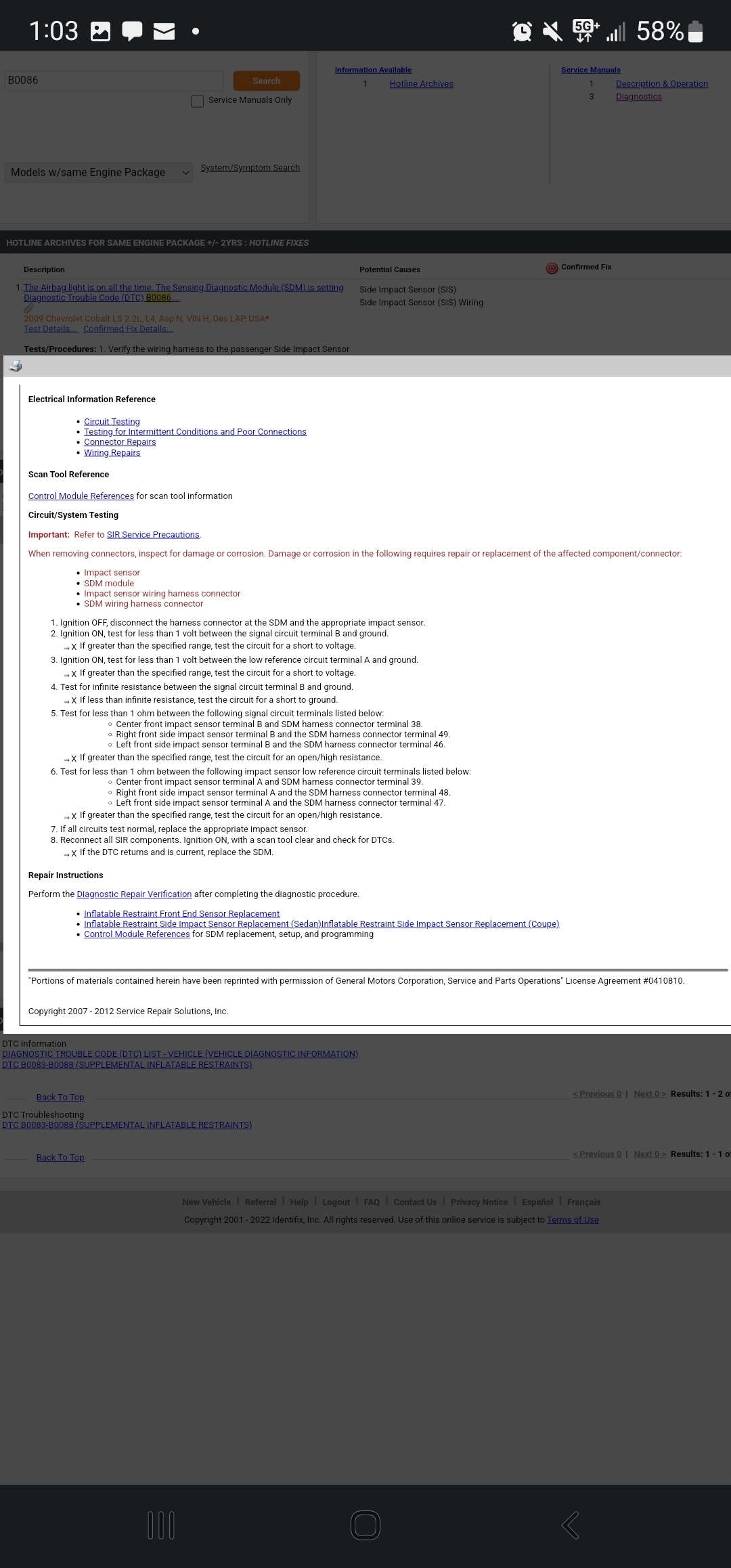

I posted the trouble tree for you but have you actually taken the inside door panel off and made sure those sensors are plugged in and wires/connectors are good to them? Thoses codes aren't for a programming error it's just saying the computer isn't seeing what it's supposed to see with the sensors plugged in.

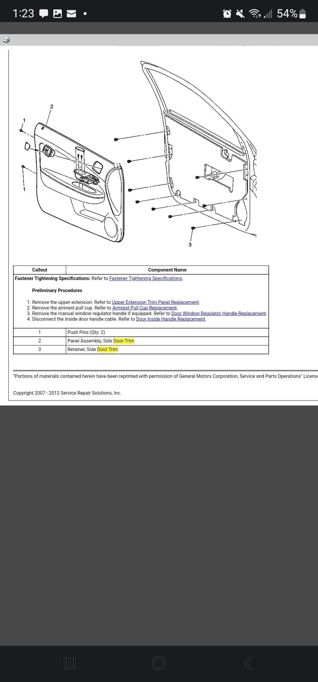

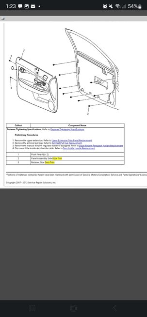

Here are the instructions for inner door panel removal.

The sensors aren't like that the computer just expects to see a set value feedback from the sensor.I would say most likely the sensor isn't plugged in the wires are damaged or maybe it's the wrong sensor and or not plugged in.

Solved it took doors apart the doors are off a 2006 and the car is a2008 the sensors are different got cheap China sensors for the year of the car had to cut off part of the plug because the 2008 sensor doesn’t fit the 2006 plug but a razor knife took off the part that is different so the right sensor would plug in and the air bag warnings shut them self-off.
