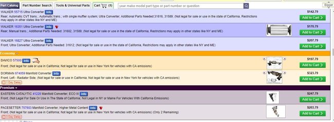

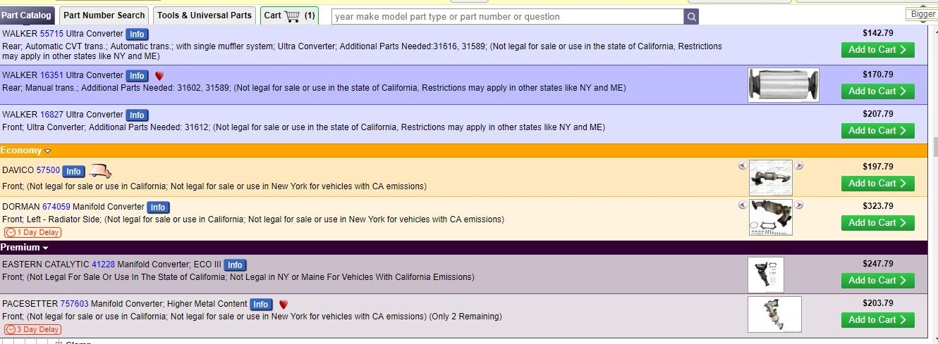

Hello, I just went to an auto shop for the code read and the only thing that showed up was the check engine light and it’s a code P0420. They said I need to replace catalytic converter, but it’s cost about $400.00 for the part alone. so is there anything I can do because I’m not trying to pay that much. Also, what should I do about the airbag light that’s on? Do you know how I would get charged to reset the airbag light?
Jul 9, 2019 at 8:32 AM
  • CAR REPAIR CONTRIBUTOR
They needed to access the airbag system for the code. They should have been able to read that.
As far as the catalytic converter, yes, you need one. I attached the part for you from Rock Auto. They run around $220.00 for the part and one hour for the labor.
Jul 9, 2019 at 8:42 AM

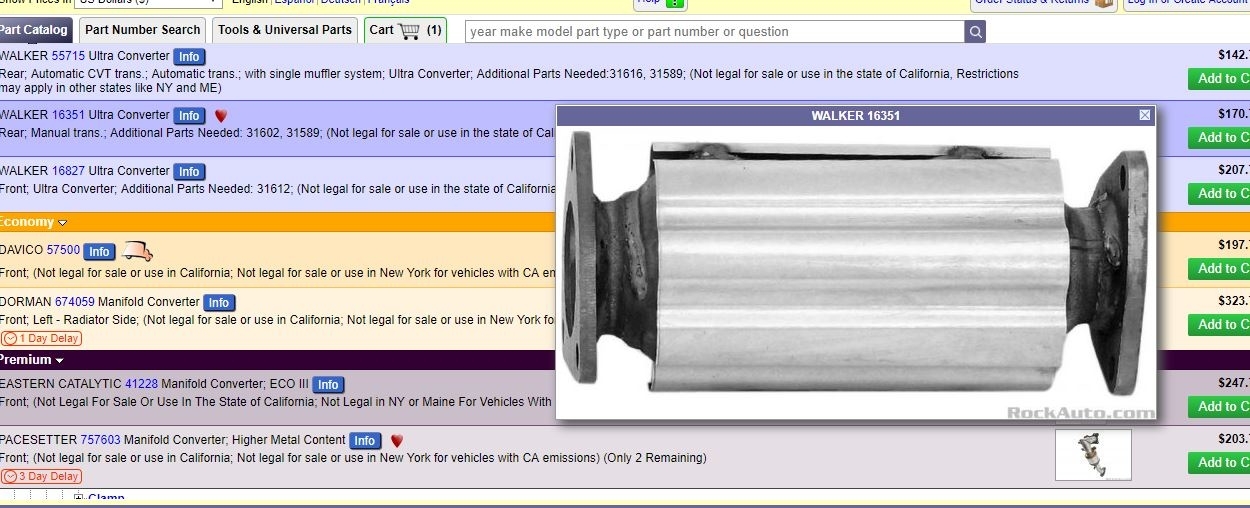

Thank you. is there a link to see catalytic converter for my car? The guy at AutoZone offered me to try a product called Cataclean for the code P0420 to see if it fixes the problem. any idea if this is a good product?
Jul 9, 2019 at 8:49 AM
No, that junk never works at all.
I attached an actual picture of the catalytic converter for you.
