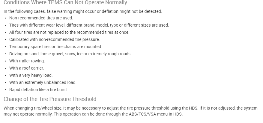

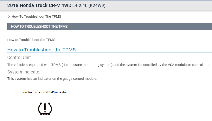

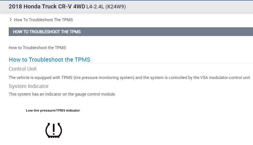

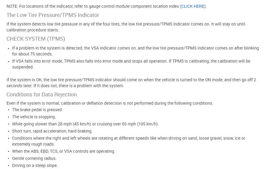

I am so sorry. Ugh!!! A bit embarrassed on my end. You are correct. Most all vehicles use a sensor in the wheel. This one doesn't.
I attached troubleshooting information below for this system. Take a look through them and let me know if you are comfortable performing them.
